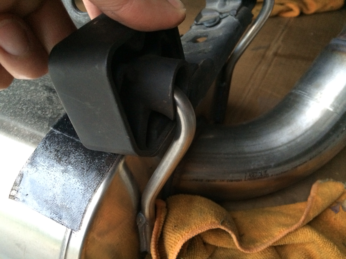

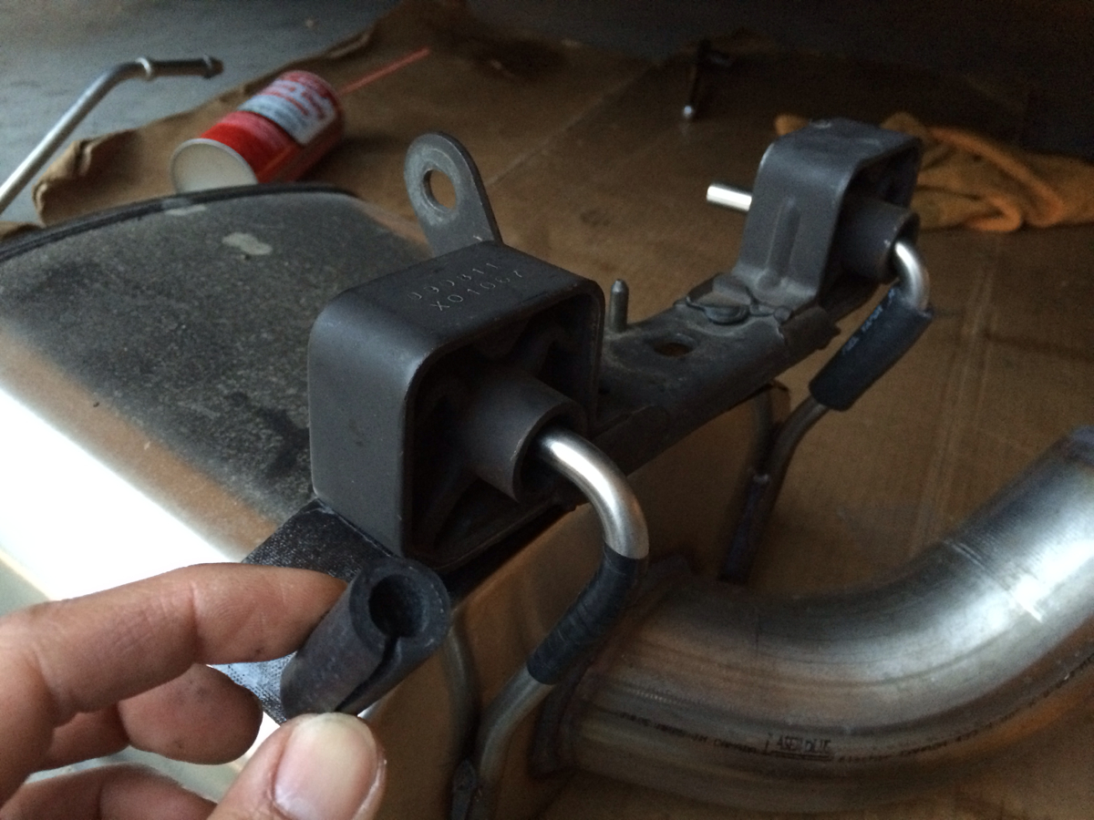

Marilyn is fully aligned. Have to update my steeda Koni thread with install info.
Also, I figured out the source of my squeak. Stupid exhaust hanger was rubbing on actual metal piece on the corsa. Took me a while to find. To fix, instead of grinding out the hanger, I cut some spare rubber tubing I had from my magnuson install, then wrapped that over the metal. Voila. No more squeak. I need to reinstall my poor innocent sway bar lol
Here's pics of the culprit.

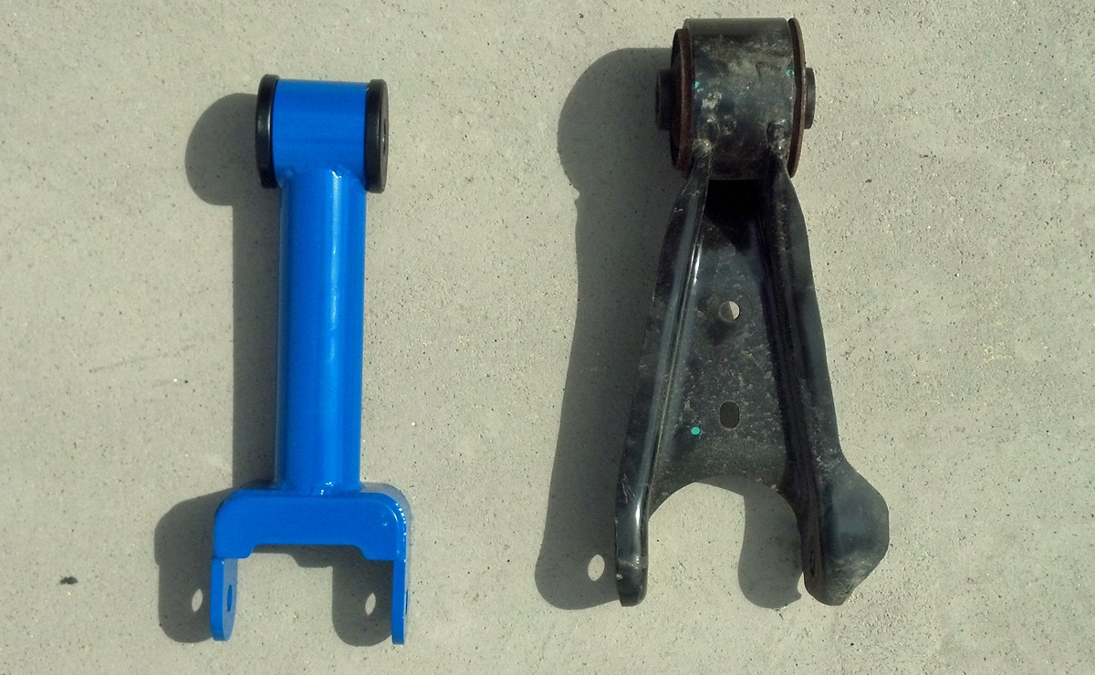

Not today, but yesterday I got the new Steeda Upper Control Arm (#555-4098, "for lowered vehicles") installed.
Before I installed it I stuffed some foam into the tube to try to minimize any sound transmittal from the rear axle into the cabin. This was a failed experiment as there is definitely more noise coming into the cabin now at highway speeds.
But the increased traction and firmer feel from the rear is a good trade-off.

The new and the flimsy stock part:
