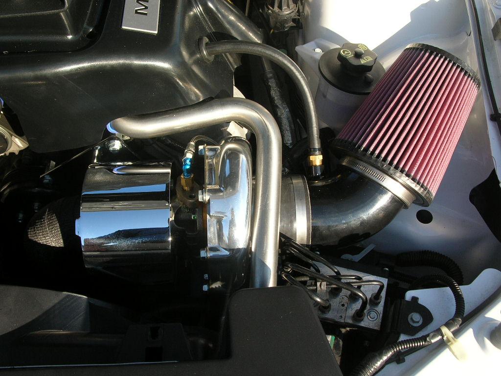

Neither one of my cam covers go to the intake. Both are just open vents with little filters on the end (which are both covered by the Shaker engine cover). The passenger side filter was turning colors from oil, so I put an inline PCV before the filter. That way it can vent like it needs to, but is unable to blow out oil.
Both places where they used to go on the intake are capped.
The only reason these go to the intake in the first place is for emissions. So, unless you are a tree-hugger, it doesn't matter. And, if any of us were tree-huggers, we wouldn't be driving such high carbon-monoxide polluting vehicles in the first place.

Based on what I said above, why even hook the cam covers to the intake? There's no point... it doesn't do anything. Put them to open air and let them breath like on the old cars. Then you never have to worry about getting oil into the intake or, worse, into the mass air meter. Then, if needed, use an inline PCV to eliminate blow-by.
In this picture, the hose running to the intake is fake. It's just for looks. It has a bolt in the end of the tube behind the Shaker cover. This is supposed to run over to the passenger side cam cover, which now has an inline PCV and filter:
+1 on the COP's... that's what I was told... only over 12psi.

I would think the problem with putting them to open air, is that what ever can get out can probably also get in. If you put a filter on there, then yes you'd be covered. Old cars have a tiny filter, that would work.

I added a pic above after you posted.
Yes, I got two K&N-type filters at Auto Zone that go over the stock tubes that come out of the cam covers. I think each filter was around $8. Works perfectly.
