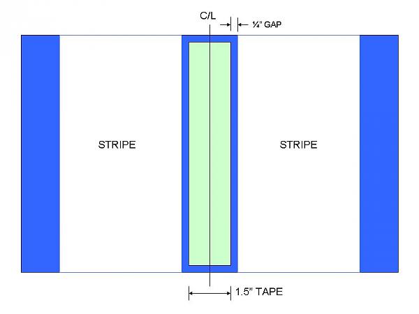

Bill in the instructions it says you only have to place a strip of masking tape at the beginning and end of the areas and align the stripes to them, BUT I think I will mask the center line the entire length of the car. I think this will allow for a much more accurate layout.
Sounds good to me on laying down the masking tape the entire length. That way you can see any deviation on that 1/4" gap.
Why would I mark the centerline of the masking tape ?
To ensure that the 1 1/2" masking tape is centered (see pic).
If the masking tape is centered, I don't see a need for marking the center of it. (Explain please ) Unless you mean BEFORE I place it on the car.
Yes, before. It's to ensure the C/L matches the center of the tape. Guess you can always double check by measuring the outer edge of the tape to the outer edge of the hood, roof, etc.

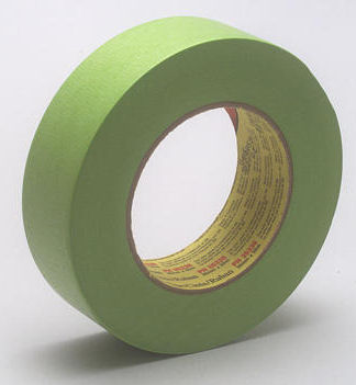

Don't cuss at me Remember what I do ?? We sell it. Green masking tape is great for auto body.
3M Scotch® Performance Masking Tape
Attachment 1459
Ha! Who knew?
Looks like it sticks pretty good. I'm assuming it has a stronger adhesion compared to the blue painters tape?

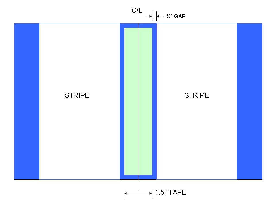

Daryl- Does marking the center of the green tape make any sense (like my attached pic a few posts up)? Or, do you have an alternate way of locating the tape center?
Old Jun 2, 2006 | 01:57 PM
  #950
OKCMustangGT's Avatar
Joined: January 17, 2006
Posts: 2,061
From: Tornado Alley
Yea it makes perfect sense now. At first I was like WTF ? LOL

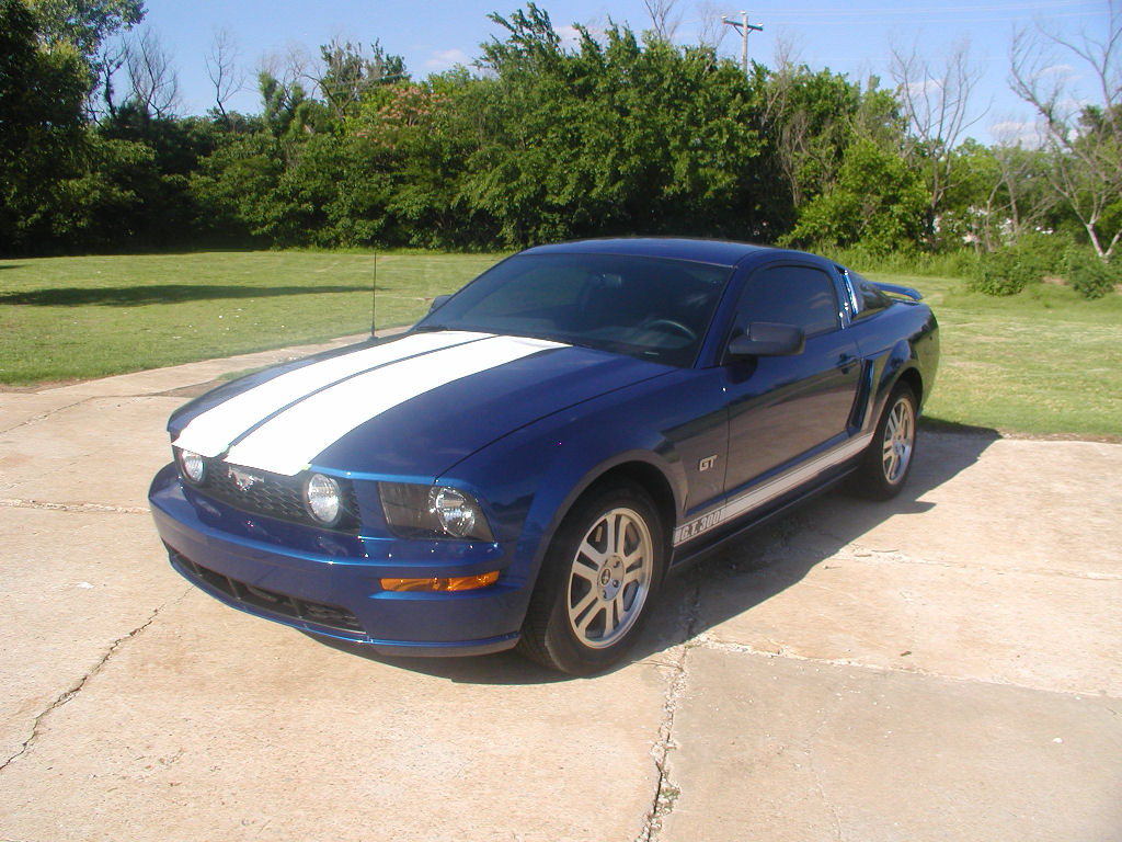

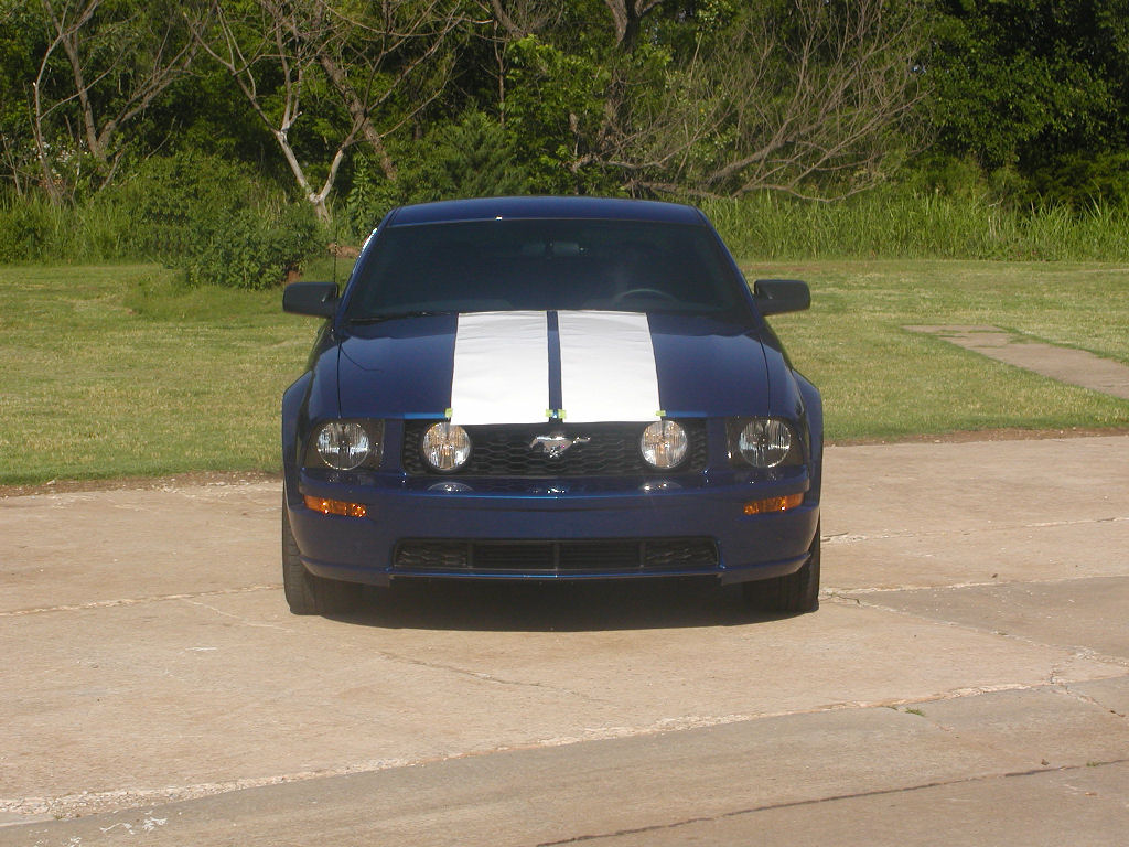

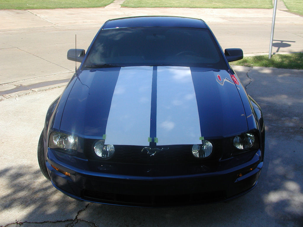

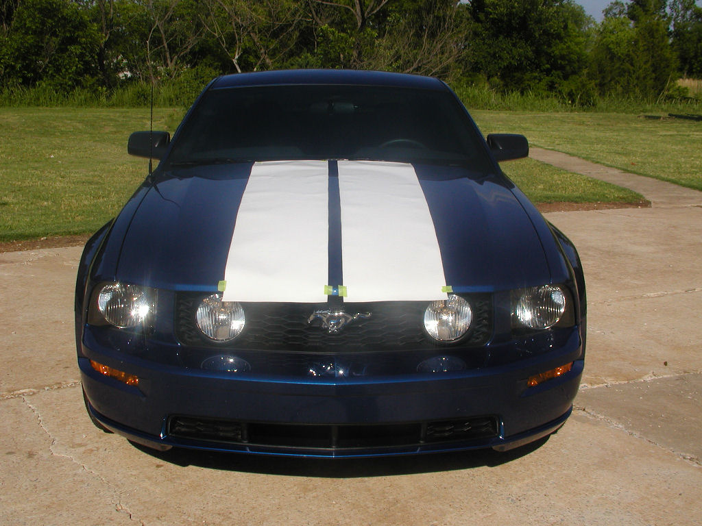

Just for you Bill. Good thing these aren't for real, cause my eyeballing sucked.
Attachment 1462Attachment 1463Attachment 1464Attachment 1465Attachment 1466
My opionion, as biased as it is, says these are gonna ROCK
