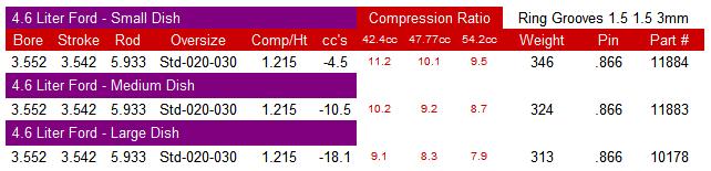

Can anyone tell us 'pre-forged' guys what the recommended compression ratio us FI guys should be running?
Probe Forged Pistons (probably the same as other manufacturers)

from past experience I would think that you'll want either the 9:1 or the 10.2:1. The 11 is too steep for street use unless you use race gas. On top of that being blown you typically want the lower compression ratio, too high and you'll never stop it from detonating.
If it were me, unless I didn't have a choice, I'd go with the 9:1. I'd never heard of Probe before as a piston Mfg... JE, Arias, Venolia, Ross, Mahle, TRW.. ??

Checked out Probe. Seems pretty good. If you're gonna do it get the 5.1L kit

I don't think I'd go any higher than 9.5. 9.0 or even slightly less would probably be good. Remember you don't need compression from the pistons when you're dumping 10+psi into the cylinder.

comp. ratio around 9 should be close, but I'd see about calling someone at ford, or saleen, etc that would know for sure

Looking at Livernois, they offer 2 compression ratios for different applications;
Centri S/C: 12cc 9.7:1
Roots/Turbo: 17cc 9.1:1
I e-mailed Rick @ Livernois to get a better understanding of what compression ratio he recommends for my non-cooled Vortech setup. I'll post back when he replies.
