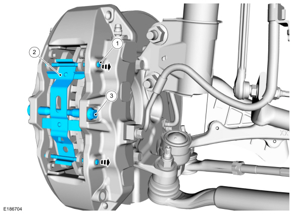

    1. Remove the 2 brake pad pins.
    1. Remove the brake pad spring retainer clip.
    1. Remove the brake caliper pin bolt.
      Torque: 22 lb.ft (30 Nm)

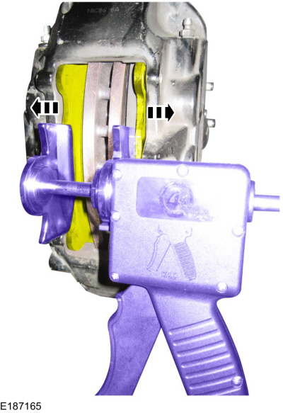

  1. Compress the brake caliper pistons using a brake pad spreader tool.

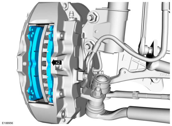

  1. Remove the brake pads.
