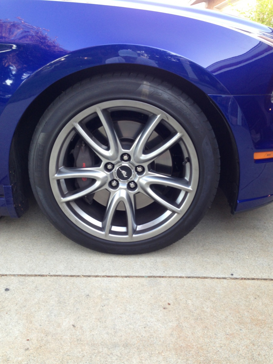

Threw on some Ford racing K springs yesterday. Not as low as I'd like but nonetheless better than before!
Looks nice! Remember that the springs are still settling.

Looks really good. How much drop did you get? Looks like maybe 1.25 to 1.5 inches?
Thanks! the drop is 1.5" all around. Their K springs are 1.5". I believe they have others with less of a drop. I wanted more but didn't want to need camber plates and such. Ill install some struts when these fail. Also threw in an adjustable pan hard bar. The install was a breeze on the '13! Air tools definitely make a world of difference
Air tools are definitely your friend! I was wondering if the ride of the car changed. Did it soften up or become more harsh? Does the rear end of the car still move around under load in a corner on uneven pavement?
Many reviews online spoke about a super stiff ride and I assume they have regular stangs not Brembo or track pack ones. I have the track pack so it was already stiffer than a regular GT. My 12 was a much softer ride. These new springs are a bit stiffer but not bone jarring, then again the roads here are well kept. I notice when I make sharp turns there is no body roll and when I slam it in first, there is no longer any wheel hop. It's a great feeling. Corners are very tight and the lower cog really comes through along with the stiffer rates. There is still some nose dive under heavy braking but its not as bad as before. I'm very happy with then. Hopefully I can take her out to the track soon and really put it through its paces.
