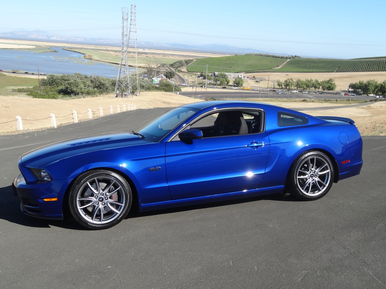

Originally Posted by mrc728
Sorry finger hit the send button lol... Mainly for appearance and to keep ride quality, not for track or drag strip. So with that said what do I need? Springs (obviously), adjustable pan head bar? Camber bolts, plates?..... Thanks for any help
Steeda Sport springs will do a nice job of getting a VERY nice look compared to the 4x4 look of the stock springs.
Shocks/struts, I went with the Koni SPort adjustable units, but I probably could've gone with the non-adjustable SRT.T models and been the same, since I keep mine pretty soft, which is very close to stock.
As far as alignment, I just had mine done and the toe/caster settings were put right back into spec while the camber sits at only .1 out of spec, not suing any adjustable camber plates.
I'm using the GT500 strut mounts.
So, the set-up I'd recommend would be Steeda Sport springs, Koni STR.T shocks/struts, and GT500 mounts.
My car's current stance:

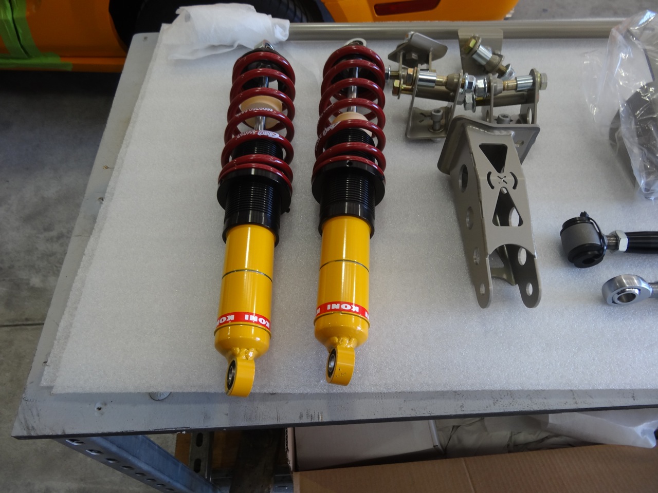

You'll be much happier pairing up those new springs with some new struts/shocks, as the others have said.
My stang's suspension includes Koni Yellows (2011+), Steeda Sport Springs, Steeda HD Strut Mounts (2011+), Steeda Adj Rear Swaybar, BBR Billet LCAs, Steeda Adj UCA & Mount,FRPP LCA Relocation Brackets and J&M Adj Panhard Bar. I'm extremely satisfied with the look and handling of my stang and would highly recommend the same setup for anyone looking to do some occasional serious driving. Below are a few photos.
My stang's suspension includes Koni Yellows (2011+), Steeda Sport Springs, Steeda HD Strut Mounts (2011+), Steeda Adj Rear Swaybar, BBR Billet LCAs, Steeda[COLOR=black] Adj UCA & Mount,FRPP LCA Relocation Brackets and J&M Adj Panhard Bar. I'm extremely satisfied with the look and handling of my stang and would highly recommend the same setup for anyone looking to do some occasional serious driving. Below are a few photos.[/COLOR
Your Boss looks sweet!
I dropped mine from 6.5 inches in the rear to 4.3 inches….thats from to ground. The front from 6.3 down to 4 inches. Koni coilovers rear wit 225 lbs springs. Front are Koni inserts with 450 lbs springs.
