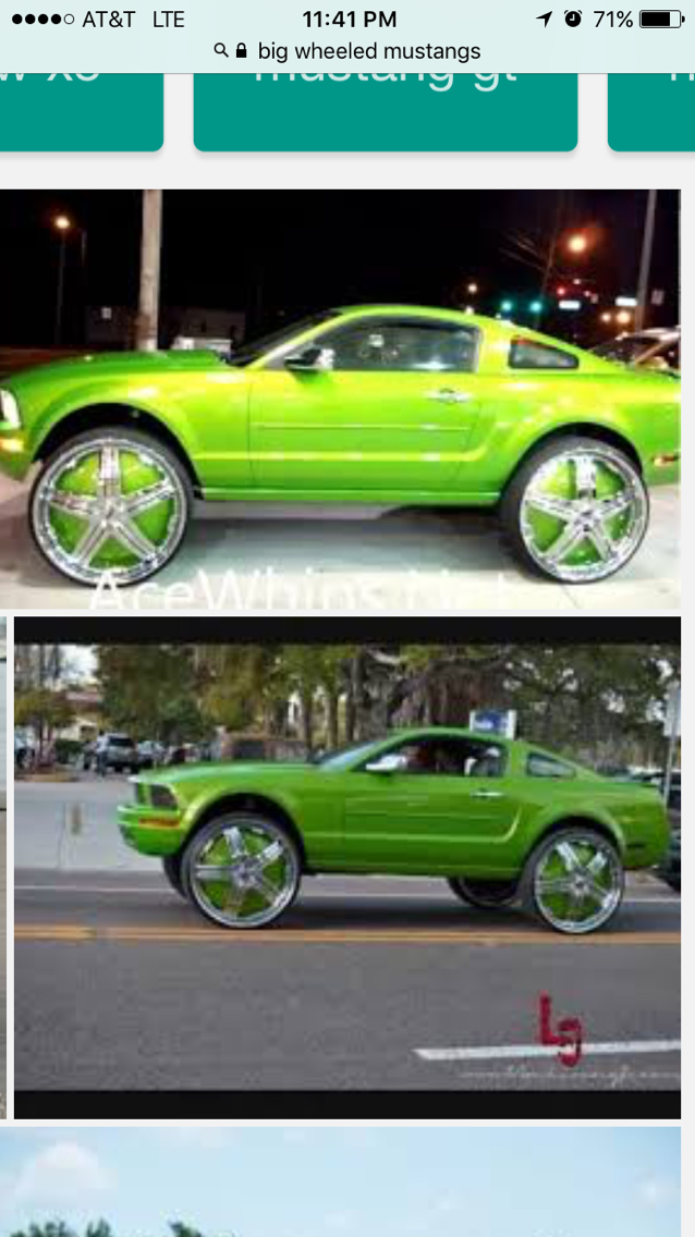

I was gonna say 35's are probably a little too big

That looks like a cartoon car!

These are too big... Attachment 182591
That is funny they managed to transfer the wheel gap from the back to the front.
