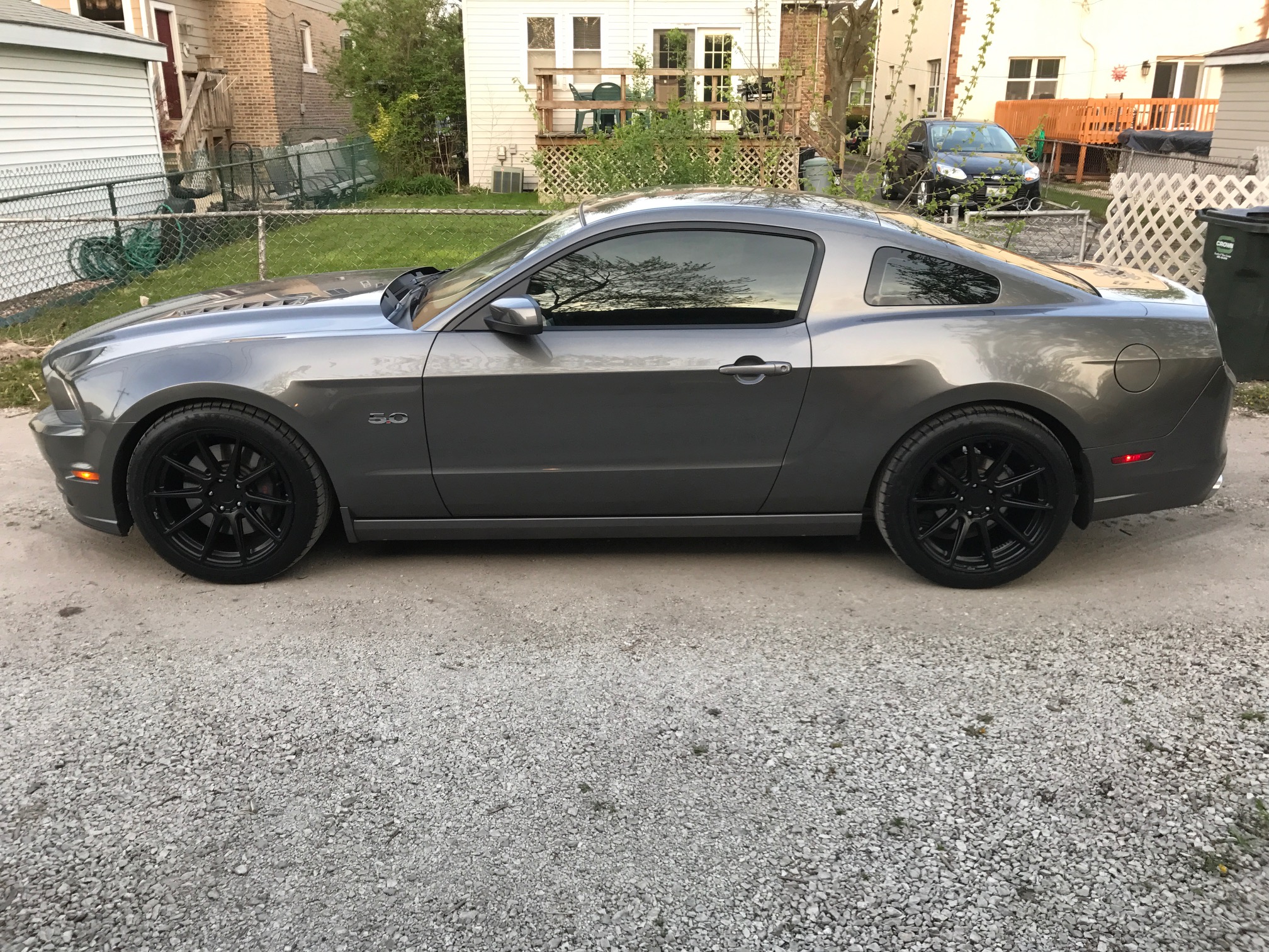

In conclusion...
19x10 rims w/ 40mm offset. 275/40 tires
Hardest things were finding a wheel to fit the Brembos and finding a tire shop. Although confident, tire shop guys don't always know what they're talking about.
