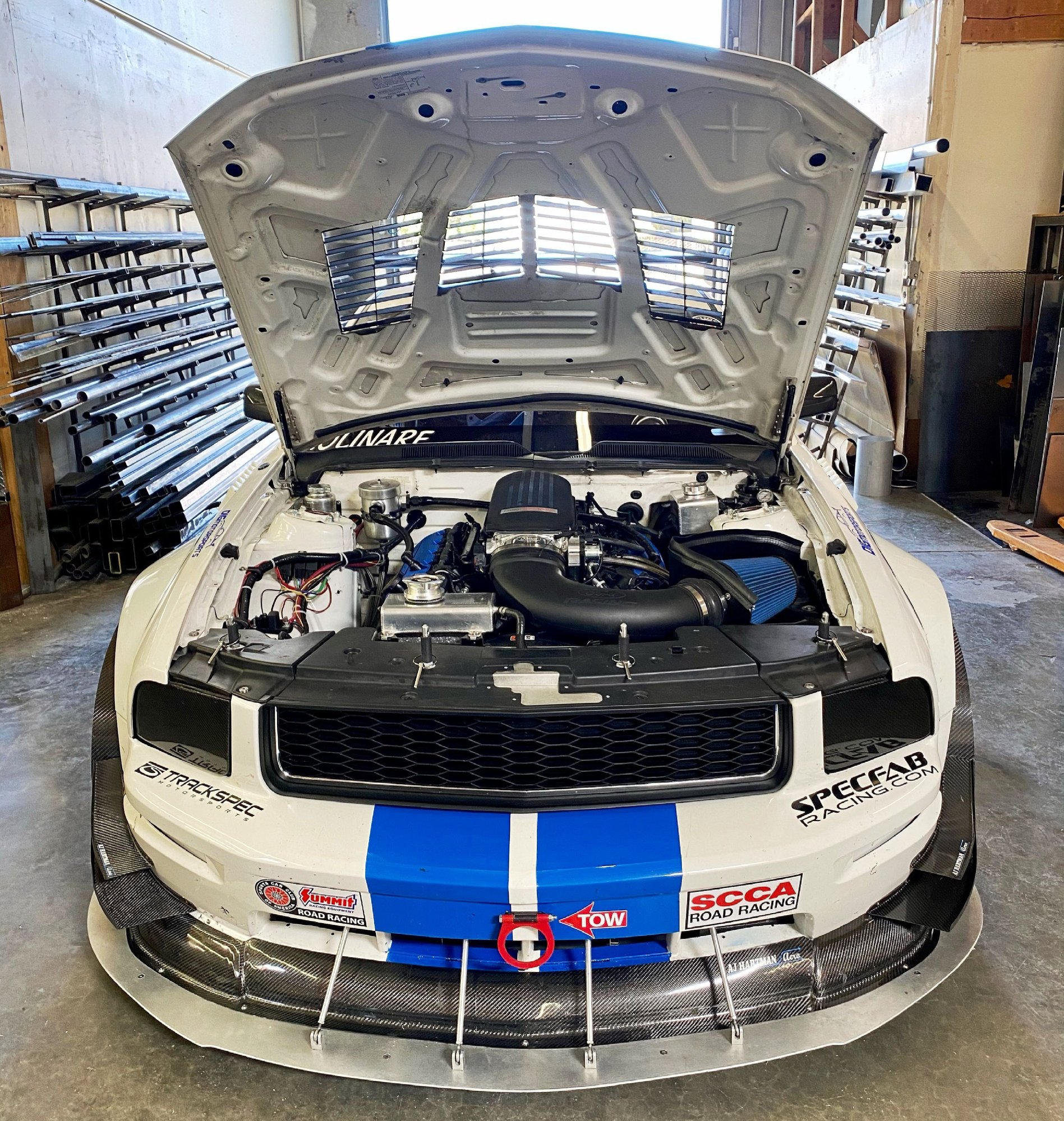

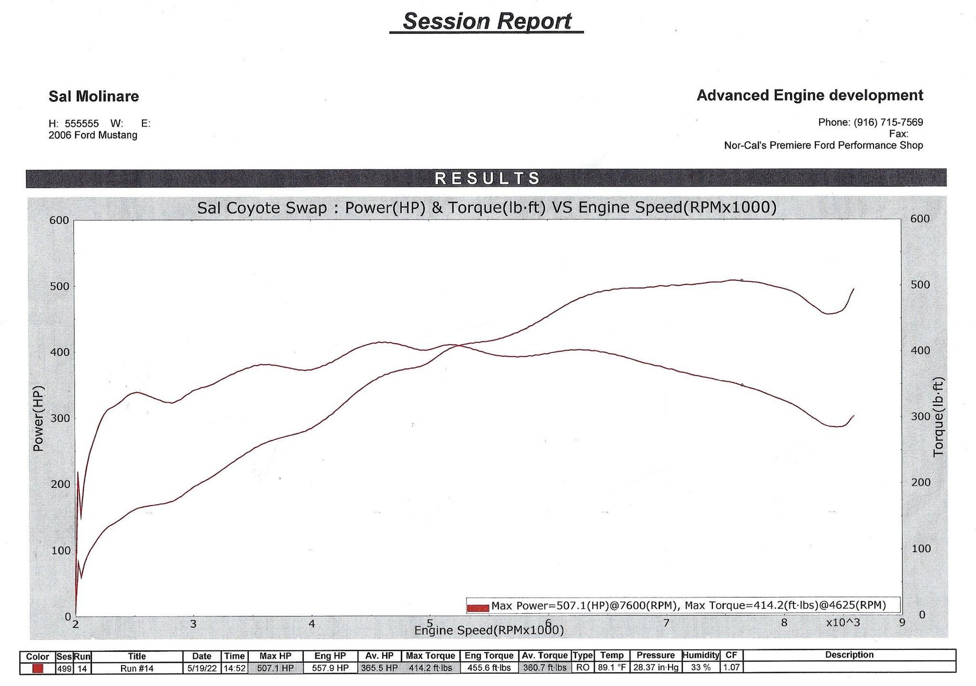

Gen 3 short block, CNC heads, (Boss or gen 2) L&M Intake only cams - stock exhaust cams, stock pistons, rods and valve springs, proper oil control (good pump/pan and crank scraper), Long tubes, 3" exhaust, Ported CJ intake and CJ CAI.
We road race these, so they get punished. One went to Chile and made just over 500 wheel there and mine I race here in NorCal and I made 507 wheel.
Different cars, different Dynos and in different countries.
The motors are built by Shaun @ AED Tuning. Total budget deal and very effective.
Dyno Video:
https://www.facebook.com/sal.molinare/videos/336370621937217
