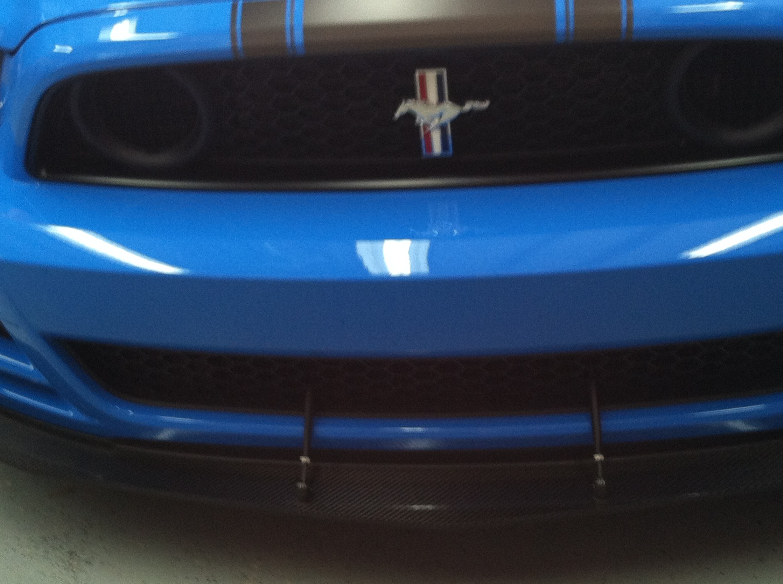

grille
I did mine myself. Its a 2013 but the same cutouts.
