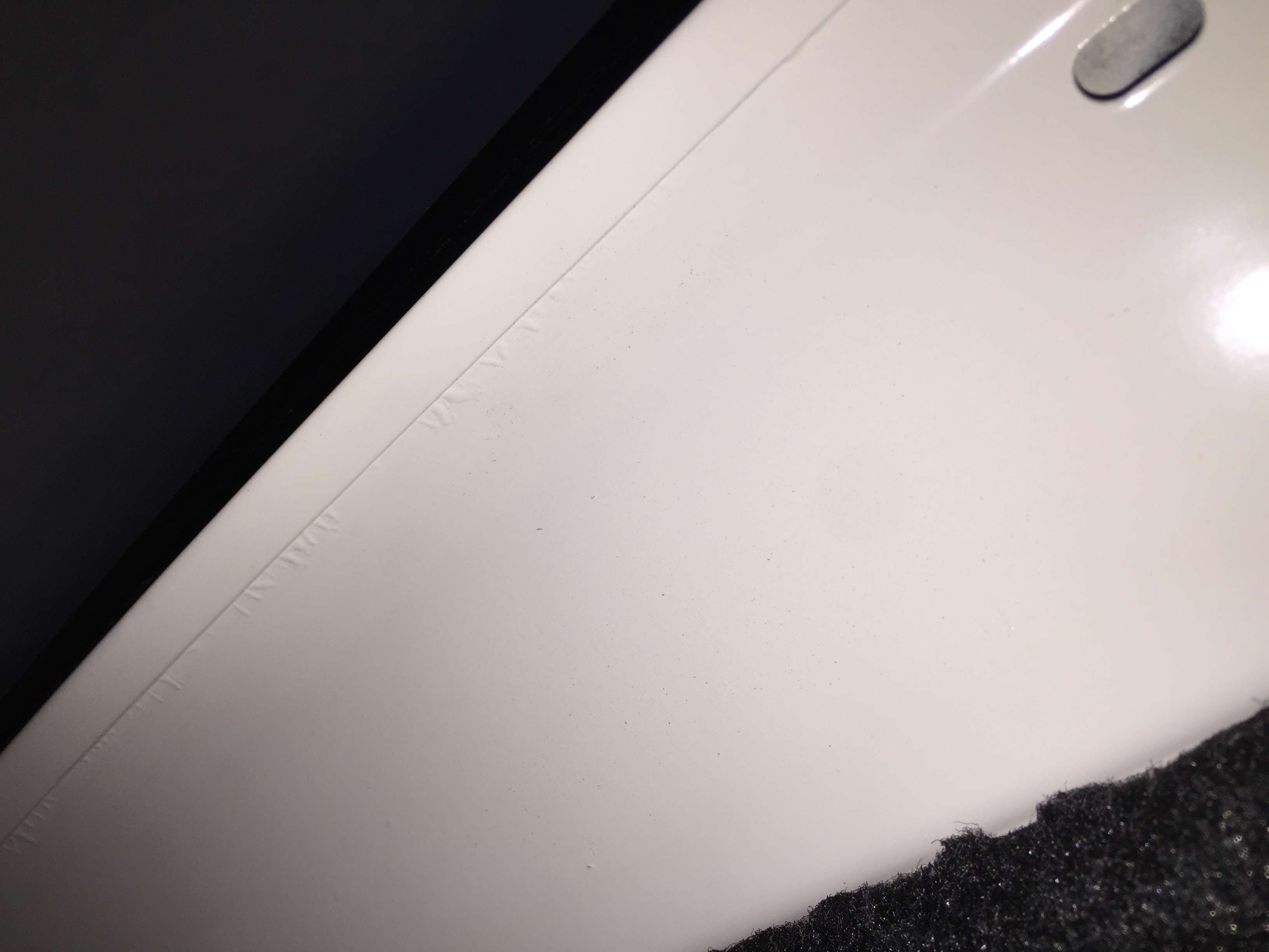

Old Jun 19, 2015 | 06:33 PM
  #166
TheDevice's Avatar
Joined: September 28, 2012
Posts: 66
Yeah, that makes sense. It must be rust then, these bubbles weren't there when delivered. I think I"m going to wait a month and see what happens.

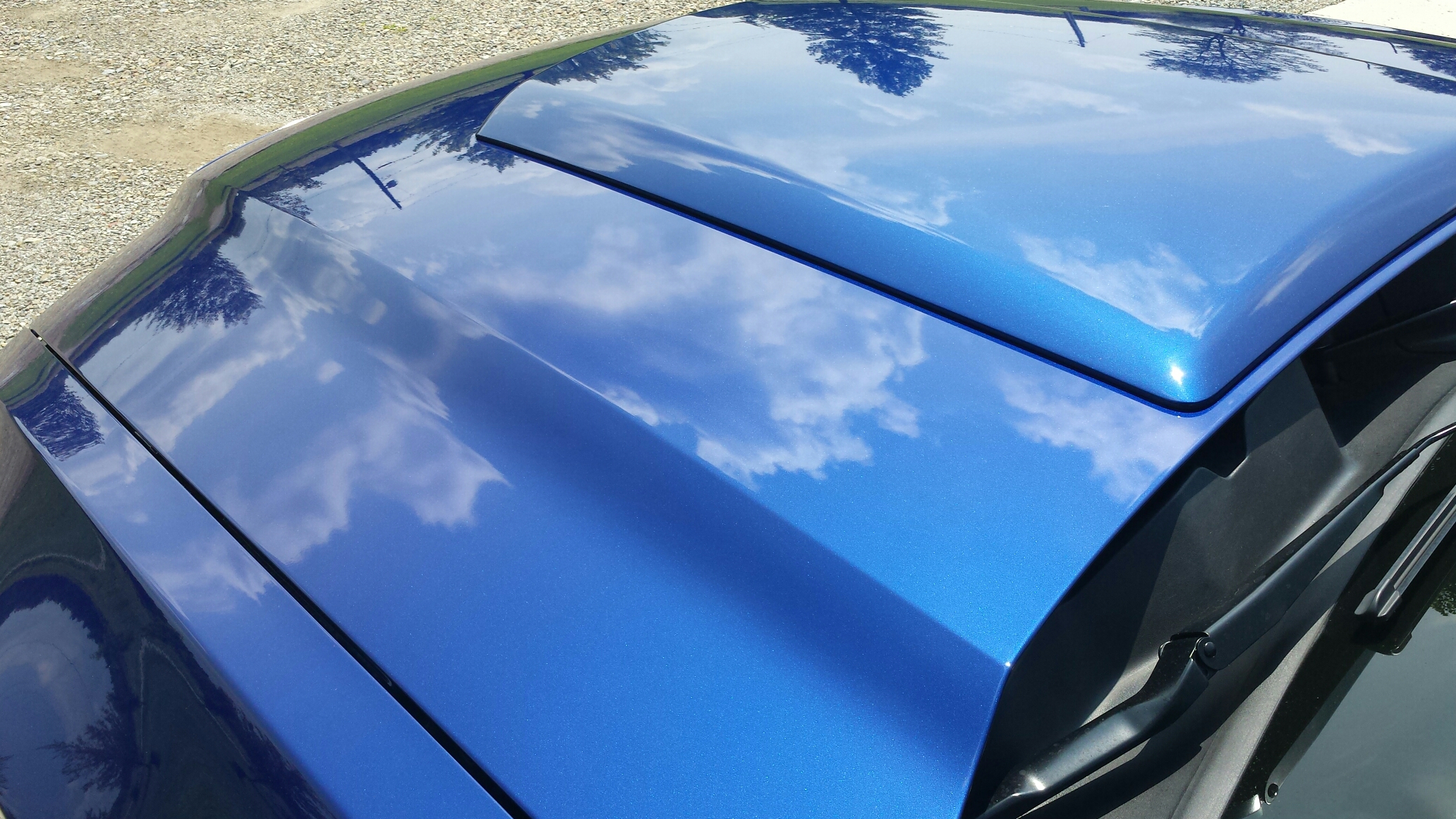

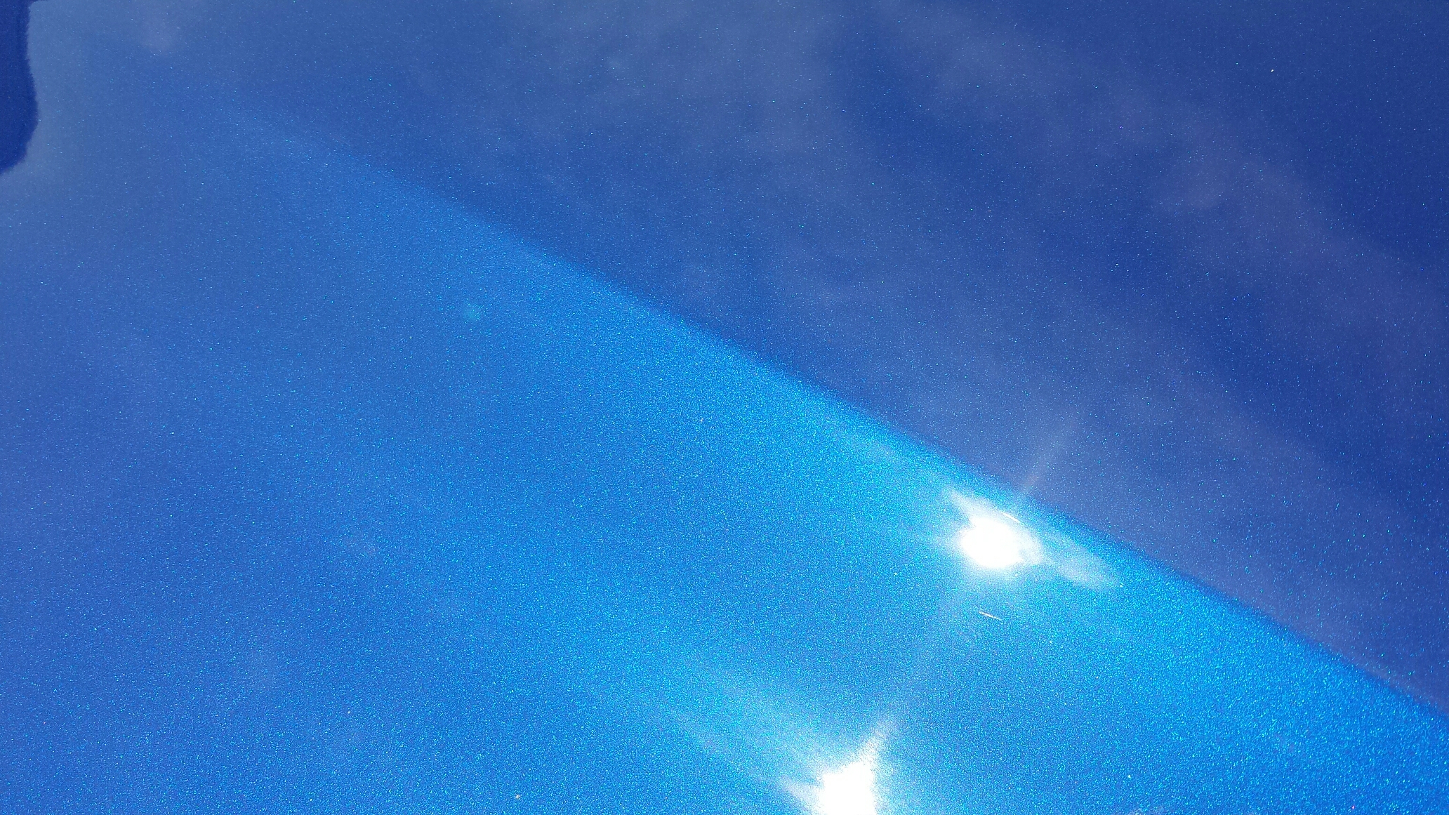

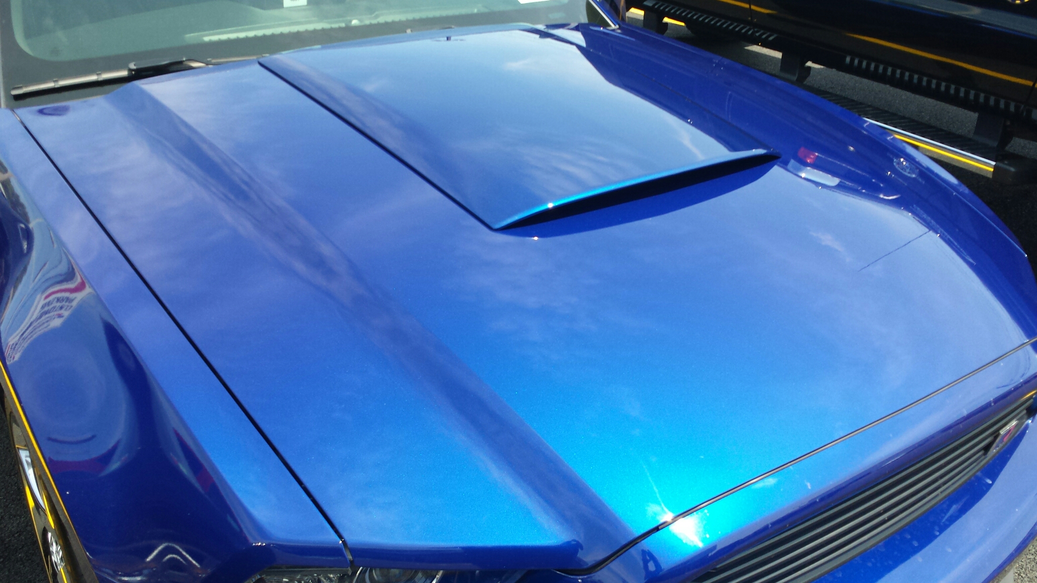

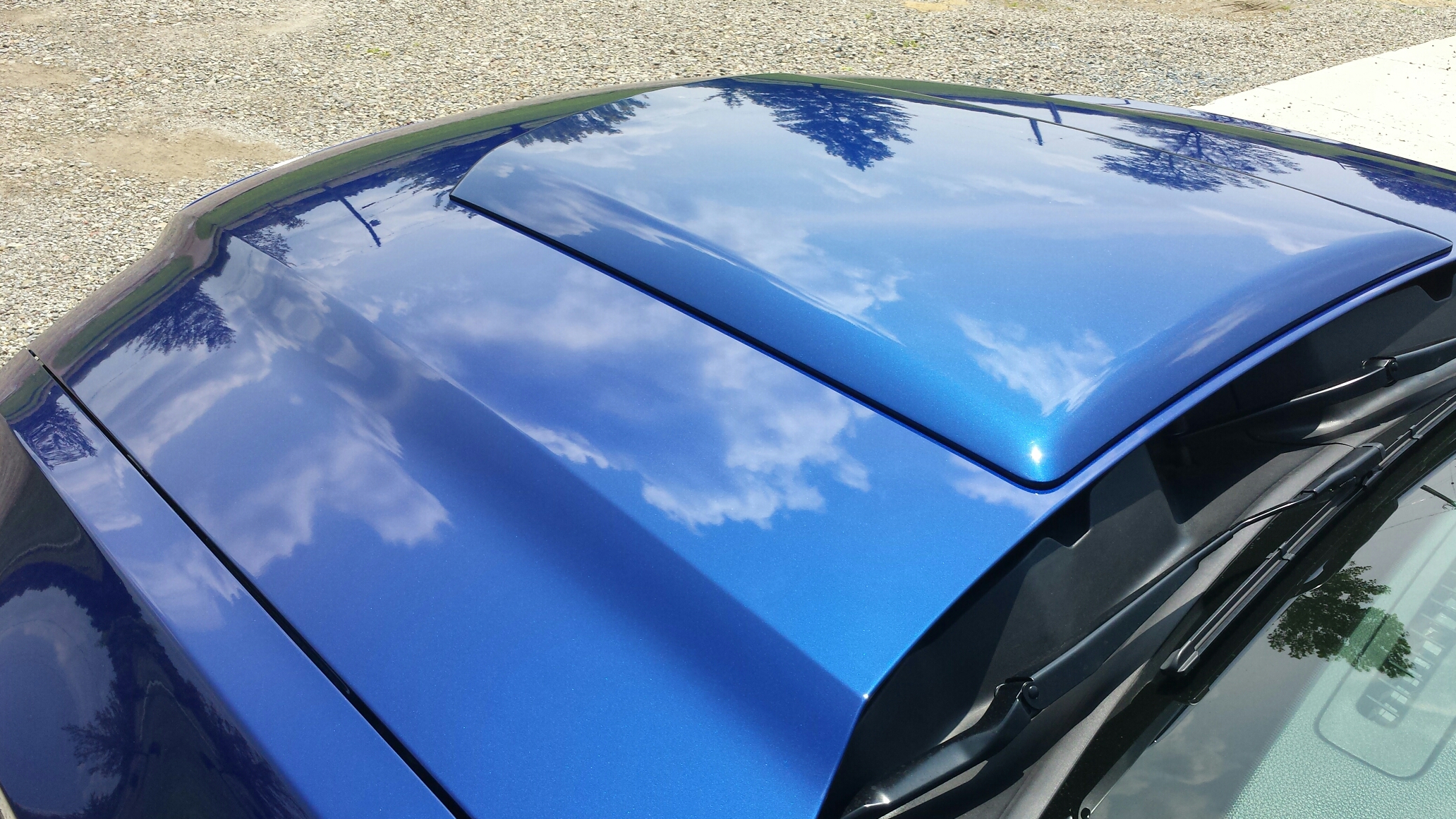

Front hood paint issues.
So my Roush went into the body shop earlier this week, and picked up today. The body work was extremely well done. The paint almost looks better than it did before. The dealer really treated me well, had the car done sooner than I expected, and the girl that was handling my case was very patient with me as I was taking pictures of my car before I handed the keys over and and a thorough inspection before I accepted the keys back. I was also worried about them working with the Roush installed pieces like the scoop and the struts, but they were quite competent with working with it.
Now just hoping that is doesn't come back... (good joke, right?)
Some pics of the after for those interested:

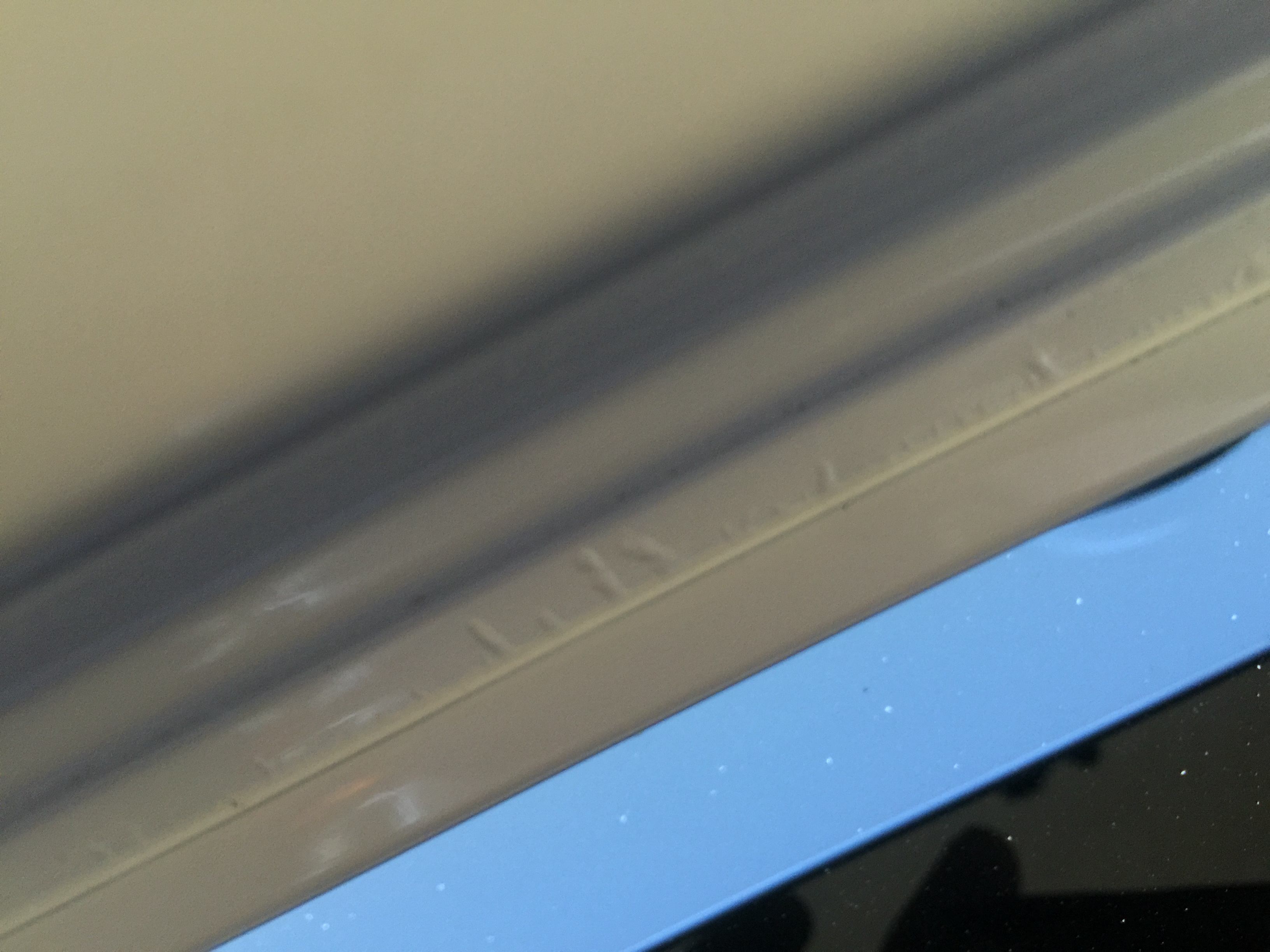

Attachment 172219
Attachment 172220
This is what my rear trunk lid looked like that Ford did fix under warranty.
Wayne
