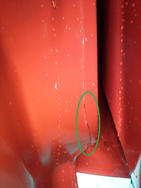

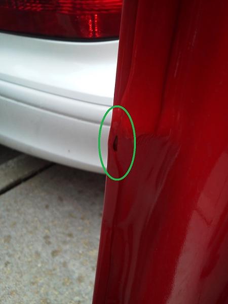

pasting some 2015 F150 pics, had put this in the 05-09 aluminum hood bubbling thread too... thoughts?
finally got to see a 2015 F150- as one might expect from me after suffering three mustang aluminum hood paint failures, I'm unimpressed- and not surprised...
what do you guys think of these pics? anything look familiar to the areas under your mustang hoods where corrosion initiated?
on the flipside, perhaps the little flaws are nothing, and the fact opposite sides didnt have them just means someone did 'too good' on the other sides.
maybe.
sorry but I see bad things coming 2~3 yrs down the road with these trucks. in my opinion, this is complete **** quality control compared to some other brands out there. put this on aluminum- I will be staying far, far away from the aluminum truck. it looks great, ought to be a great vehicle- but in my opinion the panel hem/sealing/paint on the underbody areas where corrosion always starts is simply pathetic. Perhaps Ford should contract Hyundai to put panels together for them.
to me the last pic (behind right rear tire) coulda been done better by a 2 year old...sad
this IS the only one Ive looked at, perhaps it is a fluke, and the next half million down the line the next few years will be just perfection...you never know.
added a pic of the $15k Hyundai hood prep just to compare a cheap alabama built car compared to the >$30K latest and greatest ford pickup... things that make you go hmm...

Yikes, that is so sad to see on a new F150. You would think ford would change up the process by now. It has to be costing them a nice chunk of change to paint these hoods and body panels.

curious- are they giving a 2 yr warranty on repairs, and if they redo at a yr, does the 2 yrs start over? I can see a lot (a whole lot) of dealership bodyshops getting beat up very badly over a problem that is not their fault...
