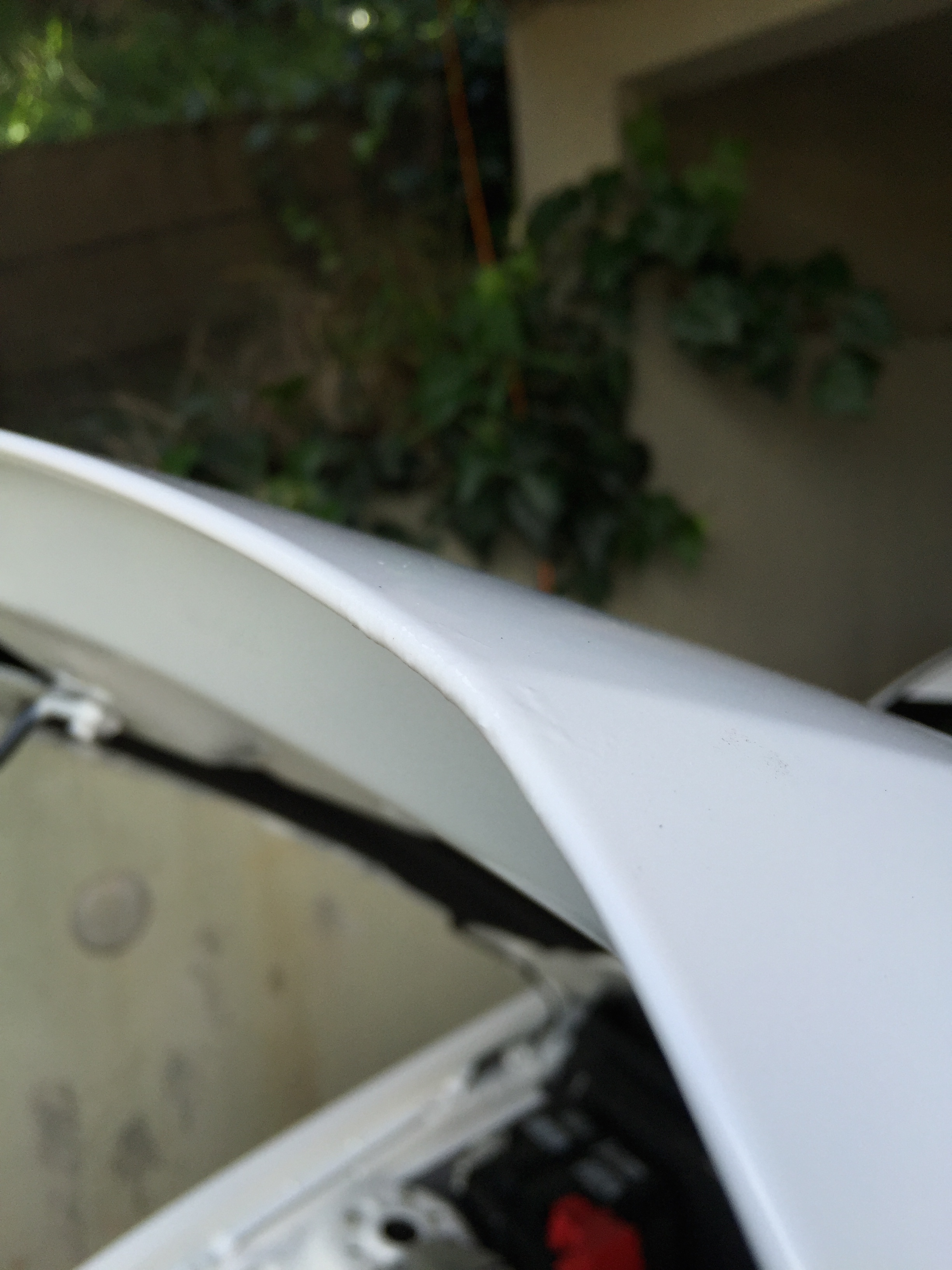

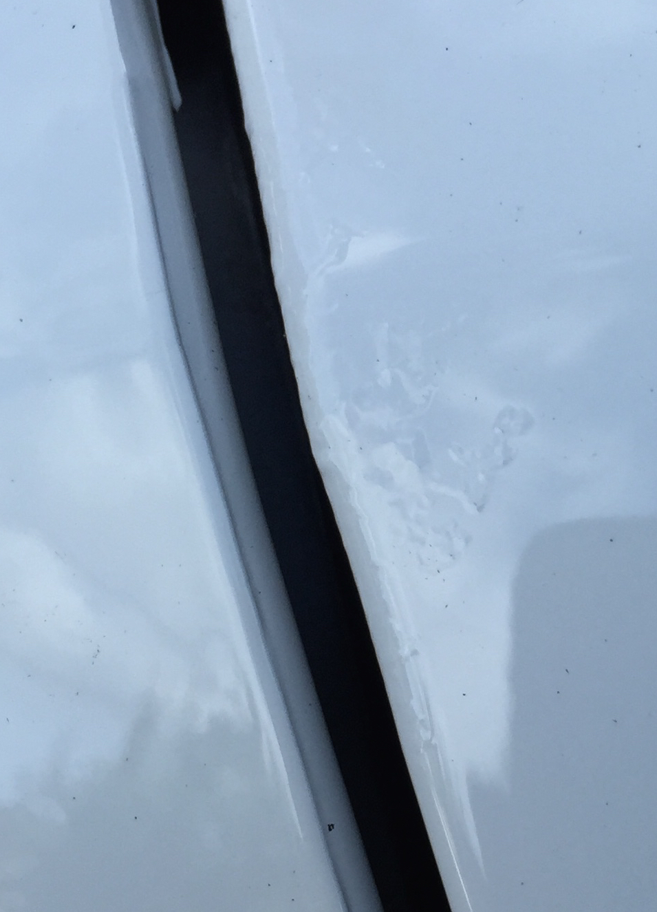

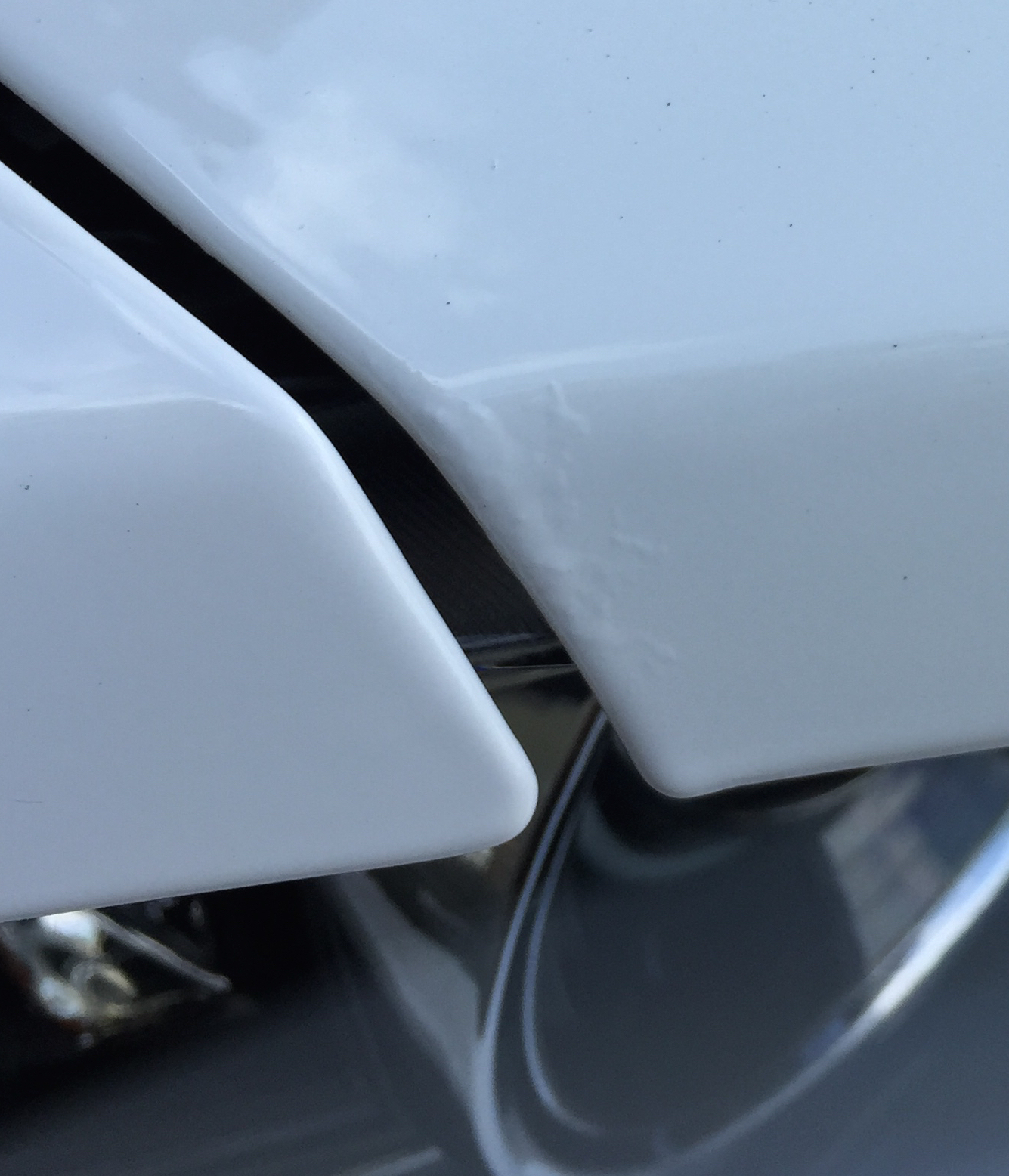

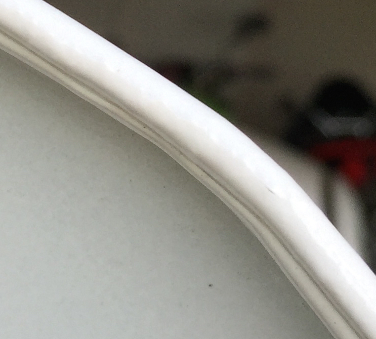

Old Apr 25, 2015 | 09:35 PM
  #108
TheDevice's Avatar
Joined: September 28, 2012
Posts: 66
Hood rot on 2013
Here's mine... first ford maybe last?
It's seen the rain once, 7k miles.

That's pretty bad Device, but actually rain has nothing to do with it. The corrosion occurs because the hood is not handled properly during the prep and paint process at the factory. It wouldn't matter if your car has never seen a drop of rain. The problem has been there under the paint since before it left the factory.
