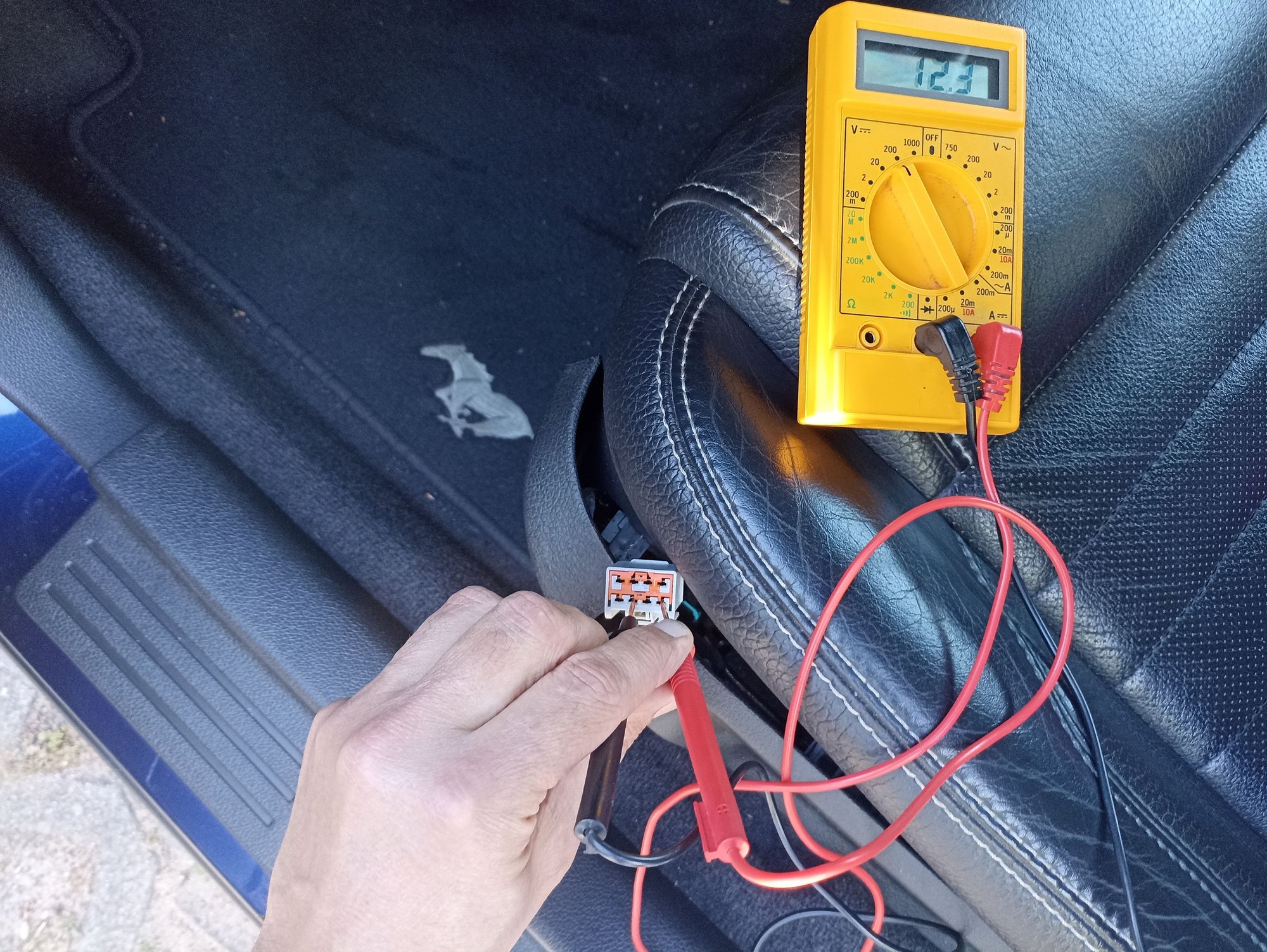

Checking For Voltage at Pin 4 Would Look To Be a Good Start. As Shown in Connector Pdf. I Believe it Should Be Hot at All Times. If Not Hot I Would Look At Backside of Fusebox at Driver Fuse Seat Location. Driver Compartment Fuse 32. I Have Seen Rodent Damage To Wires Underside Before Causing Odd Issues.
KC
KC
I had the pins on the connector measured earlier. There was only current/voltage from pin 1 and 7. All other pins were dead. I also checked the fuses, and they were fine. How would you interpret that?"

I'm No Electrician By Any Means But Looking At Connector 360 Where The Seat Control Switch is Plugged in it Should Be Hot at All Times With Pin 4 Always Being Hot and Pin 2 Being Ground. I Would Have Switch Unplugged To Test. Of Course Checking Body Side of Wiring. Wiring Pdf Seems To Indicate That as Well.
See if That Checks Out.
Again Lumbar Motor Pulls From Same Power Supply. So You Said it Was Working But it May Not Need as Much Power To Function. How Many Volts are You Reading When testing?
Pins 1&7 Are Driver Height Up & Down. Seems Odd To Me Both Would Be Hot at Same Time or Are You Cycling Switch When Testing??
Are You Checking With Switch Plugged in??

Oh and Had a Thought, Since You Have Power Passenger Seat You Should Be Able To Cross Check Things on Other Side.

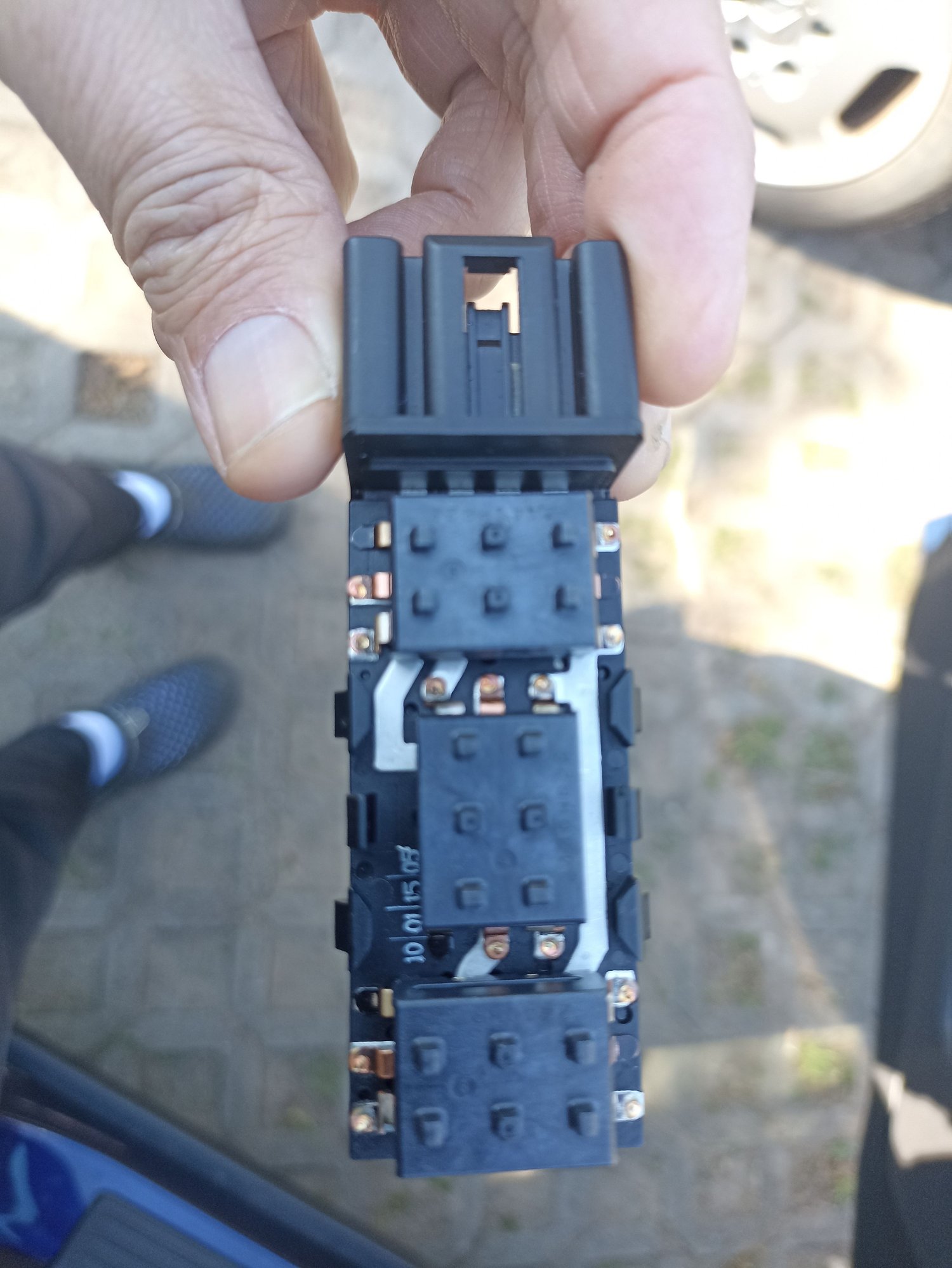

I Would Consider China Switch Suspect. I Have Had Issues With Off Shore Parts Myself. On Older Cars Many Times I Was able To Disassemble Both Seat & Window Switches and Repair. Usually it Was Just a Bad Contact and Needed Cleaning, Light Sanding, Filing Etc. Usually Though Those Switches Had Partial Function With Only One Feature Disabled. The Newer the Car The Less Likely A Subcomponent Can Be Repaired.
Never Tried To Dig into a S-197 Mustang Switch. Perhaps a Check At The BJB Underhood Fuses For a Voltage Check of Driver Vs Passenger Side For Voltage Could Shed Some Light. Also When Checking That Operate Which Ever Seat Switch and Check Your Readings When Switch Activated. Should Show a Reading! That May Shed Light Before Having To Start Pulling Seats.
Trying Your Driver & Replacement Seat Switches on Passenger Side Would Be a Good Test To Check Switches!
I Think i Would Try This First!

@Drive707
I Have Been Thinking About The Track For The Last Couple of Hours & It Just Seems Like You Should Be Getting Some Function Out of One of The Motors. Did You Check The Plug Coming Right out of The Motor As Shown in My Track Pics??? If Not I Would Make Sure it is Clean & Tightly Connected. Maybe at Some Point The Seat Was Removed and When Reinstalled it Was Not Snapped Together Properly. Other Than That I'm Wondering If Something Was Under The Seat or Wiring Got Cut By Seat Movement at Some Point in Regards To Motor Operation. Anyhow Just Had The Thought You Should Have Some Movement Even a Tiny Bit, Not a Completely Dead Seat since you have Power at the Correct Pins.
Also Note How The Plug is Pinned to The Motor Bracket. If Yours is No Longer Pinned I Would Suspect Wires Maybe got Fouled & Pulled.
Kc

Hello,
I Was Not Thinking About Space /Access Considerations so Much as Far as That Connection. Sorry. I Was Looking At Bare Track!
In Regards to Simply Disconnecting Battery. It Should Be Done But Only After Depowering Air Bags as Described in SRS PDF. Also Consider When Disconnecting Battery That Windows Unless Rolled Down Won't Allow You To Shut Doors Properly Due To Window Drop Down Feature.
Also Whenever Disconnecting Battery Some Things Will Be Reset Such as PCM/ECM Emission System. That is Always a Consideration Here in California When Say You Had a Emission Check Due and Car Had Dead Battery. After Replacing a Drive Cycle Would Have To Be Completed Which is Some On Off Regular Driving over a Couple of Days For The Most Part. Car Functions Fine But Simply can Not Be Checked Correctly For The Smog Check. Anyway Just an Example. Unless Car Has Some Other Module Issue Everything Resets and Goes Back To Normal After Driving Usually. Just an FYI!
Also on a Side Note Sometimes When a Module Related Issue Pops Up a Simple Battery Disconnect For 5 Minutes or So Can Fix Issue. In The Case of Your Seat Track I Would Not Call That Module Controlled To My Knowledge But Thought You Might Ask!
Disconnecting the car battery does not automatically disable airbags, but it is a crucial safety precaution when working on airbag systems. While the battery is disconnected, the airbags can still be triggered by stored energy in capacitors within the system, even if the vehicle is not running. To safely work on airbags, it's essential to disconnect the battery, wait for capacitors to discharge, and follow manufacturer's guidelines.
Having Worked at Dealerships For 30+ Years I Always Especially When it Comes To A Safety Issue Go With The Factory Advised Process. An Old Habit Which Has Served Me Well. Surely at Times Others Have Done Work Which Allowed Some Short Cuts away From Factory Advised Process But I Feel You Need To Advise & Inform Taht Sometimes Shortcuts Can Have Bad Results.
See Post 31 FOR SRS Depower
If You Just want a Quick Look At That one Connection I Was Talking About Then Removing The 4 Bolts From The Track To The Floor Could Allow You Some More Visual Access To Connector. However If You Want To Go Ahead and Remove Seat From Car & Will Be Unhooking Everything Then a Depower Sequence Should Be Followed.
If You Decide To Do The Removal or Flip Forward Some Pics Might Provide Some Clues To Issue. Maybe, Maybe Not.
I Know You Had Kind of Stepped Back & Was Going To Let Dealer Check Out and That is Fine, I Just Had This What I Thought Would Be a Quick Little Check!
Whichever Way you Go we Will Be Here!
KC
