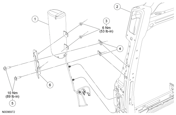

Originally Posted by gentlejax
where do I unplug the air bag module? didnt see it on the diagrams. I need to do this for both.
the 2012 seat is currently bolted in with its original track and wiring for power but NOT powered up. I was thinking of taking the track off the old seat and putting it on the newer seat of course id like to power it if possible. I just bolted it in so I could use seat and see how it looked.
seats are nice. hate to not use them. drove few hours to get them and I like them. just need to look at the diagrams and figure that out.
The Wiring will Be Coming Out of Backrest. Just Need To Make Sure you Don't Try to Put Power to. I was Thinking there was an Internal Plug as Well! I would Duct Tape End and Tuck Up in Backrest if you are Not Going to Remove. If Removed you would Have to Put Make Shift. Padding Back in.
I would Advise If Possible Using Old Track on Drivers Side. On Passenger Side a Trip to a Local Pick Apart & Cut Out Needed Wiring and or Pigtails From 2012 Era Car For Passenger Side. I remember Back in the Day we did some Add on Passenger Powered Seats For the 05-09's. But I'm Foggy as to Exactly How. I think Some Tied into Drivers Side and Others Ran Stand alone Wiring. Does You Car Have 05 Passenger Power Wiring ??? It's Been a Long Time and I was out of the Loop for About Ten Years Here at TMS and only Recently Returned. I did Email a Fellow Member who I believe Did an Add on More Recently and Hopefully he will reply. I think These Pdf's May Help as Well!
Remember as Well the Regular Airbags are Tied into The OCS Seat Sensors That's a Biggie! to Mind!

Ok Well if That is All. Why Not See if you can Simply Change the Seat Covers From One to Another. I'm Thinking they Will Fit But Not 100% Sure. Since I'm Not There With Them Staring at Me.
You Could Remove all the Extra Goodies and Sell on Ebay Such as Heaters & Air Bags. I'm Thinking Most of your Support is Likely in the Bottoms. You Would Have to Reuse The Top 06 Foam Unless you Got Some Foam to Replace Where Air Bags Were. That means a Lot Less Wire Cutting!
The Lumbar Unit Could Be Exchanged at that Time it Should Interchange Maybe a Plug Difference?. Just a Thought If you Do not Want to Try That Or Don't Think they will Interchange. We Will Move Forward with Next Option. Take a Look at the Shop Manual Pdf'S.
Now That I Look At the Pdf's I'M Thinking Simply Bolting the 2012 Seats to Your Old Tracks and Changing Either the Pigtails or the Parts From the 05 Seats Such as Ocs or Seat Track Sensors To the 12 Seats Would Be Easier. Anyway It's a Different Way to Look at the Conversion.
The Exploded View Kinda Puts it In Your Face. A lot it Depends on How Much Time you Want to Put into It! After you Eliminate All the Stuff You Are Not Going to Use it Should Look Less Daunting! First Thing I would Do is Figure Out What You are Not Using and Remove or Tape & Ziptie Up If you are Going to leave in Seats.
Did Not Mean to Overcomplicate your Original Request but after 30+ Years in Ford Parts The Mind Thinks about Every Scenario!
Back in the Day this Retrofit Stuff Was my Thing. These Days With my Health The Mind Does Not Work as Well and I have not been so Involved in this Kind of Stuff For The Last 10+ Years Just getting My Sealegs Back. Also I no Longer Have Oem Ford Parts Catalog Access to Ford Like I used to! So Working with a Hand Behind the Back Compared to Back in the Day!
Those are Some Sharp Seats Btw! We Will get it Figured Out.
