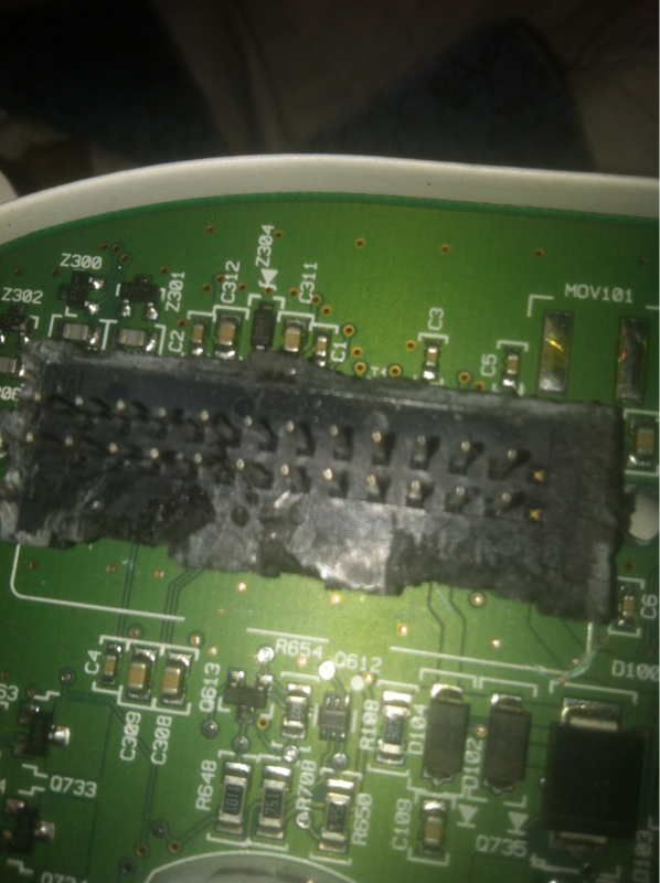

I have an issue that you all may be able to help with.. what do I do if some of the pins on the connector for the gauges broke? The 2 right pins broke off... I still have them, I just need to know what to do!

oh man, that sucks. Any good with a soldering iron?
you may need to get at the back of that board to desolder the remaining portion of the pins and solder in a fresh pair, or you might be able to solder on those sections on the stubs.

10MustangGT's Avatar
Joined: September 27, 2012
Posts: 97
hmm.. i might just take it to the professionals for that one!

From: Alberta
If you can take off the plate the pins poke through, then you can replace the pins. It doesn't look like that can be done in this case. I think you'll have to solder them back on.

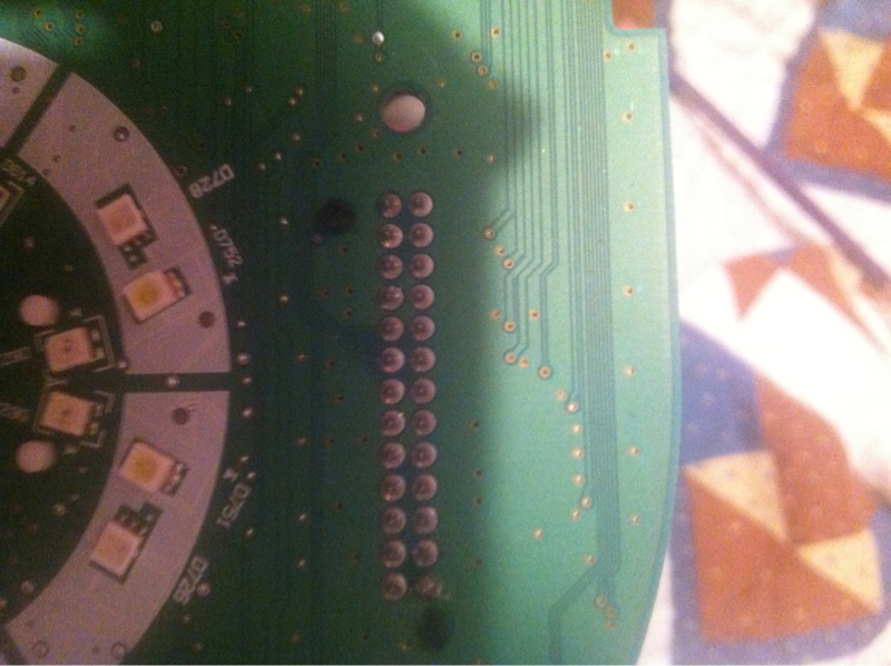

the pins poke through! now how would i go about replacing them?

From: Lithia, FL
Find a local computer repair center and see if they either have the pins or buy an old board that has some and de-solder the pins from an old board into your board. If you're not comfortable soldering then let the computer repair guy do it.

From: Alberta
Agreed. Don't give up. It is a simple fix that an electronics repair shop can do. Take it in and see what they can do.
