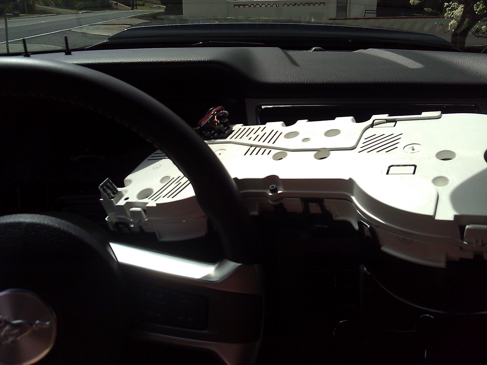

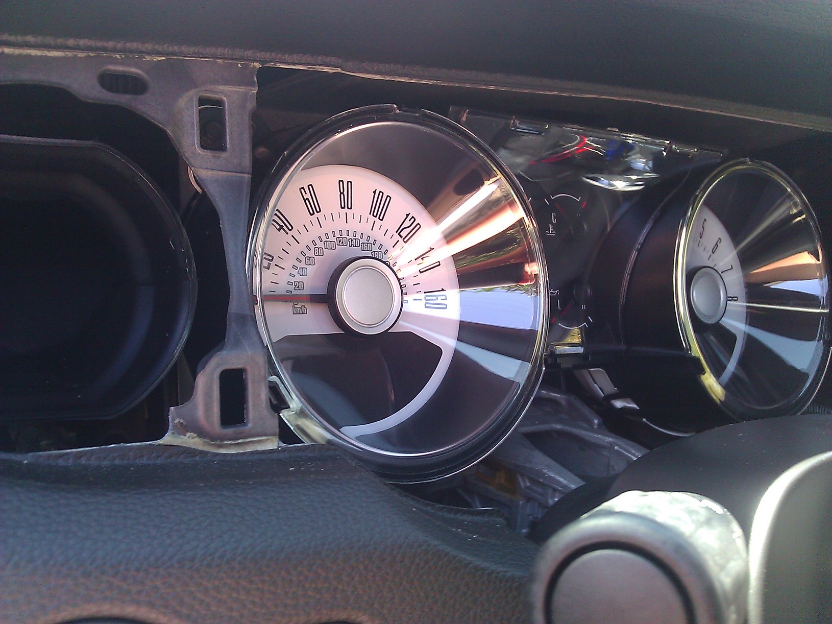

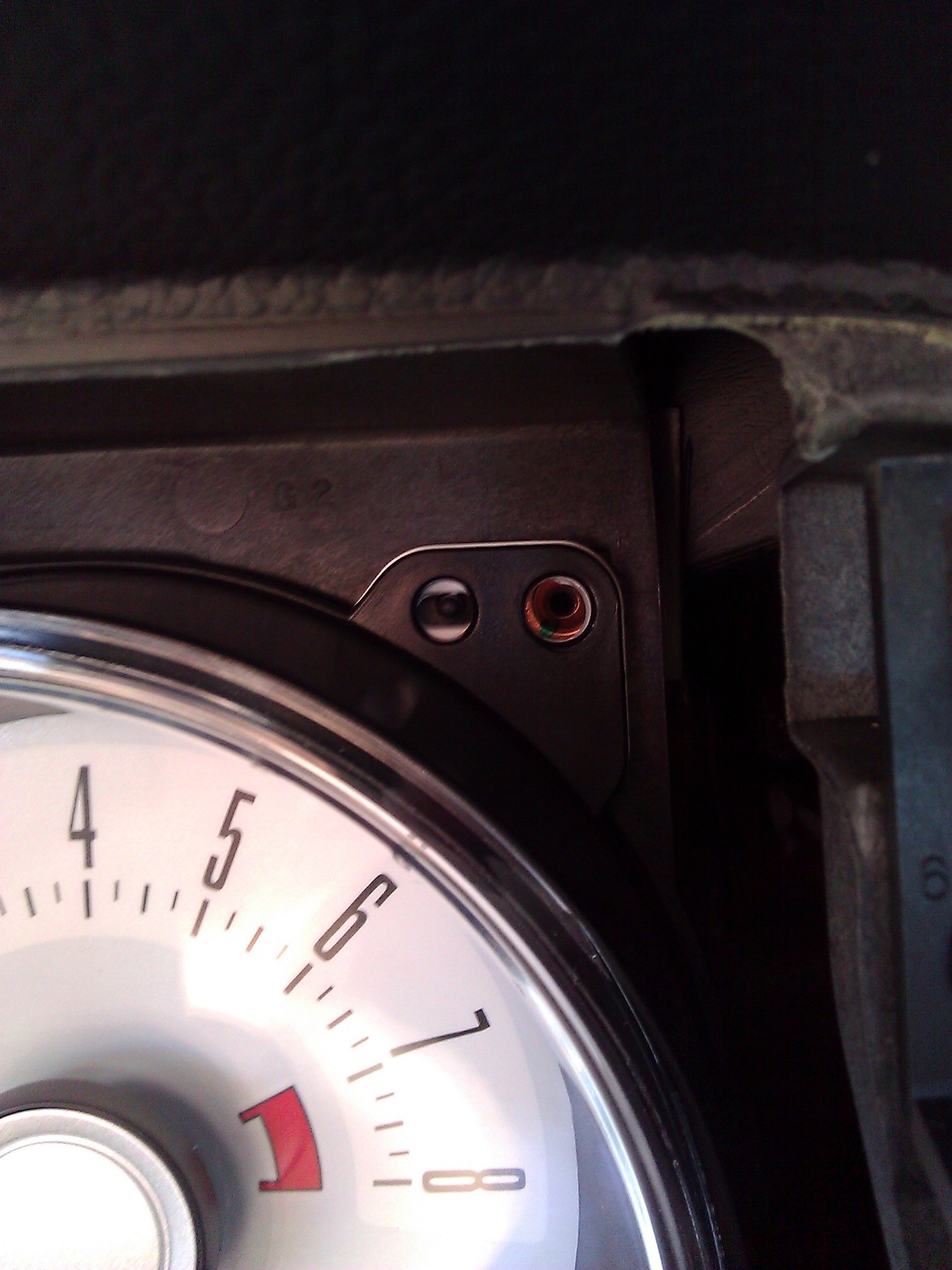

Alirght. So to get this out in the open, this install took me about 3 hours. It is the first time i've torn apart (and yes, you do tear apart most of it) any part of my dash. Overall I like them, I do notice that they seem to be more reflective (shiny) I've included are some pictures for your enjoyment.
I HIGHLY reomend using 1.) a fork to lift of the needles and 2.) a magnetic wrench of some kind, I dropped (and lost) both screws while trying to put the dash back in.
I'll be happy to answer any questions about the pictures as well

I received the same gauge faces last week. I have a few questions if you don't mind...
The instructions that come with the gauge faces are different from the ones posted on their site or the method you used. They make a big point about how easy it is to damage the gauges and they recommend twisting the needles off but that concerns me. Did you have any trouble removing or replacing the needles?
I used an old trick I learned while working on my Gold Wing - stuff a cloth around the opening where you remove the screws so that when they inevitably drop, they land in the cloth and don't fall into the bowels of the dash. When I removed the screws, the top of the gauge package came loose but I wasn't quite sure how to wiggle the entire module loose. It seemed to be fastened at the bottom somehow. How did you get it out of the dash?
I'm giving serious thought to leaving the four center gauges with their stock backing because I prefer the less bold font and the range markings. Do you think it would be any problem to cut the OEM face panel between the gauges so that I could just install the speedometer and tachometer faces?
Finally, did you have much trouble with the adhesive? Did you have to use heat to remove the factory face? Did you have to add any more adhesive to attach the new face panels?

I plan on keeping the stock center as well. I'm asking to see if I can get a custom set of the GT500 ones with a less bolded font, and unbroken outer ring.
Would love to see more pics guys especially with the halos activated.
Also, I believe Whitebird that you can cut with no problem, and lifting the pegs with a fork will be the removal method (they're just pinch pins). Though I'd wait to Oric to confirm (although he had a picture with a fork under them, and had marked their positions before lifting)
