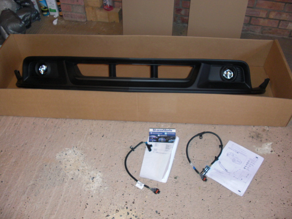

The valance was delivered by Ron a couple of weeks ago and the first job on returning to the UK was to fit it.

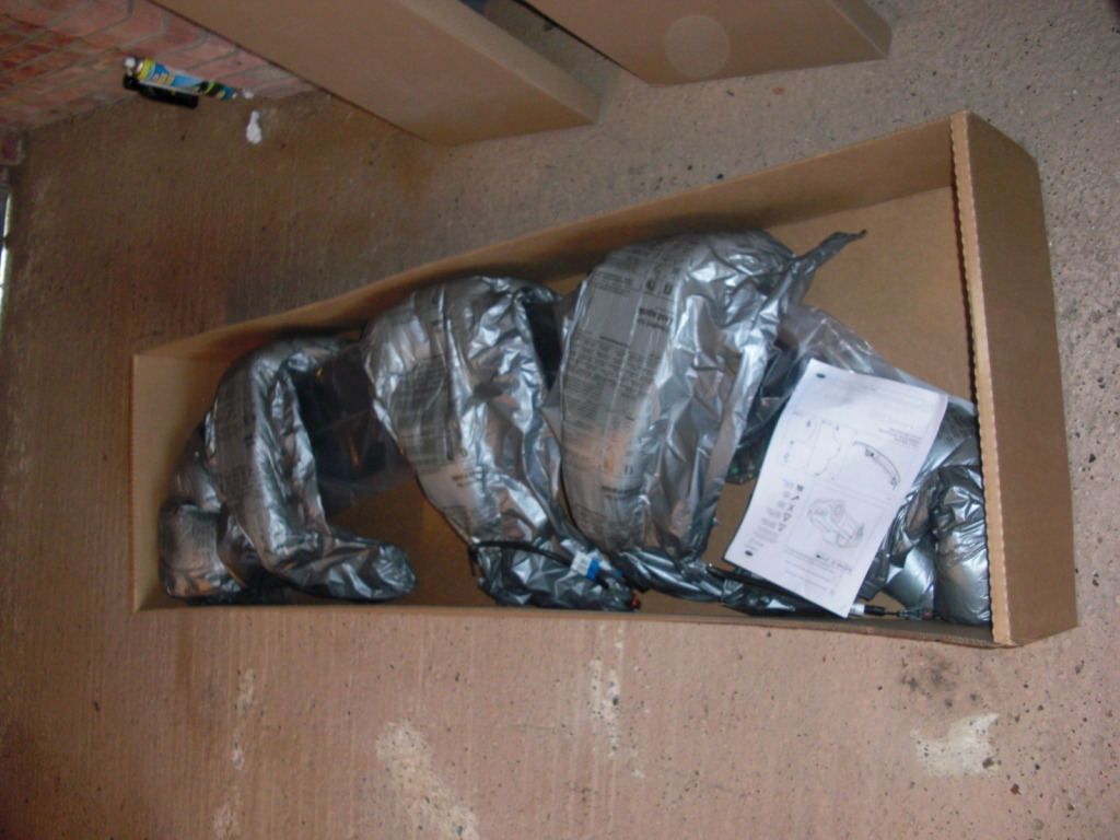

The part was ordered through Stang Mods and was well packed, the kit included the wire loom pigtails and Ford installation instructions which involved fully removing the bumper cover.

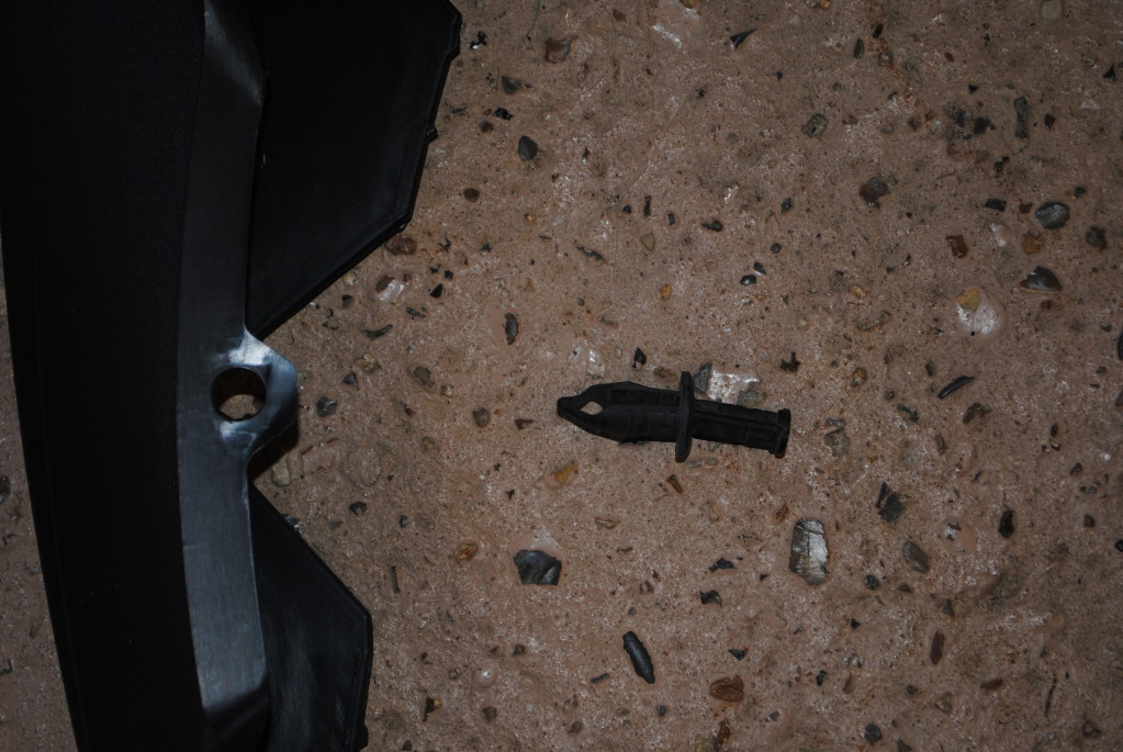

There were a couple of differences though. Firstly two push pin clips were installed on my car not mentioned in the text. Looking at the new part it was obvious where they went.

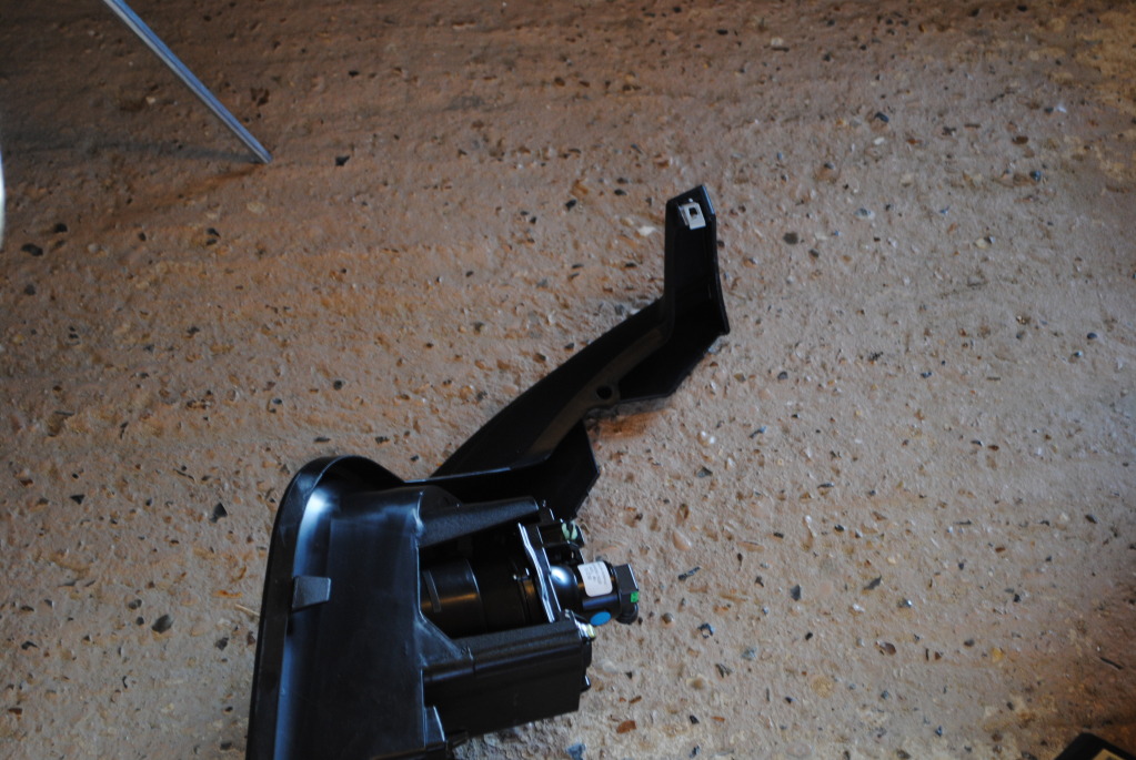

Removal of the valance went to plan until I got to the end screws on the upper side of each end of the valance.
I found them impossible to get at. So on inspection it was apparent the 2 screws near the fogs were the only thing holding the entire bumper assembly in place. So off they came and I removed the entire bumper.
This allowed easy access to the end screws and it was easier to work on the valance once the bumper was off the car. From here on in I followed the Ford instructions which while having seemingly bewildering pictures reading pre-install it all becomes clear when looking at the car.

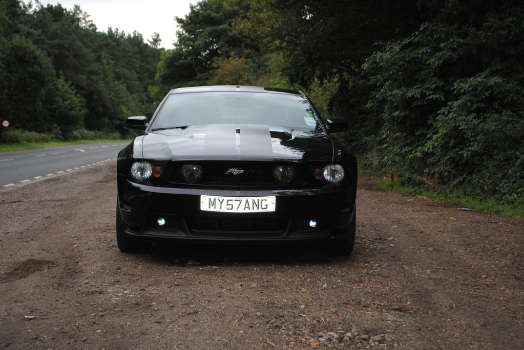

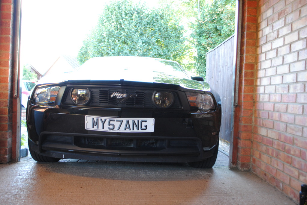

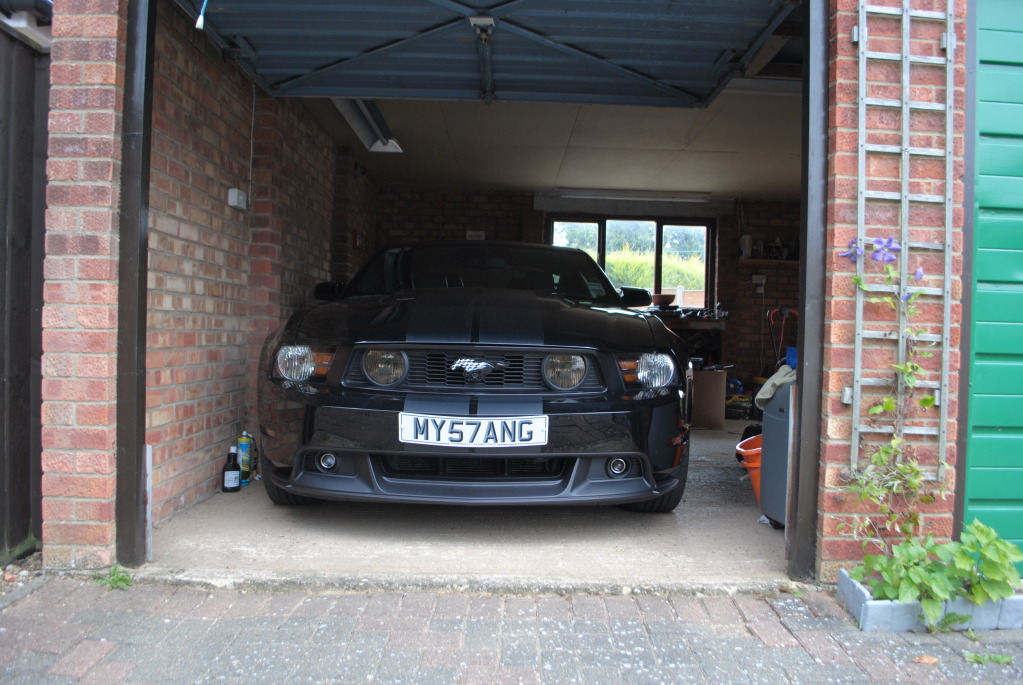

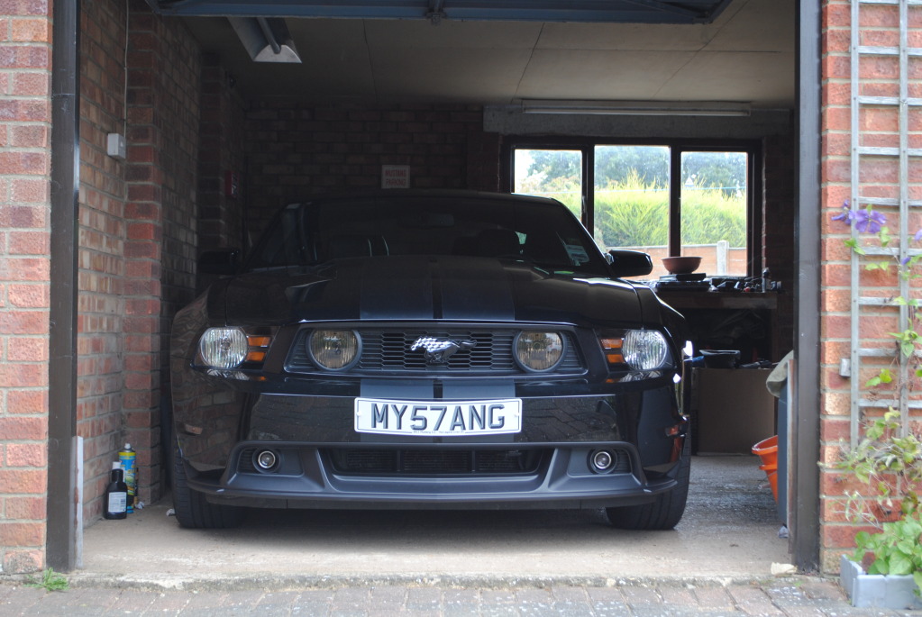

Before
After ><
I am very happy with the new look.

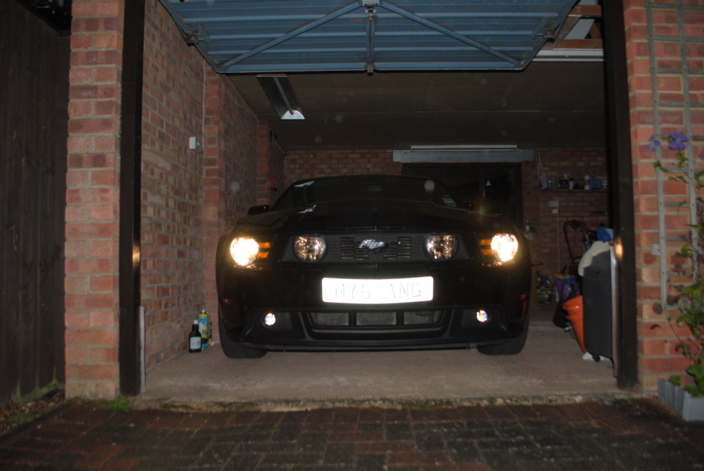

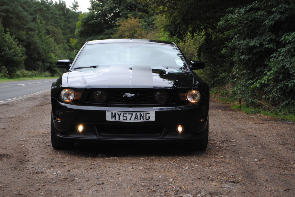

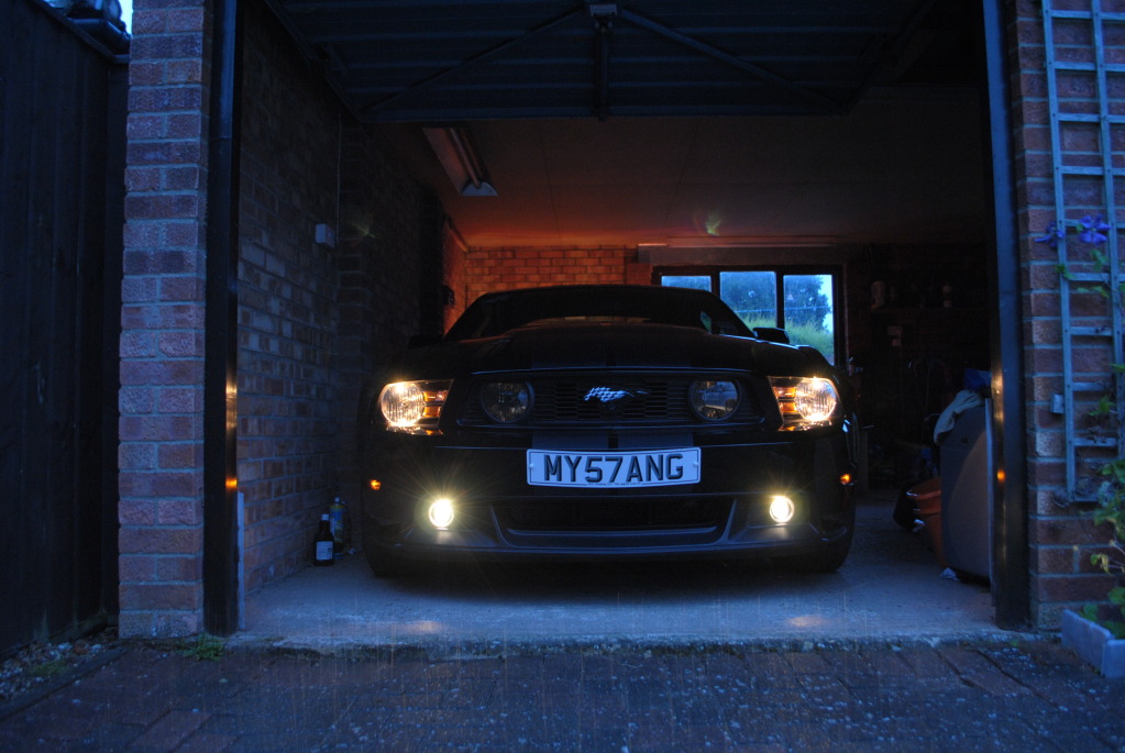

Here are a couple of low light shots.

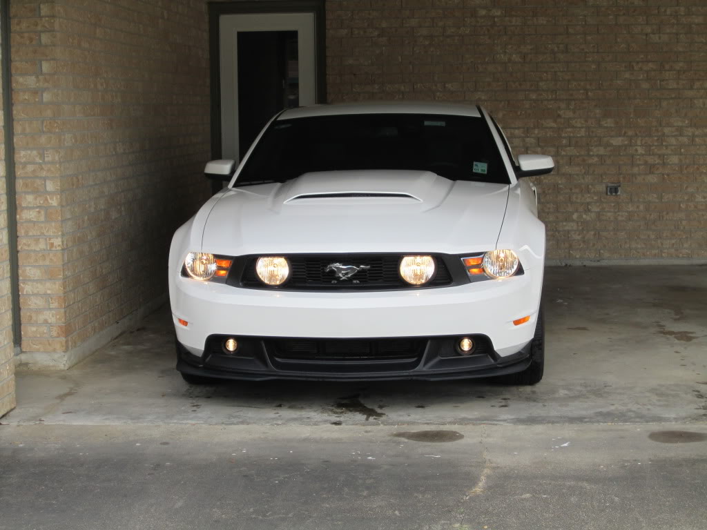

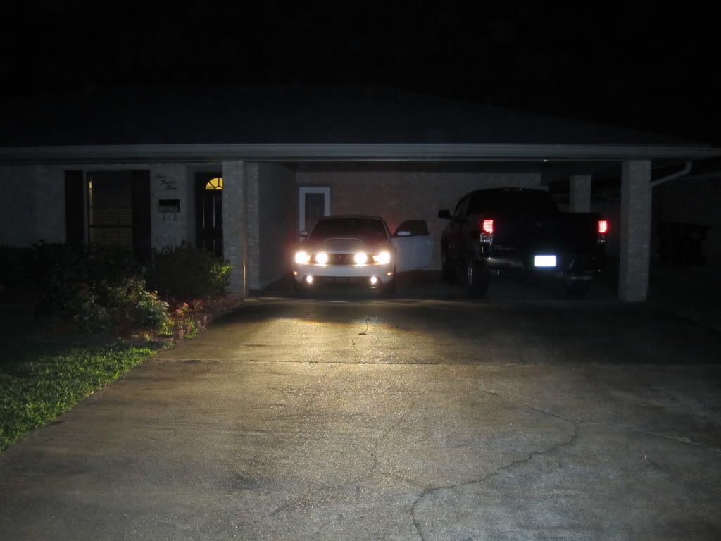

Simple relay circuit will give you this.
lower fogs turn on when grill fogs turn on.
