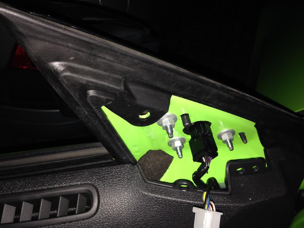

Disconnect the gray plug from the mirror adjust switch and set the panel aside to reveal the mirror plug and 3 11mm nuts.

Disconnect the black mirror plug.

loosen the three 11mm nuts with your wrench. While supporting the mirror with one hand remove the nuts.
