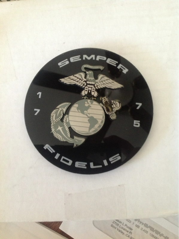

This is the custom cap I had made. My build is going to be dedicated to the Marine Corps, how hard was it for you to get the panel off, I'm thinking I may be better off having a body shop take it off and ill put it back on?
