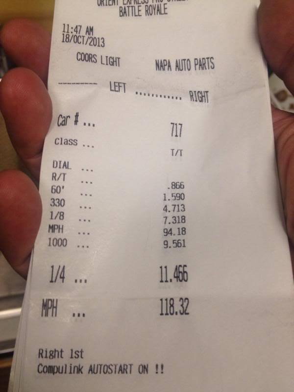

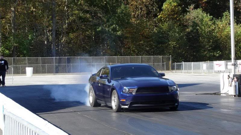

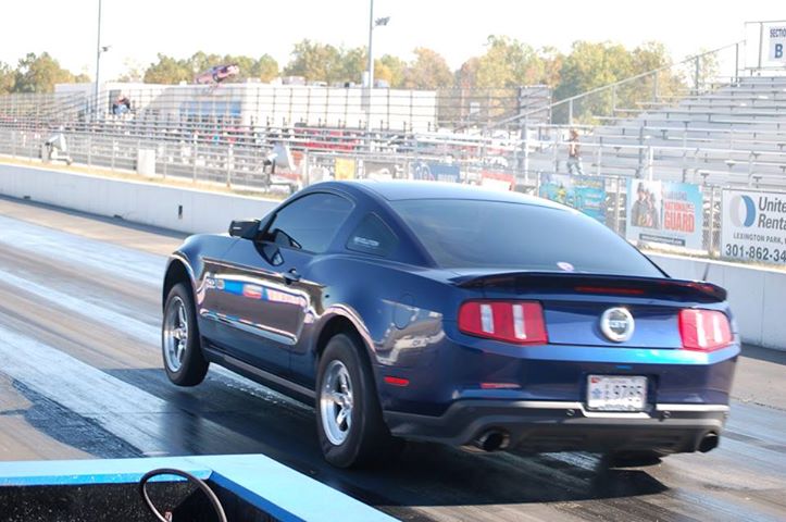

here is another new best time.. i went to the track rental at MIR.. i did about 14 runs with my 2012 Auto and was able to get about 5 to 6 runs in the 11.4's and the below was my best run.. the car weight was 3890 with 3/4 tank of gas in it..
car has the normal bolt ons.. 3c converter, 373, DS, jba LT, H pipe,CAI, Rev Auto tune, UCA & LCA, weld skinnies and DRs.
i'm launching off a MSD 2 step box at about 3200rpm.

Awesome times! And your car looks menacing!
