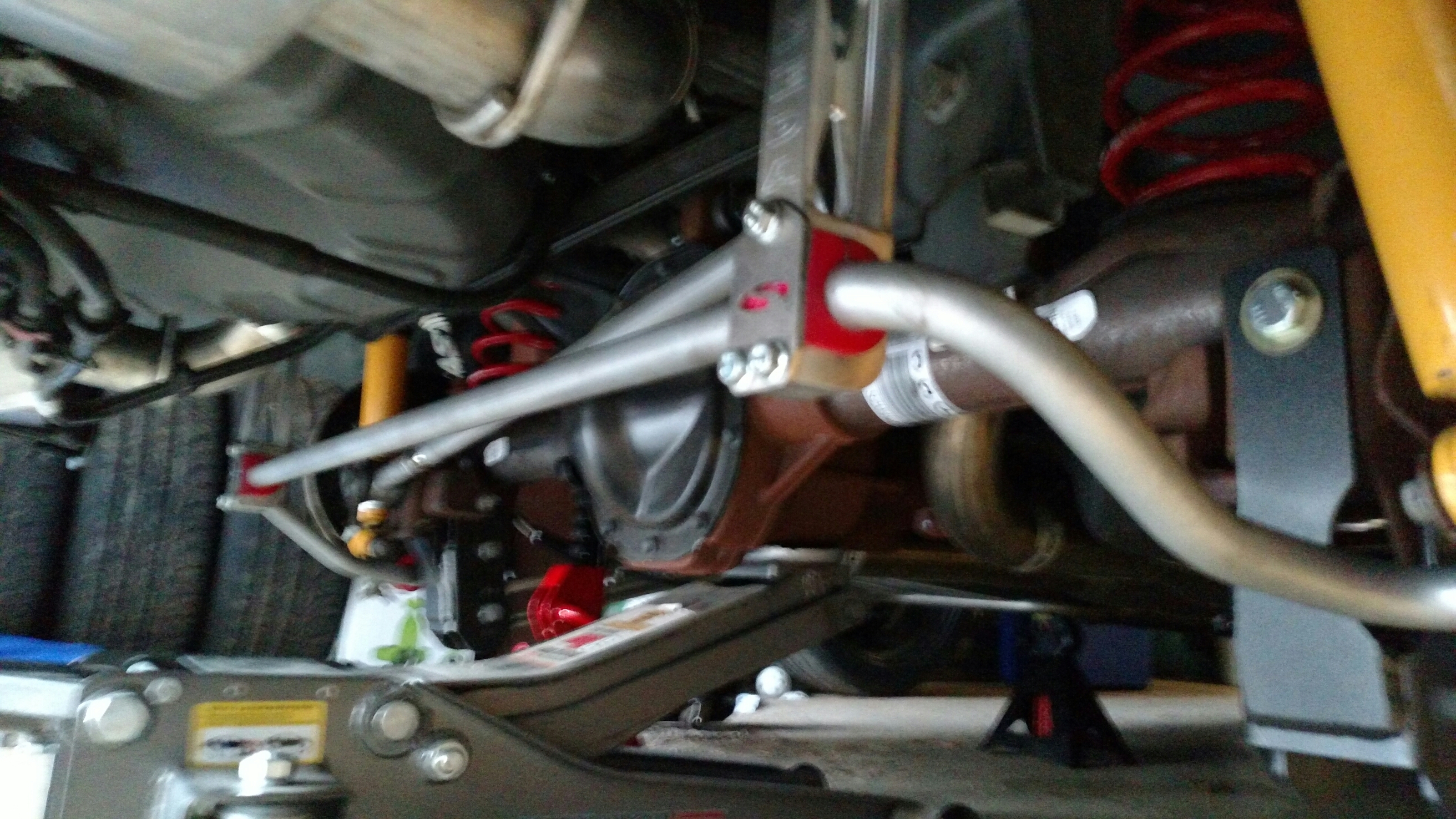

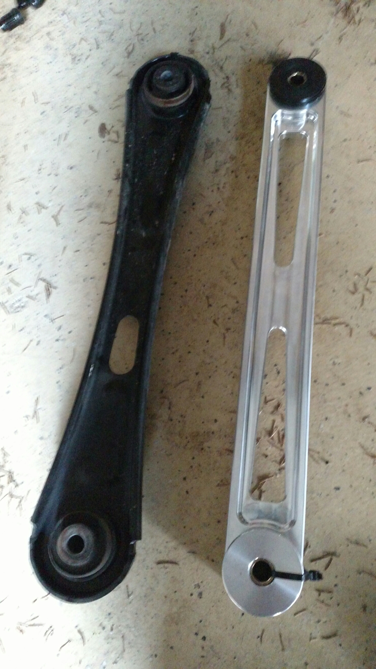

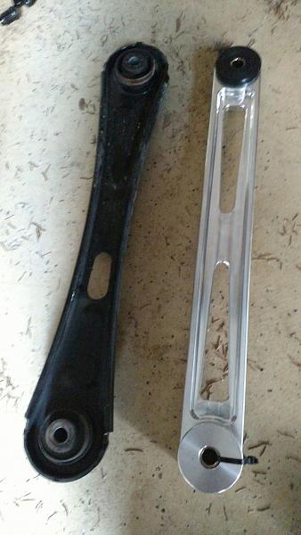

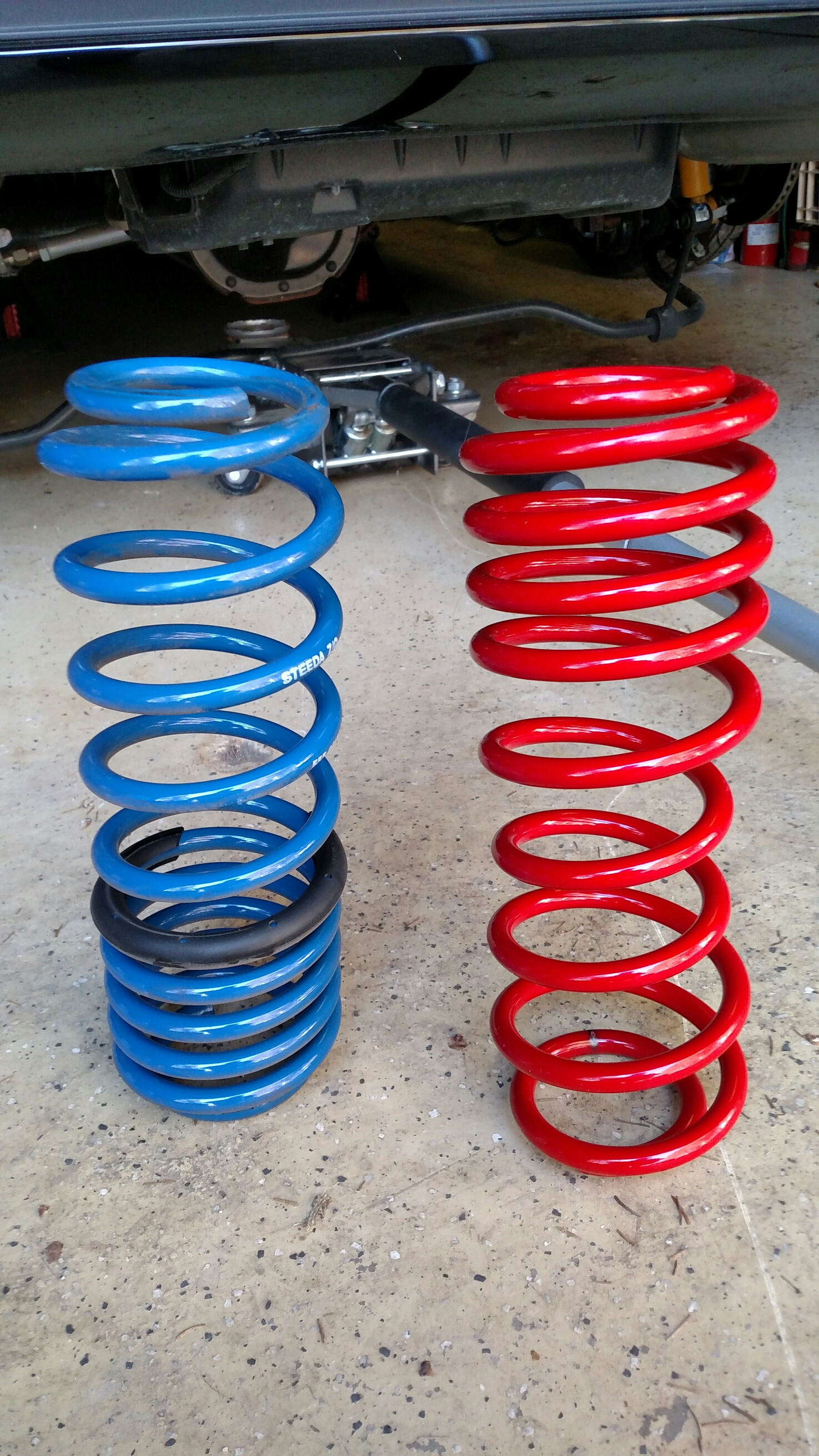

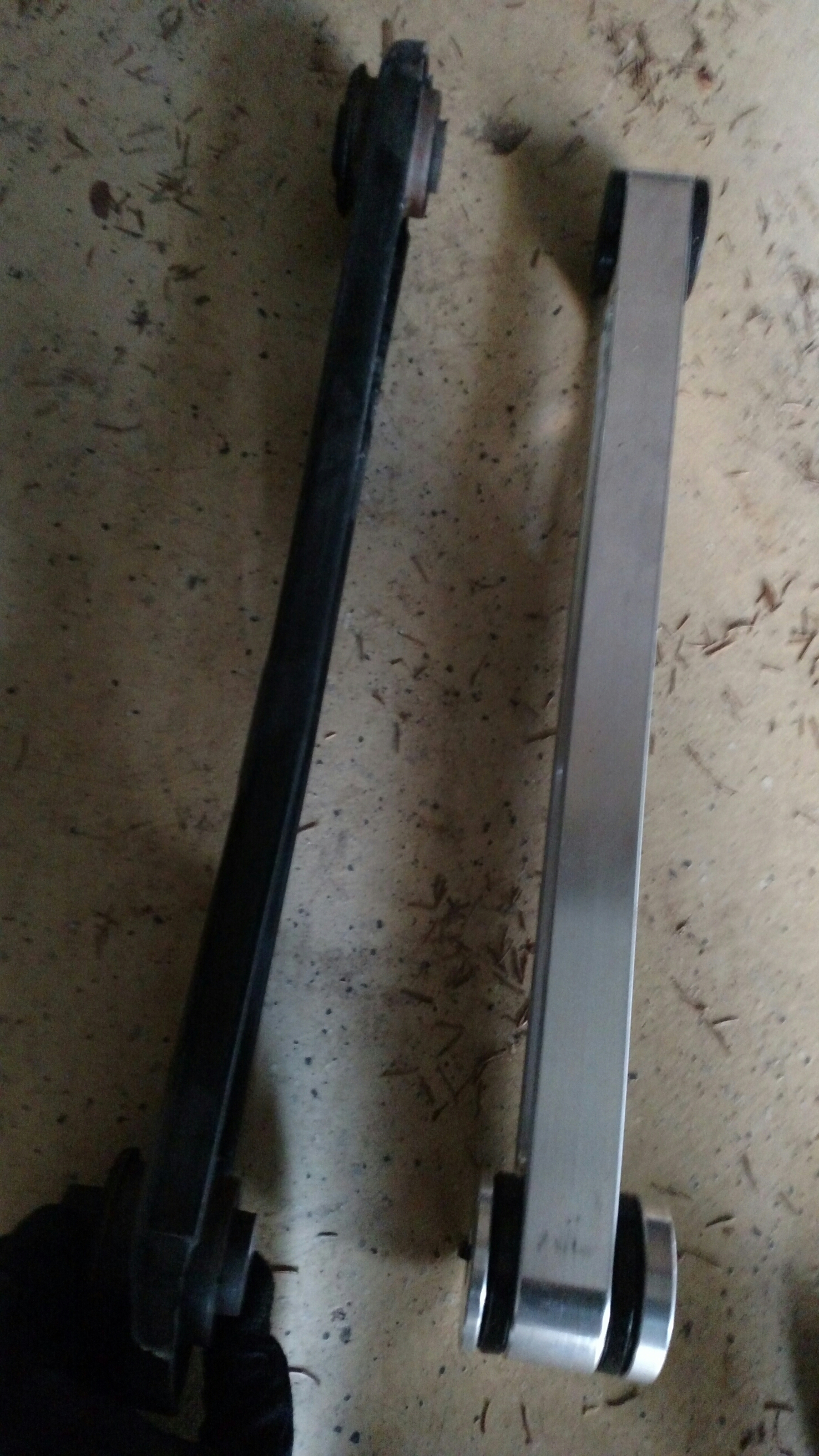

Got the rear BMR springs in. Working on the LCA relos, Steeda LCAs, and Steeda sway bar now. Hoping to get it a little lower but I'm also worried about the Kooks side pipes rubbing now. Can't have both I suppose. Hoping this will be a happy compromise, as I would ideally be even slightly lower. Might hold off a little longer to get the side pipes installed. Going to try to do those when I do the Roush side splitters.

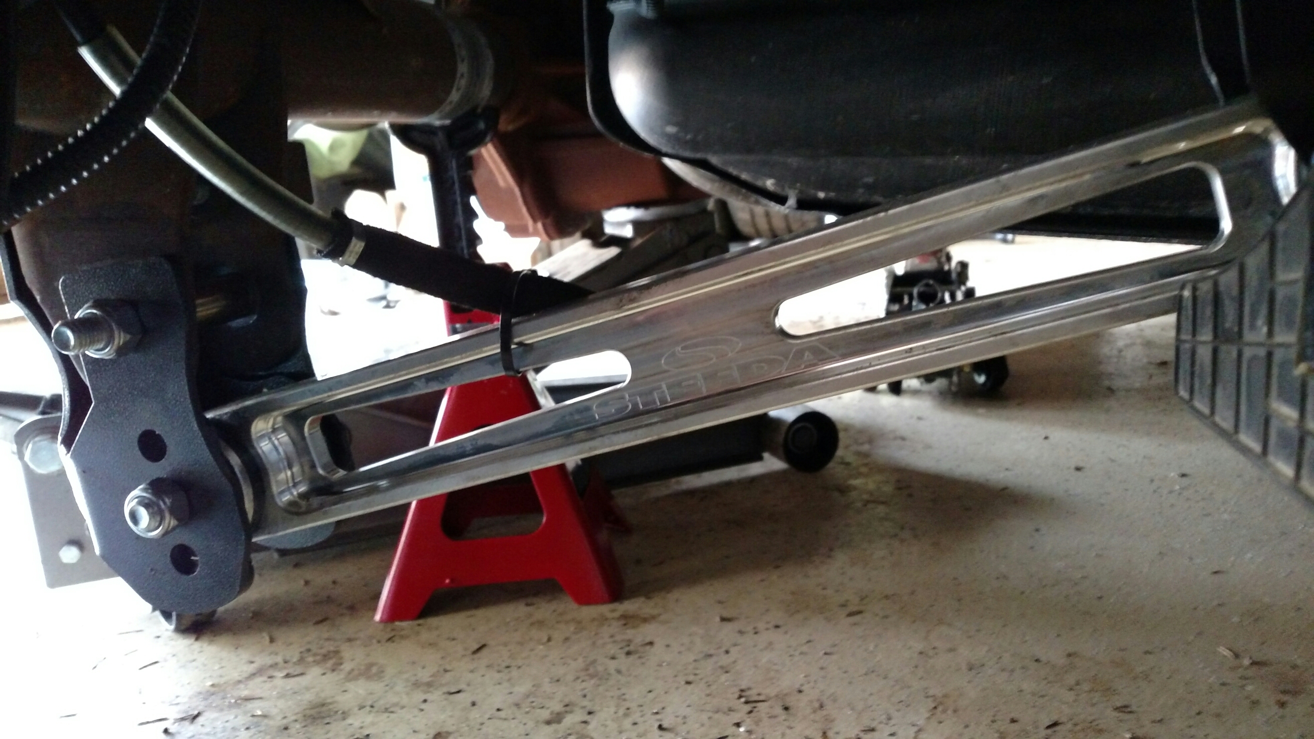

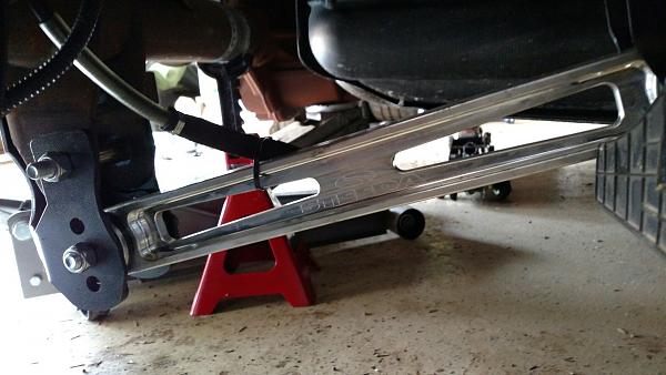

Passenger side is complete. Not sure I'll make it to the front end today.

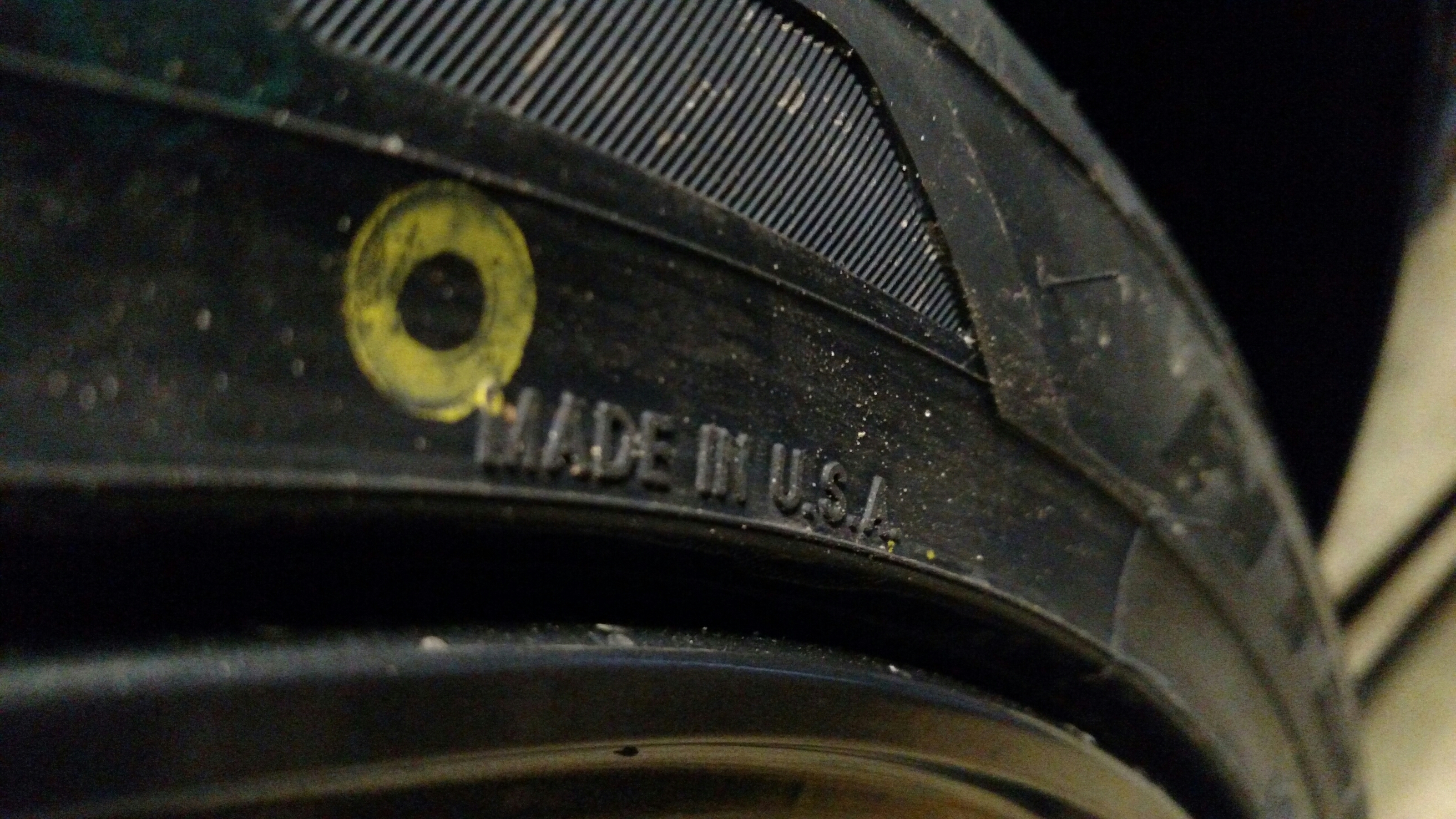

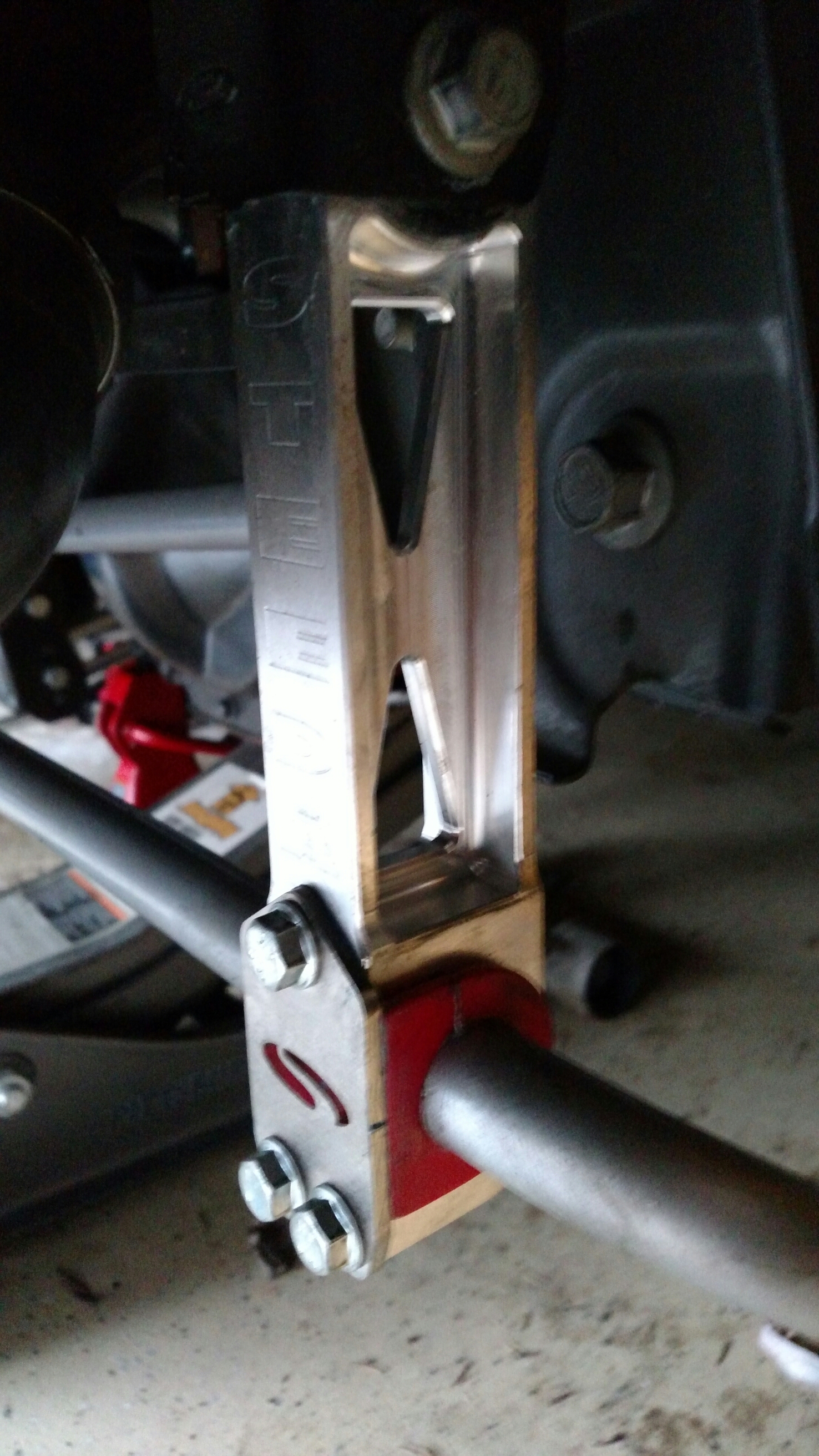

Steeda rear sway bar is on!!
Another thing I noticed, my tires say made in USA. I guess I just assumed everything was made overseas.

Got the front end pretty much finished up. Only thing I couldn't find was what to torque the front sway bar brackets to. Steeda never bothers to mention it in their instructions. I'll try to figure it out tomorrow.
I did notice when I turned the car around that it felt a lot firmer. Can't wait to take it out on the road soon!

Got everything bolted back together. Rear height is exactly the same as with the Steedas. Front is a half inch higher. Really hope they settle more.

Measured again this morning. All four corners at 28". I'll leave them in for a week, and if its still the same or not any better than the Steeda Sports, I'll try something else.

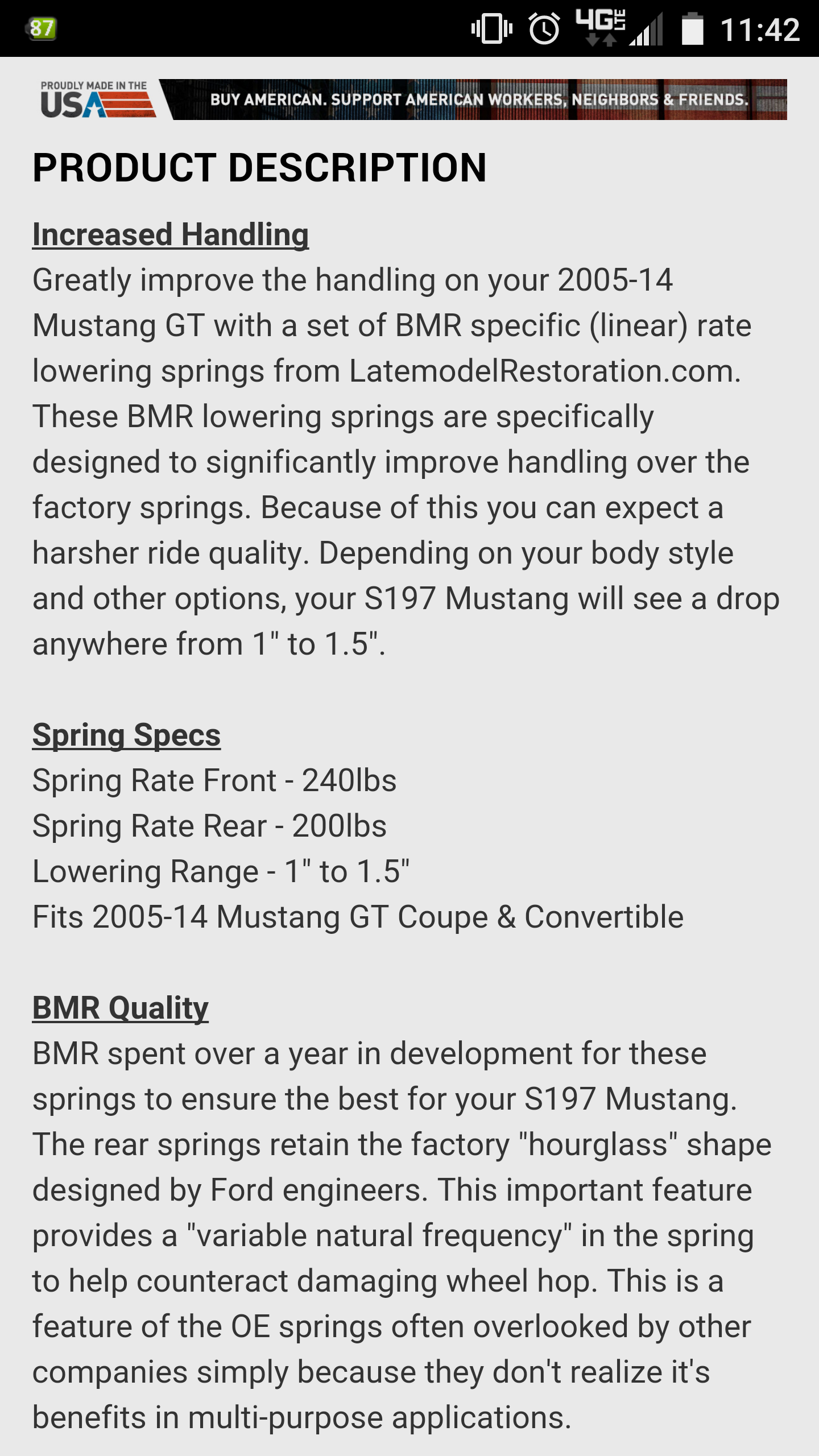

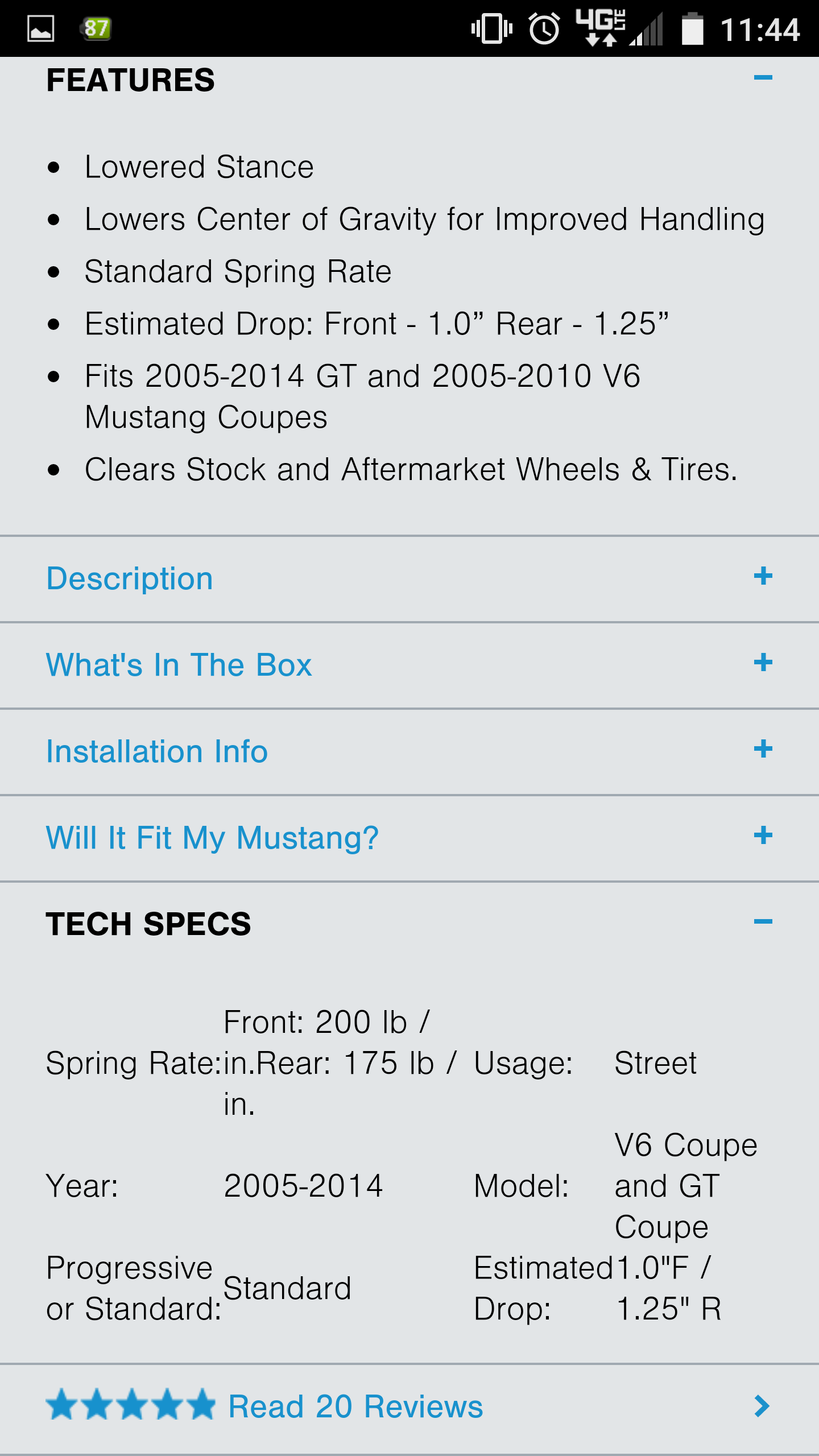

Ya, I'm hoping to take it out this week! Need to get an alignment done so I don't wear out my new tires, but I need to get these springs figured out first. I should've just got coilovers and left it at that.
Originally Posted by ford20
At the very least, they should ride a bit nicer than the Steeda springs.
The BMRs are actually a bit stiffer than the Steeda Sports.
