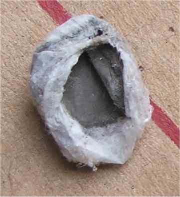

I found a spider egg sac in the fresh air intake for my evap solenoid. This caused a P1450 DTC, and a "whoosh" sound whenever I opened the gas cap... on a 03 E-250.
Someone else found that debris clogged into their S197s evap solenoid caused this slow to fill issue as well.
You can take apart the evap system and look for the air filter. The spider egg sac is usually found in the hose upstream of the filter.
Someone had a write up on how to clean their S197's hose. I have the link at home.

The dreaded spider egg sac:
