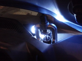

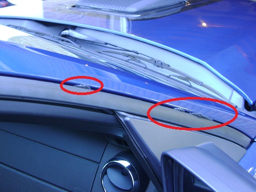

the two farthest towards passenger side had the 'gaskets' where you could see the holes- stretched kinda wide across the center... anyways, popped the wiper arms off- man were they stuck...didnt want to pull my hood for clearance, found my old imperial eastman tube flaring tool fit well like a gear puller, but tee handle hit the hood- took it apart, used a pin thru the hole as a handle, got them to pop with the hood still on the car(ive got a 'glass hood- thicker than standard, not a lot of room for a puller) and pulled the drivers side cowl cover off too...10 inserts total, all were loose, surely ANY/ALL of them would drip if water ran over them...stupid design for certain.
I used 'automotive goop' adhesive, removed the useless crushed foam, glued them in permanently- 'goop' is kinda neat in that it dries clear and stays flexible- holds tight as heck and dries within a hour.
was glad to see that 2 yrs later, even with all our pine needles plugging everything else, pulling the cowl drains worked great- spotlessly clean on both sides, save a little dust and a maple seed had reached up in a couple times a year from the bottom of the open cowl, always felt clean, but looking in, it was truly spotless inside

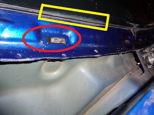

another age related issue popped up too- windshield is failing... my old dodge and Ford pickups both had this same issue that eventually ruined the glass... the edge seailing is inadequate, moisture starts degrading the adhesive between glass layers- my other cars went from a little foggy edge to 3" of white around the perimeter in 2-3 years...I dont know if it might help, but I smeared a bead of 'goop' around the underside edge of the glass, hoping to head off progression of the glass deterioration... only time will tell.

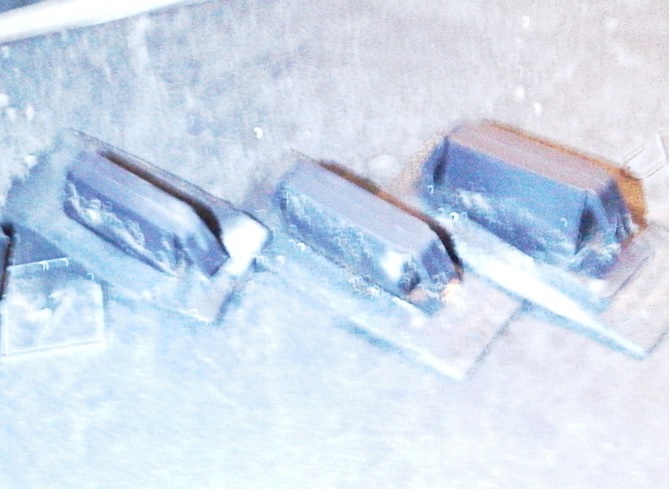

heres a pic of the plastic inserts for those that havent seen them- these WILL be a problem on every mustang as they age, suggest everyone think about adding them to the to-do list...plus pulling the wiper arms gives opportunity to give them a coat of paint- as the cars are up to a decade old, most of them might be needing some touchup
the insert obviously in red circle- there are ten pcs total, and the yellow boxed area is the glass delamination/fogging issue... the cowl covers hide a couple inches, if it stops here its no big deal... there were two areas like this towards center, and a worse area on one bottom corner, hard to get a pic of that as its kinda under the hood corner.

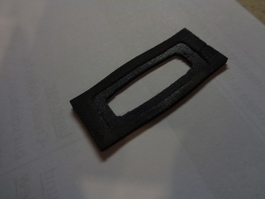

added another pic of one of the old gaskets- as you can see the center is bowed outward a bit...think just age/expansion-contraction of the plastic cowl cover scrubbing them back and forth deteriorates them...

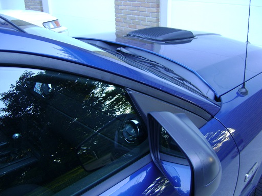

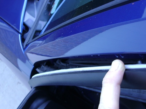

while I'm sharing leak pics, heres some from 2011 of my window molding issue- first pic shows seal bulged out, both sides were like this, both were pouring water in at the carwash... popped them off, replaced with some single sided,closed cell weatherstrip from the hardware store, still holding 5 yrs later, and not bulging out like Ford's material did...
you cant see the new weatherstrip at all, but its important
