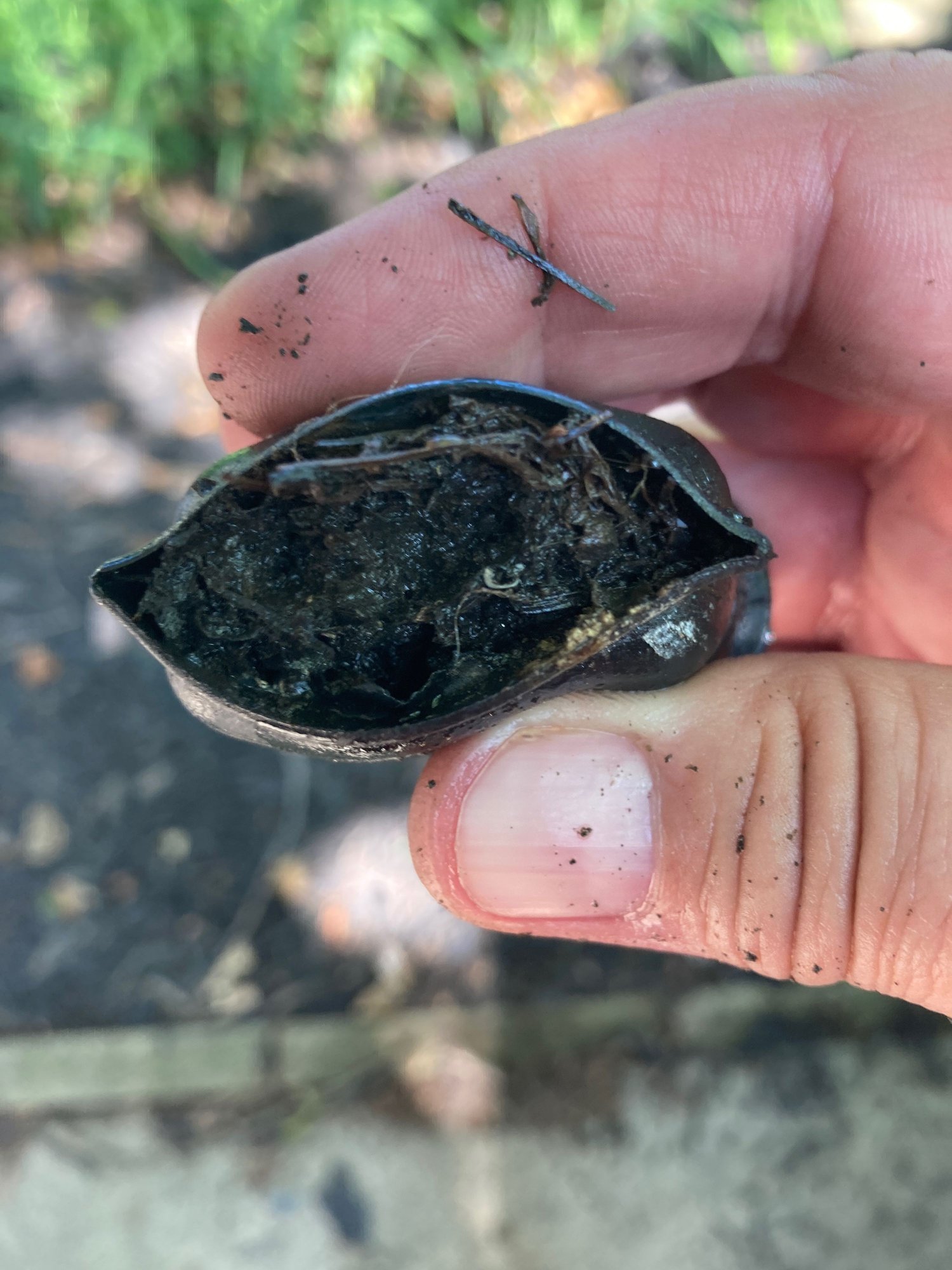

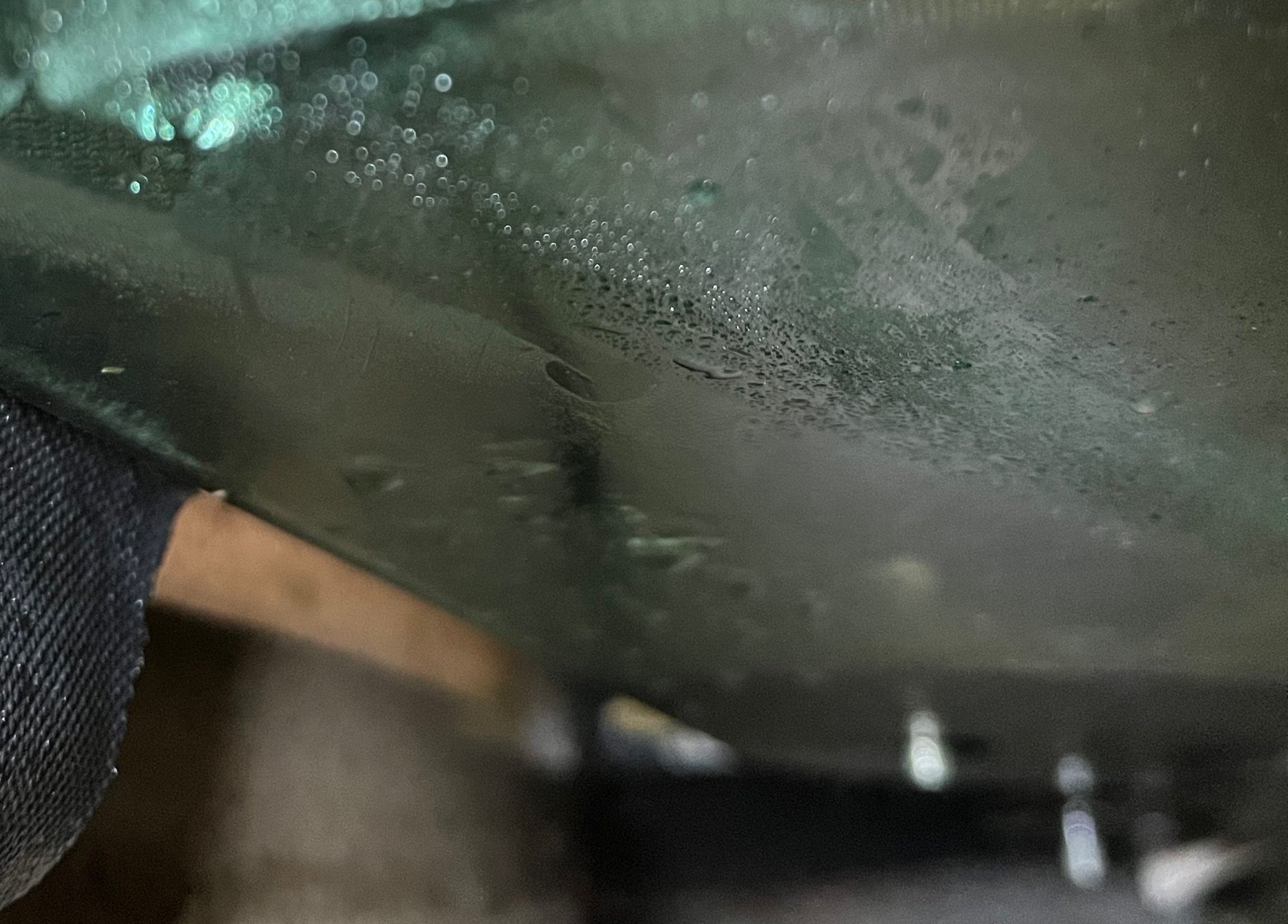

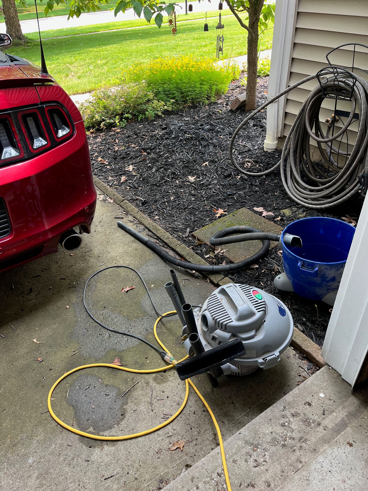

Hey all, since I got my 14 the right rear quarter kept filling with water. I took the 1-¼" shop vac hose to it and got some loose debris from both sides fortunately the left doesn't have that issue. So after hard rains the past 2 days it filled again. So sucked out existing water. Then put my garden hose in on jet setting. filled it with a 1-½ gallons of water and when I looked in the water was brown so knew I stirred up some gunk the vac water was really brown. Did 2nd suction and water was more clear also noticed the water was really starting to drain under the rocker. Did a 3rd & 4th shot with hose and it just drain right out with no issue. Here's some pics if that helps you including the drivers side cowl drain I did 2 weeks ago which was plugged with debris! I found a youtube video where you can just pull that out from engine bay and clean out and reinsert.

I did find a couple of the threads but didn't recall anyone trying the garden house to loosen the debris up thats why i wanted to share.
