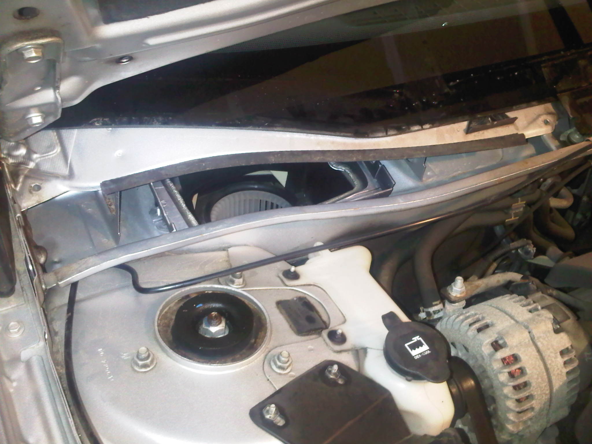

Attached are 2 photos.
First is the area where you can see the blower motor and cabin air filter removed. The rubber strip above it is supposed to seal it and divert water around the box.
Second is the plenum water diverter installed. It completely covers that area and funnels water directly into the drain.
10 bucks to fix this
