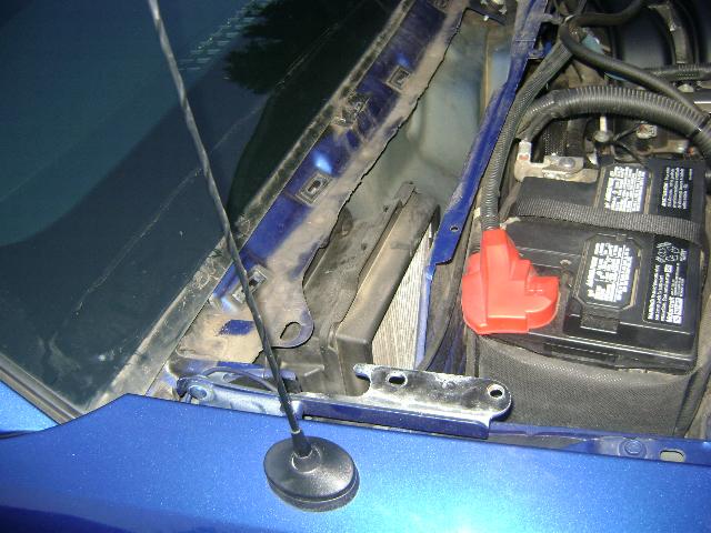

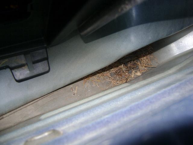

I couldnt see the pics in the original post, but took some when I painted my hood and could easily see down in there, in case anyone hasnt seen the cabin filter area yet:
Attached Thumbnails Fixed my interior water leak!  No more wet floorboards!!!-cabin1.jpg   Fixed my interior water leak!  No more wet floorboards!!!-cabin2.jpg
