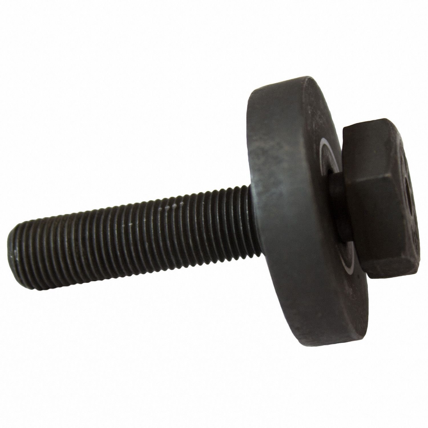

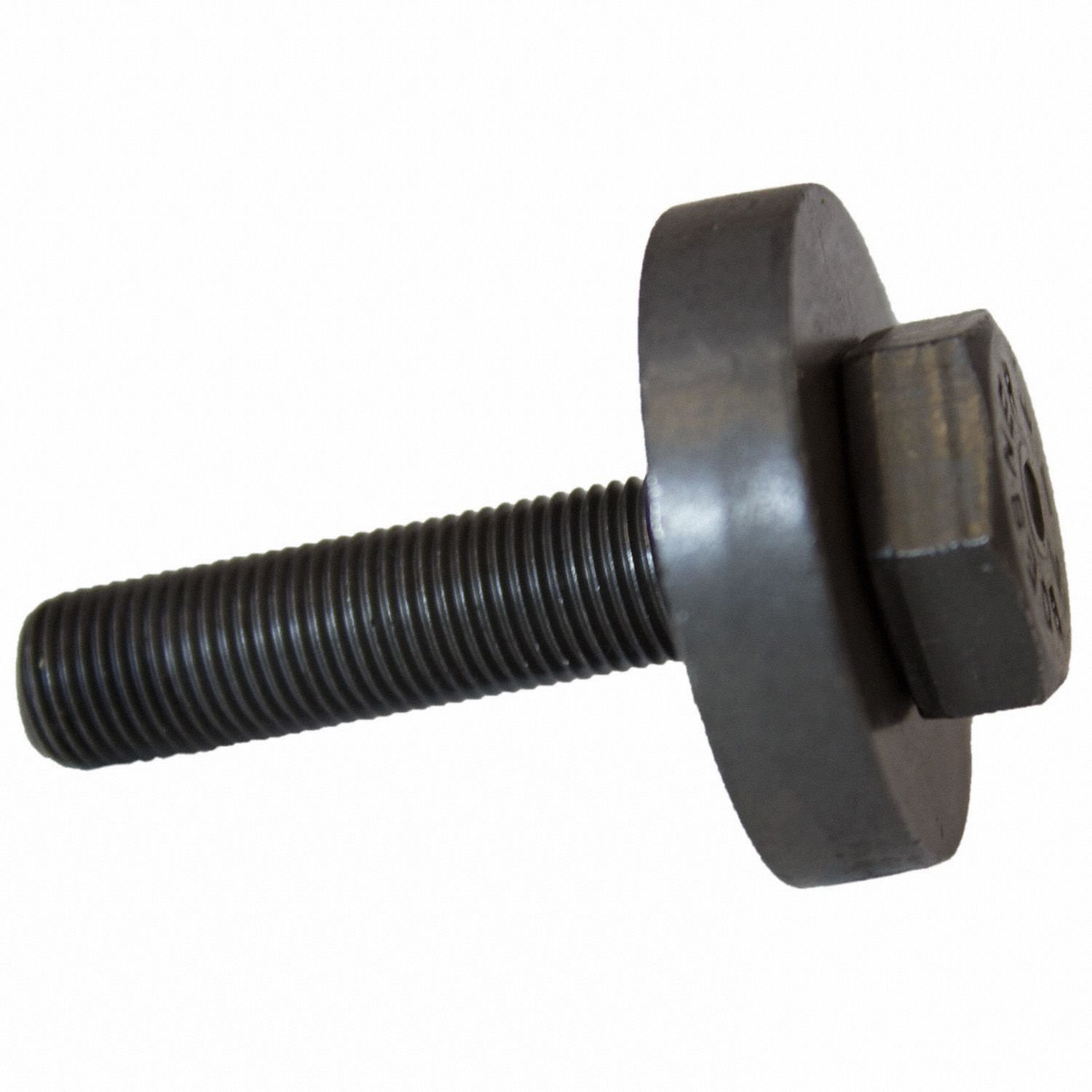

cAM bOLTS !!
Left Hand F77Z-6279-CB
https://www.fordpartsgiant.com/parts...z-6279-cb.html
Right Hand F77Z-6279-AD
https://www.fordpartsgiant.com/parts...z-6279-ad.html
