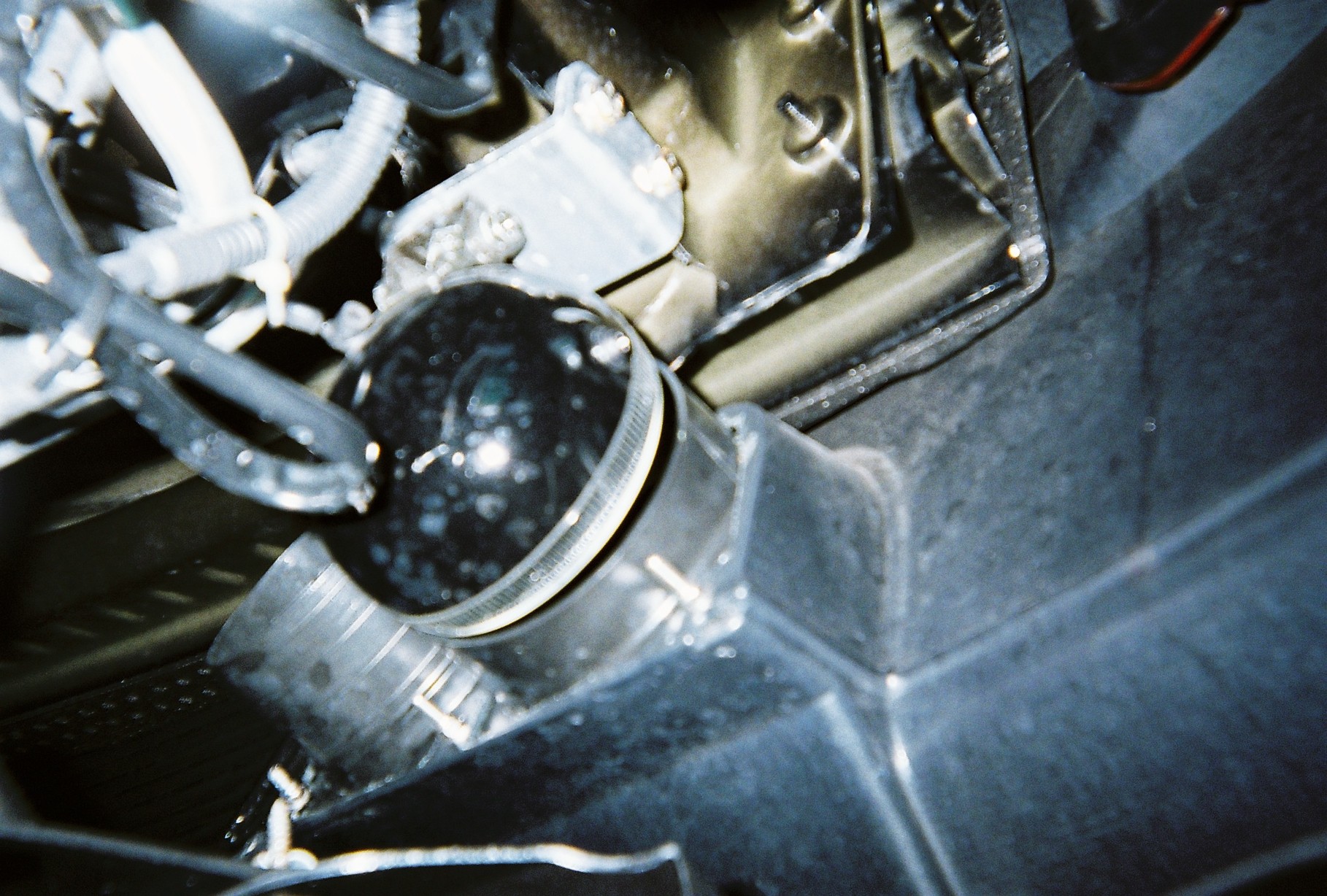

Been a white but I've been busy. I haven't really taken any pics but here is one...
You can clearly see the ducting(which is quite large) along with the new plates. This was pretty easy, short of Shelby's instructions regarding the length to cut the ducts and placement. They were rubbing at full lock which was mostly avoided, however we did cut the ducts about 5" longer than Shelby's recommendation, so if the directions were followed to the T then the rub issue would be much worse. Either way, it all worked out nicely.
Also replaced my brakes. Went down from the Hawk HP+ to the HPS. I was sad to see the stopping power go(HUGE difference), but I'm also happy to not have squeely brakes and a crap load of brake dust every day.
