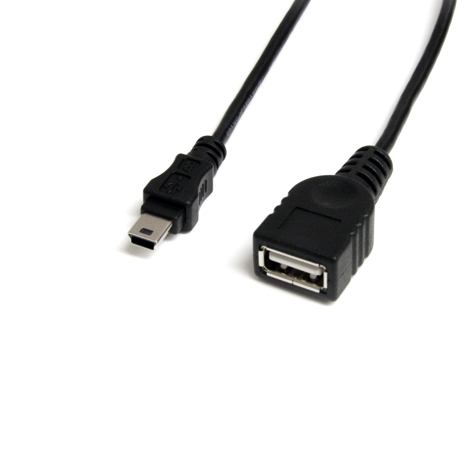

Where, exactly, is the second USB port under the dash on the sync module and is there one on the 2014?

Originally Posted by tukatz
I use a thumb drive and it works great. I learned about music file tags and cleaned mine up so I can select album or track or genre or artist with voice commands. I produced a document on this process and have sent it to a number of members on this forum.
I believe it's behind the glove box

I looked as best I could with a mirror and flashlight, but had no luck finding it. I did see something that has a label that says Scrap if Dropped and assumed that might be the Sync module, but I could not feel anything like a USB port.
You need one of these:
http://www.amazon.com/gp/product/B004ZMYEMY/ref=oh_details_o04_s00_i00?ie=UTF8&psc=1 http://www.amazon.com/gp/product/B004ZMYEMY/ref=oh_details_o04_s00_i00?ie=UTF8&psc=1

Ahah!!! So the second USB port is a MINI USB port, similar to the cable connection on some smart phones. If I see this correctly, the male mini USB plug goes into the secondary port in the car and the thumb drive plugs into the female standard size USB port on the other end of the cable.
Correct.
