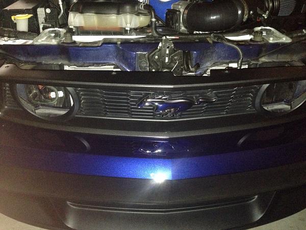

I will call them. It sounds like I will "have" to go with the HE mod anyways. My front end looks like this now since I shipped my fogs to be retrofitted yesterday. (Details as to how/why in my other "My Latest etc." thread)
I'm sure it's nothing to extreme. Good luck with the fogs!
Let's see how VMP responds with a phone call today. I heard they're not too "customer service focused". If it involves cutting my new valence, I will have to rethink.
