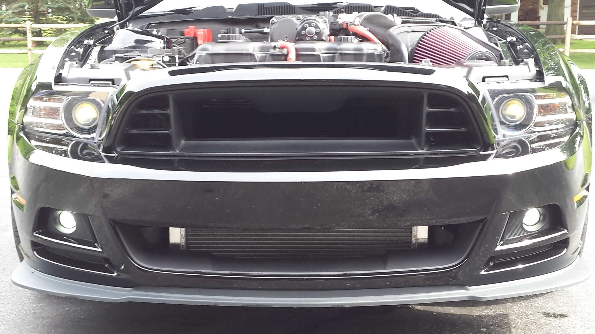

John... point #1 is a no go for me. I did not know that the AC has to be on for this to work. After thinking about it and reading about it, duh, yes, because it relies on refrigerant, same as AC, so it has to be on. The reason why its a no go, is because I don't drive with my AC (or stereo for that matter). It's windows down all the time so I can hear my maggie, cai, and corsas. Having an AC on during that would not jive. (plus mileage loss! )
Originally Posted by swervo
Thanks sir. I'm not FI with this stang, but I did have a twin turbo'd mach 1 before my current stang. I got the Saleen because it looks great and because I hate the fog lights in the center. I know it's the iconic mustang look, but that just doesnt do it for me. Plus I have fogs in my Roush bumper.
I'm not sure if the grille helps with cooling it down, but it might as there is more airflow with out the fogs in the way. I know the HE will be more beneficial for the performance aspect of the two. However the Saleen is much cheaper. So it's up to you, looks/cheaper or performance/more expensive.
I agree Dewayne. HE probably better benefit, but cost is more. So that could be a winter project. My wife is looking for a birthday gift for me anyways.

Thanks Nathan! That's part of why I love the stock fogs. It's distinct, plus I have my VLEDs 6000k in there and they're a nice pairing with the VLED triton amber switchbacks I have too. So I run the parking lights and fogs on during the day for that sinister look
To increase cooling while keeping the fogs, the option to go with is the VMP/Steeda HE then eh?

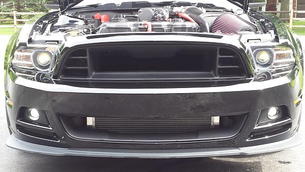

I am running CDC upper and roush lower delete with dual fan triple pass VMP HE . In 90* heat and sitting in traffic for 15 min, I see inlet temps up to 140*. Once I start moving, inlet temps drop and stay in low 130's.
Old Aug 21, 2014 | 03:49 PM
Likes: 173
hmmmm that still seems high even with an open grill and VMP HE. Is 140/130 good or bad? I would have thought you'd be closer to ambient. Is it normal to be that high?
