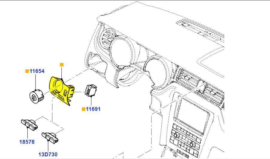

Basically the part below highlighted in yellow. Part of the headlight/foglight and interior illumination control that also houses the switches for the Driver Message Center. It's on the driver's side underneath the fan vent closest to the speedometer. I played around with it and got it working somewhat last night but the RESET button is kind of sticking. I'm hoping if I can find a way to remove it (if simple enough) I can remove the switch and fix the sticking. If not, hoping it's simple enough to replace the switch with a new one. Ford parts has it for sale for $45 so not too bad. Just want to skip the $200 in labor, lol.
Edit: In the diagram the part I may need to replace is 18578. I'm guessing in later models they moved the switches that house the hazards, trunk release and traction control (13D730) to that area since Ford parts lists that switch for that location as well.

Here ya go:
https://iihs.net/fsm/?d=991&f=Messag...Switch.pdf&p=2
The section it refers to for the steering wheel opening panel is here:
https://iihs.net/fsm/?d=1081&f=Instr...20View.pdf&p=3
So it looks to be two screws to get the lower panel loose, then pull it out of the clips. Set aside.
Then it looks to be one screw holding the headlamp switch assembly in, then pull out of clips too.
Then the message center switch can be replaced, it's just clipped in.
Reverse all that and you're done.
Hope that helps!
