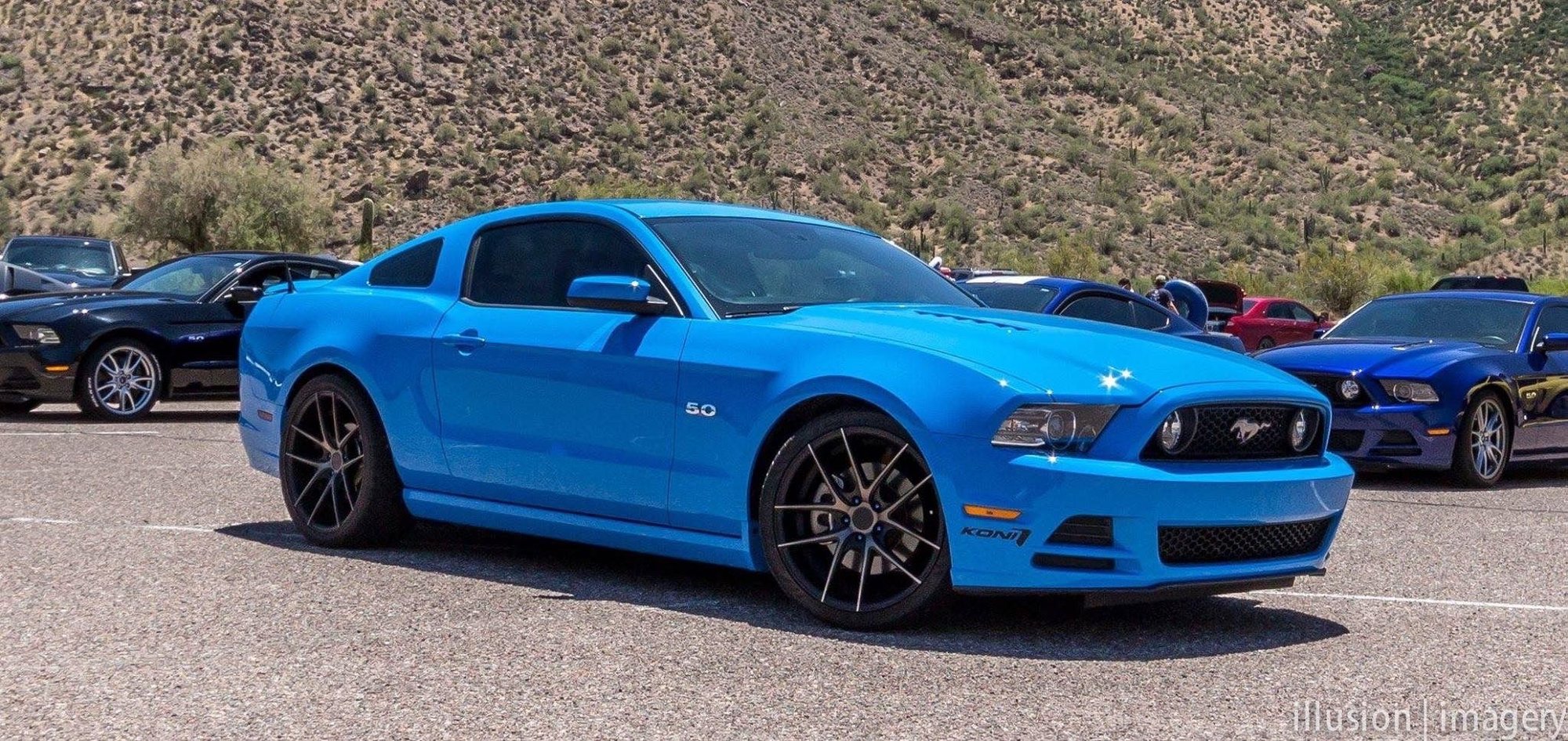

Hey Everyone, loving my setup since then my girl has matured But here is a quick question i am running used ( front tires ) that came off a friend who sold his 14 for a 15 and i got a heck of deal for Niche Targas wrapped with T1R Toyos in the back and some cheap HANKHANG tires NS-20s he did have slight camber issue on his 14 since he did not run anything but the springs. I am seeing now my tires on the front only being used up a little more on the inside. When i got my alignment done by ford it was all within spec. I used your advice to point the GT500 mount arrows towards the engine, and did not exibit this behavior on my original 19" Brembo tires. Should i get my alignment checked or it because of the tires? Does the Alignment have a warranty? thank you for your help.

so i just went trough my tires... Still got a lot of tread on the outside, none inside. I am running GT500 mounts with arrows point towards engine, i got 20" rims ( only thing that has changed after the alignment ) and Koni Sport + FRPP K / SR similar spec springs. Ford performed the alignment on 4/1/15 - any way i can get it re-done or claim tires? I have a sheet that it was all within spec. Any suggestions?

Do you think it's camber or toe? I think it might be toe out too far.
A lot of people mount the GT500 mounts with arrows pointing out to get more negative camber, but don't think that's your issues... or?
