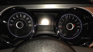

Gauges just started doing this yesterday.
When starting they peg on the low side and bounce for a few seconds.
I'm taking it in next week. Luckly it's still in warranty for another few months. Any ideas on what is causing this?
Battery?
Alternator?
Click on the pic to go to the vid of the issue.

It was the battery.
Went to start it last night and it was totally dead.
Replaced the battery last night and it fired right up, but was showing the driver's door ajar (door was closed), steady check engine light and the miles to empty still read over 350 (way too much)
Started this morning and no door/CEL indicators, but miles to empty still read over 350.
Brought it to dealer today to get the electrical system checked and was told:

So my car JUST started doing this. Yesterday I flipped the key and it started but would bounce the needles to the far left for a second or two until going to normal. It also turns on my little info screen (not LCD screen, '12).
ALSO though, My driver side window wouldn't come back up after I shut the door unless I manually pressed the button. It goes down when I open but not up. Eventually it works properly but then the automatic up button doesn't work. Now I have to hold it to go up.

My issues was caused by a bad battery.
New battery solved all the problems.
