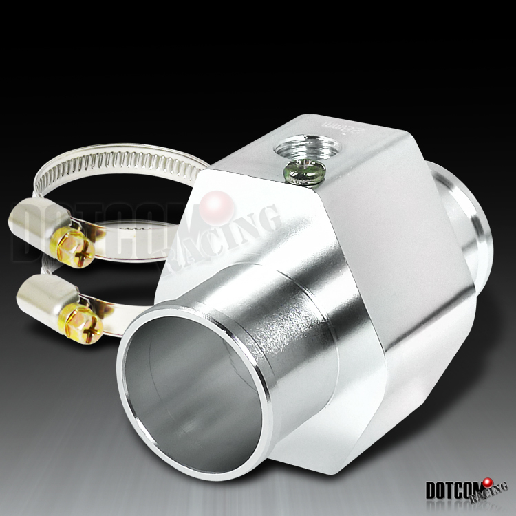

Can't answer the OP's actual question, but I've seen an aluminum adaptor that is attached inline with the upper radiator hose that has a threaded hole that fits a sensor for most temp guages. Then you'd have a true temp guage. Buy the guage holder that fits in the AC vent made by Roush (vent is still functional).

Take all the guess work out by adding this to your radiator hose: (has the ground screw for sensor too). Now just add a gauge pod or gauge holder in the left AC vent from Roush, and no more guess work on what the temp is.
