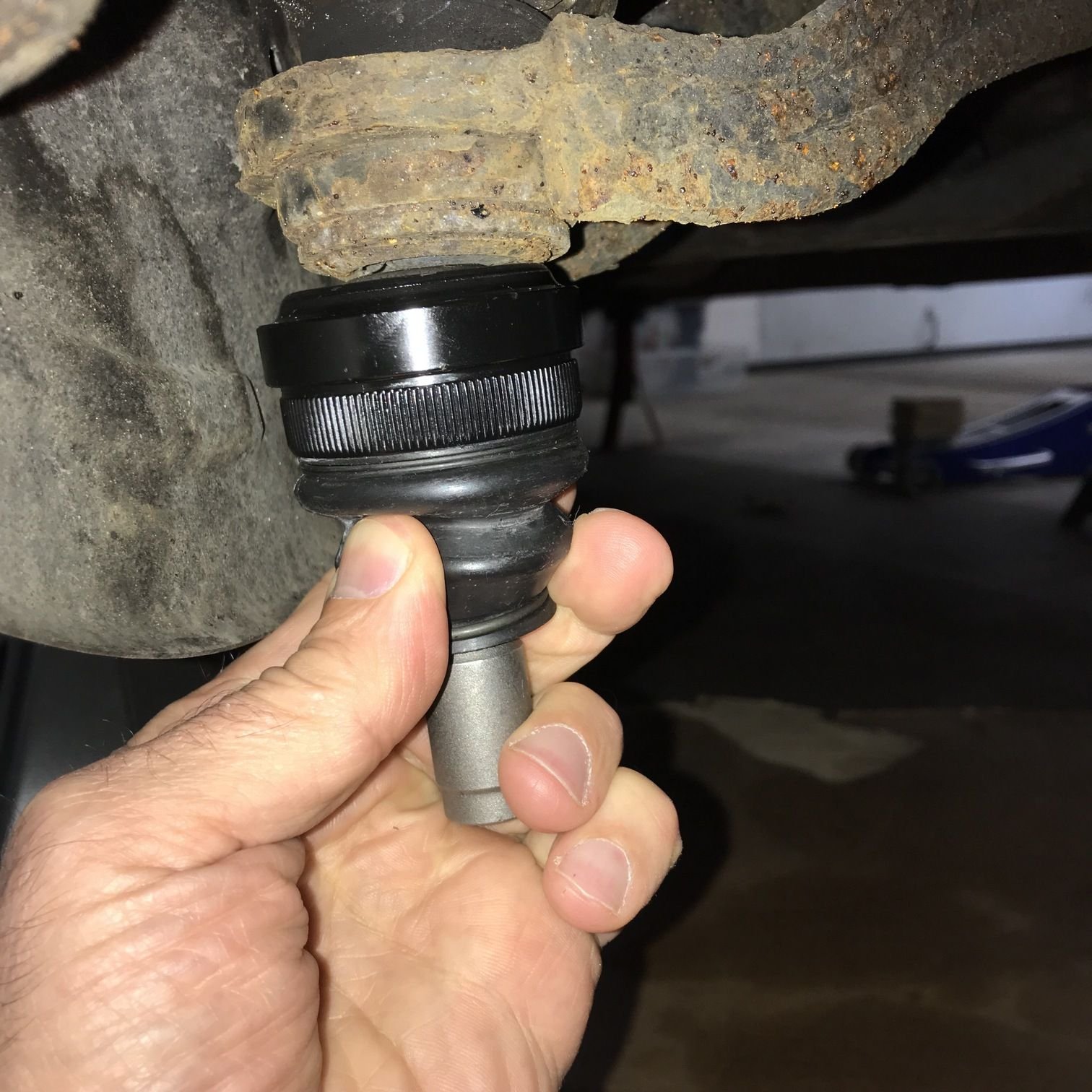

I purchased Proforged ball joints for my 2010 GT, and when I tried to install them, I found that they are too big to fit in the hole in the a-arm. I couldn't believe my eyes and figured it must be my mistake somehow, but checking it several ways I find that they are indeed too big. Pics attached.
The part number is 101-10011, and I double-checked Proforged web site and it lists the same part. (I bought them from Rock Auto)
Does anyone know what is the story behind this; and how do I make sure I reorder the right ball joints?
thanks in advance

update -- I think this might be a "red headed step-child" problem with my 2010 . . . . I think the ball joints were upsized in 2011, and the ones I got are for the 2011+ cars; for my 2010 I need the 2005-2009 ball joint . . . does that make sense; is anyone else familiar with that?
When I had my 2010 it seems like the only thing that transferred to the 11+ was the Body so you might be correct.
On a side note the Moog # for the 2010-14 K500313 and the 2009 is #K500033 and going by the pics on Advance auto's web site the 09 does look smaller.

hmmmm . . . makes me wonder if they changed the ball joints during the 2010 model year and maybe I got one of the earlier ones with the older/smaller ball joints
That is what I was thinking, I even looked at the upper and it is a threaded shaft, not smooth shaft like the ones you have.
I was looking around online to see if anyone had the actual size and could not find it.
Was your car built before 8/2/09 by chance. Don't know if the difference was the ball joint, actual control arm or the control arm bushings but I got a different part number when I looked up the lower control arm.
FITMENT DETAILS
2009 Ford Mustang GT (4.6L 281CI V8 FI VIN: H)
  • Front Left Lower; R-Series
2010 Ford Mustang GT (4.6L 281CI V8 FI VIN: H)
  • Front Left Lower; R-Series; Thru 8/2/09
Old Jun 1, 2019 | 06:07 AM

BTW CJ's has the Steeda Lowered ball joints listed for the 2005-10 for the X5's and 2011-14 for the X11's.
They also have the Pro Forged 101-10011 listed for your car, the 2005-09 is 101-10009.

. . Was your car built before 8/2/09 by chance. . . . I got a different part number when I looked up the lower control arm.
FITMENT DETAILS
Yep, I am 99% sure that is the explanation -- my car was an early 2010 build, before the change to the 2011+ ball joint and a-arm
I think ProForged is the source of the incorrect listing; meaning they did not distinguish between the early and late 2010 cars and they have only the later fitment listed. I e-mailed then and I did get a response "we are not sure what is going on" so apparently they are not aware of the difference either.

To close the loop on this: yes, there are two ball joints for the 2010 model year; Rock Auto and most others have the wrong ones listed for my car.
The early build 2010's had the same a-arms and ball joints as the 09's ; part way through the year they changed the a-arms and ball joints to be the same as the 2011 model year. I don't remember the date but I think it is posted on here somewhere.
Here is a picture of the old ball joint, the correct (smaller) new ball joint, and the later version of the ball joint.
