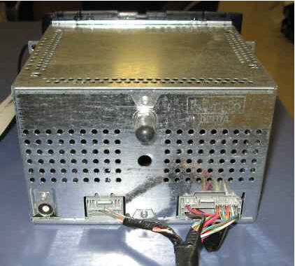

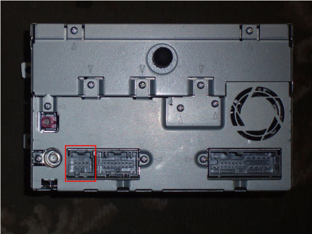

Hey guys, I'd like to install an OEM Navigation radio in my 07, but I don't have this third plug on the left. What's this plug for? Is it for the sub woofer on the Shaker systems? Has anyone installed the navigation radio in place of the base CD radio. Here's a photo of the back of my stock radio. Note I don't have the third plug. Thanks for your help.

Interesting. I had a stock radio and upgraded, but I did have the 3rd plug. My radio was a shaker 500.

Are you replacing a Shaker 500? The nav is compatible with the Shaker 500. Also, once installed, you'll have to have the dealer re-program the radio. It's a little more than just plug and play. I upgraded the system in my FX4, which is simialr, and the third plug was for the sub... Perform a search and you'll find a lot of material on the subject.

I believe thst is right...that 3rd plug is for the subs. You can try and see if everything works OK without that, but I do recall the Nav option from Ford saying "Shaker 500 required". I also recall from when I put mine in that there was a programming question about whether the car had subs, so I suspect you can run it as a direct replacement for the stock radio if it is programmed OK.

Thanks guys. I have the base radio, not the Shaker 500. Hopefully it will work without the sub woofer.

The plug you have in question controls the power to the subs on the shaker 500 and 1000.

The plug is for the subs, and yes it will work just fine . in some 05-07 you will get a error window on the screen just press ok and everything works great. Depending on the car that is out off you will need to program the stereo ,but test it first many time it will work just fine. I have done over 40 installs on mustangs and Im testing the new 2010 hard drive on my 05 mustang.working great.
