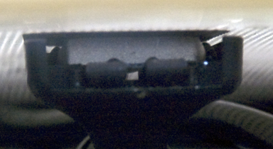

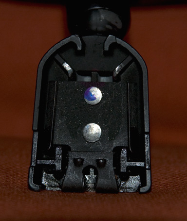

Here is the back of the stock mirror. Note the protrusion in the center. The flat bladed screwdriver MUST be applied against that protrusion GENTLY in order to release the tab.
BE CAREFUL!!!

The screwdriver method works for the base mirror. But the bracket for the factory electrochromatic mirror is a lot different. I found no way to push the leaf spring, it is very strong. So I called in a pro, who broke my windshield. I think the two-pronged tool that is available online might do the trick.
