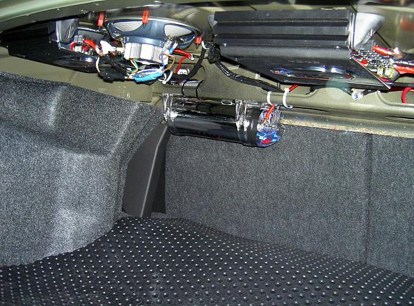

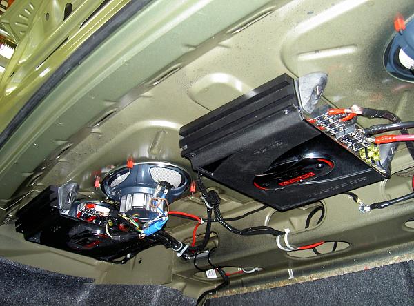

Here's a picture of mine - two MTX amps - 282 (80w x 2) for the door subs and a 421D (210w x 1) for the trunk 12". I've had no issues with cooling in the 18 months they've been in the car. I bolted mine in as I don't think screws from underneath would be sufficient. The amps under there take no usable space fro the trunk and allow me to still get 2 sets of golf clubs, and a couple of small bags in without folding the rear seats. both amps are about 10" x 12"; in the center I think 12" x 15" or so would fit. You could also get a third 11" x 12" on the left side if needed. I added a 2.0 Cap in April for the 421D, that was clipping a little when using it with the car off - it is shown in the second picture. All of my modifications are stealthy.

I would just add, that if you are going to put an amp in for the door subs, you might change them out for something much better. The factory amps do a good job driving the crap Ford put in there - changing the door subs makes a big difference, but as there are no dvc 2ohm subs that fit, once you do so an amp addition is necessary. I tapped into the speaker wires at the amp location under the kick panel and pulled the factory amps out (they are now in a box with all of the parts I've changed - maybe the next guy wants it 100% stock).
