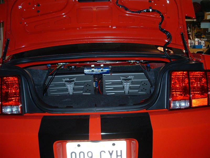

Old Jul 13, 2007 | 01:43 PM
hawgman's Avatar
Joined: March 30, 2005
Posts: 1,122
Mine are on the backs of the rear seats.
Attached Thumbnails How/where did you mount your amps?-picture-013-medium-.jpg
That's where my Aura's were, the new ones don't fit there It was quick, easy, and effective.
That looks nice man!
