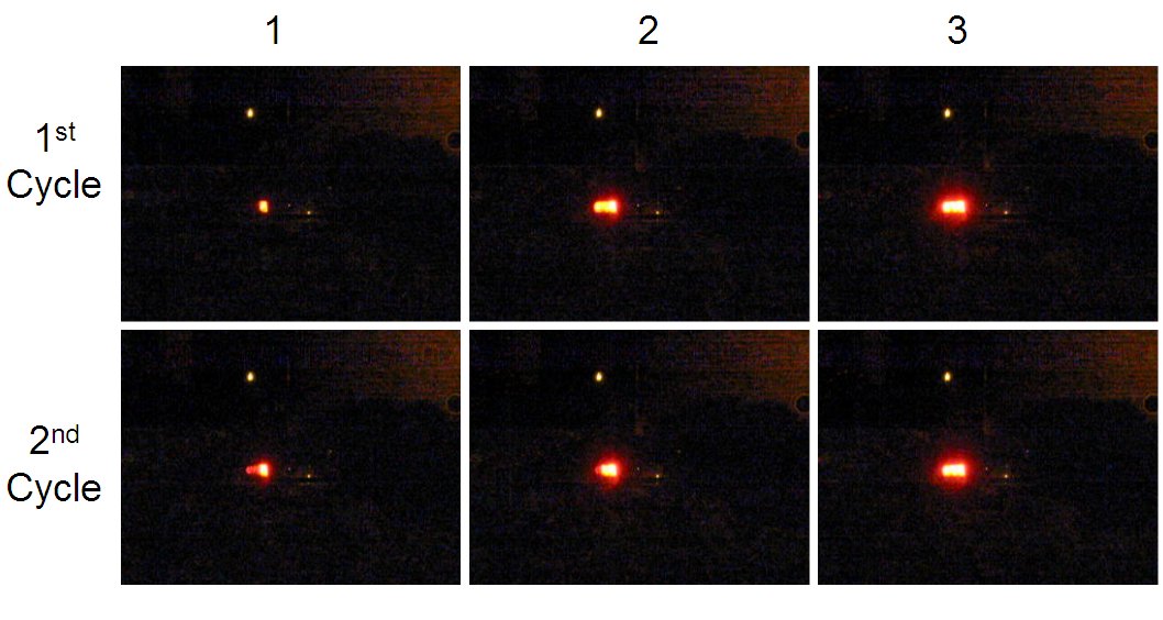

I installed mine back in June 2006 and from day one they did this on both sides but ONLY on the first cycle (light 1, then 2 and 3 at the same time on the first cycle. light 1, then 2, then 3 on every cycle after). I just thought that's the way they were but now I'm thinking that they're not supposed to do that either. Yours definetly shouldn't do it on every cycle like that.
I also remember seeing a video of someone else's car on here that did the same thing as mine (just on the first cycle). note: I also hooked up the extra wiring to stop the cycling for the brake lights.
What does eveyone elses' webelectricproducts lights do?

It's supposed to be the following sequence:
What's lit: inner, inner + middle, inner + middle + outside, inner, inner + middle, inner + middle + outside, and so on.
