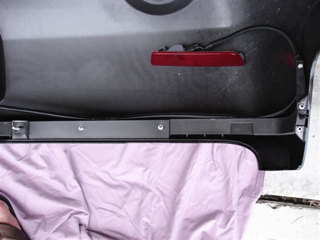

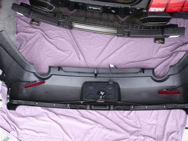

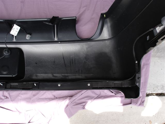

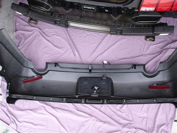

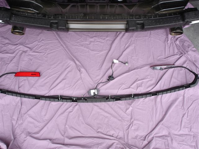

Pixs of inside rear bumper cover
Here are some pictures of the inside of my original rear bumper cover, showing the wiring assembly, which is secured by rivets, that had to be transferred over to my new cover. The original rivets are big, like 1/4", which I couldn't find, so I used 1/8" rivets with 2 rivet washers. After placing the rivet into the rivet gun, slide one washer on the rivet, so it rests against the flange of the rivet, then after you position the new rivet into place, just put another washer on the bottom of the rivet, and squeeze. Worked perfect!

Wiring assembly installed
Below is a shot of the wiring assembly installed on the new bumper cover. You can't see the two new rivets on the end, because there's some rubber insulation re-installed on top of them now,

....The original rivets are big, like 1/4", which I couldn't find....
Yeah, I wasn't prepared for this either. It came as a complete surprise. I ended up using 1/4x20 nuts and bolts instead of rivets on the larger holes -- four total.

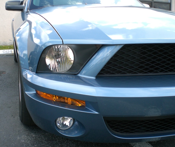

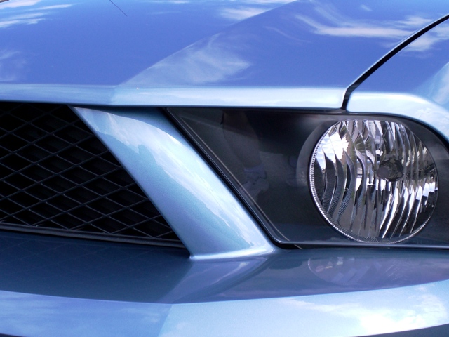

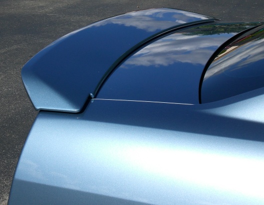

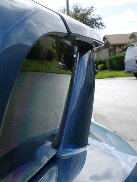

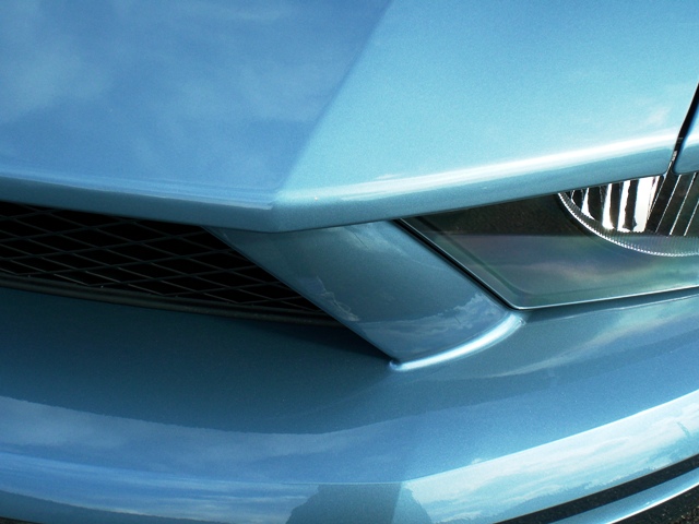

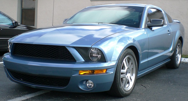

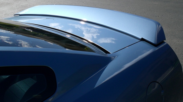

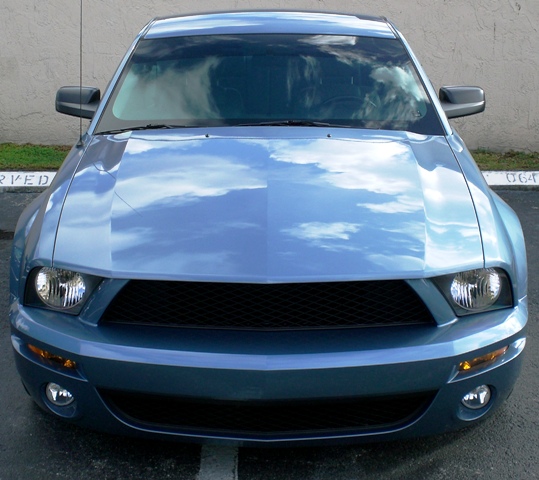

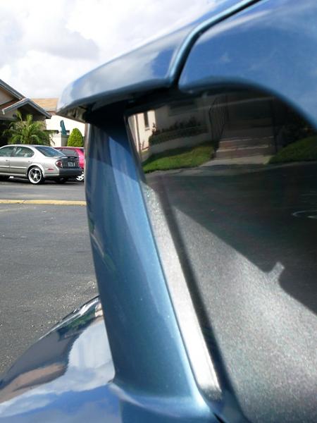

Am done for the weekend. Time to watch some good old Dolphins football and call it a weekend !!! Rear Bumper cover and hood going on next weekend - am soooo tired. Any ways here are the pictures. Am pleased with the results so
far. What do you guys / gals think?
Attached Thumbnails Next Shelby GT500 Conversion Coming Soon !!!-cimg1147.jpg   Next Shelby GT500 Conversion Coming Soon !!!-cimg1155.jpg   Next Shelby GT500 Conversion Coming Soon !!!-cimg1171.jpg   Next Shelby GT500 Conversion Coming Soon !!!-cimg1170.jpg   Next Shelby GT500 Conversion Coming Soon !!!-cimg1167.jpg

Sweet. I definitely like the look of the factory hood better than the GT500. It doesn't make the grill look so big. Are you putting the air dam on it? I wonder what one would look like painted instead of black.

That looks great i just did my california special bumper today was pretty easy.
