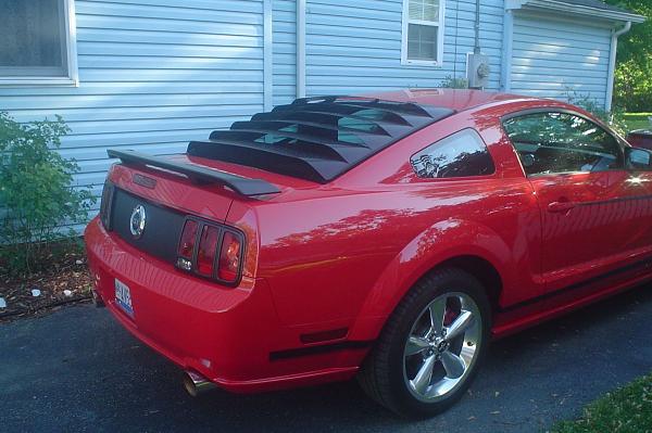

I bought a gloss black take-off for mine, pulled it off after about 6 Mo, sanded down with 400 grit & sprayed it with Krylon satin black last fall. Been through 1 winter & is my DD. Still looks good & has held up well. Even if I have to repaint it once a year or every 2 years, cost was about 5.00 + my labor.
No current pics of just the spoiler

pinstripe
Originally Posted by 2006stang
I went the rattle can route as well. Over a year now with no problems. Take your time and prep the spoiler properly before you paint and you will be fine. Dang Aircare great minds must think alike....
Agree
Nice job. Even the same pinstripe.I had at first a 1/8", it was too small, now have 1/4".
cntchds,
I didn't use any clear over mine.

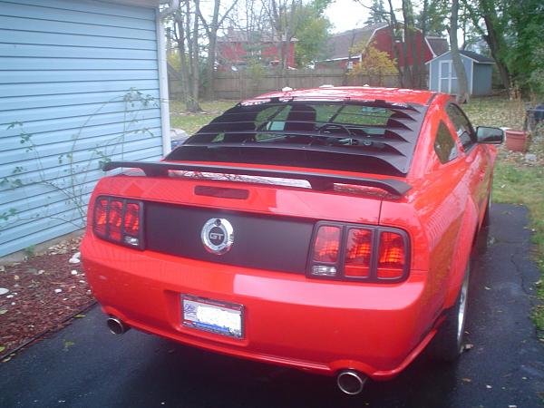

All I did was wipe the spoiler down with naphtha I got from Lowes. It is great on removing oils and waxes from painted surfaces without hurting the clearcoat. Rubbing alcohol works great too. Next I wiped it down with a tack cloth. Then I sprayed the semi gloss black directly onto the spoiler. No primer or sanding. Let it dry for 24 hrs. or so before installing it back onto the rear decklid. It has been almost two years and the paint looks like it did when I first painted it. I used semi gloss black instead of flat black because over time flat black will turn a charcoal/greyish color and the semi gloss also matched the Astra Hammond louver finish and the SHR blackout panel finish better too. I also used the same paint for the hood treatment and the piece just above the front spoiler. Good luck and post some pics when you get it done.
