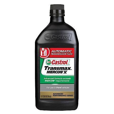

Changed 2006 V6 at 130,000 with Castrol Transmax Mercon V
Drained and filled with Castrol Transmax Mercon V (see pic below) in my 2006 V6 manual at 130,000 miles - still had original fluid. Did not like going into 1st or reverse. Also was getting harder to shift. Intention was to drive with this for a few miles to flush, then change to RP Synchromax. I was amazed at the difference just the Castrol made! Shifts like new again. Wondering if I should bother changing to RP that I already have anytime soon?

I second that changed mine out at 135k that castrol helped my noisey transmission alot . Our t5s hold 2.8 if i remember. I jacked the car up at autozone drained it for 1hour to be safe after leveling it. Grabed there cheap plastic pump an got my hands dirty. Manual i think says to use threadlock on plug but was tired of the horrible smell an spectators. My old fluid was dark dark brown. Pumped the clutch slowly for 10mins then got the hell out of dodge.

Would it be fine to use the Castrol Mercon V ATF in my MT82 Manual Transmission (2014 V6)? Thinking about changing mine, has 128k on the stock fluid. Just looking for the correct one to put in my transmission. Here is the bottle:
Also, I would be fine buying 3 quarts, correct? I believe capacity is just under that amount.

Well, this here's the '05-09 where we use the TR3650, so there's that.
But much like the TR3650, the MT82 has issues. And that fluid is not the stuff.
The correct call seems to be to pony up for the three quarts of Ford Dual Clutch Fluid and a bottle of XL-18 to go with it. Total volume is 2.7 quarts for that transmission, so you'll wanna short that by about that .91 ounces, or 2.6715625 quarts of DCF. That's what Ford's been putting in the things to get the shifting in all conditions to be better. Others have said Redline MTL or even straight 75W90 gear oil, which I find interesting. Also BG Synchroshift II, Amsoil mix of two of their products and others.... But you have to be careful because there's some plastic part in there that if you use the wrong fluid might help cause the thing to break, and they can't be replaced, or so I'm readin'. I think it was the Amsoil mix one...
Oh, and yeah, most of these things will work, but they won't shift right in the cold. So my take on all that after the readin' is this: Go get thee Ford products (the DCT fluid and the XL-18) and be done with it on this one, the MT-82 is just that kind of a weird transmission, and doing a non-Ford thing might lead ya somewhere you don't wanna go.
Hope that helps
