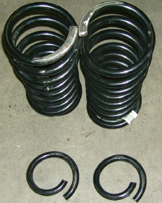

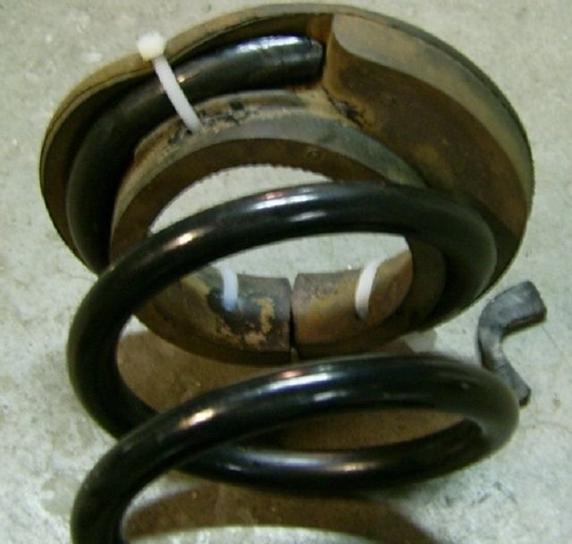

When I lowered our '08 GT by an inch some 8 years or so ago, and before lowering even, the rear passenger side tire was a little more out that the driver side. Not by much, and then I lowered the rear only 1-1/8". My intention was to drop it an inch. I got lucky with my cut choice. I cut exactly one full coil off the top plus the 1" width of my rule. I cut them on the top end in my shop with a cut off wheel in my angle grinderl tool, then I smoothed the cut edge and re-installed them. A few days later I found some old top spring rubbers off a '92 Thunderbird, the coils are bigger round but these spring rubbers had a built in ramp for that first coil that I liked. I installed them after trimming the ends for the smaller OD Mustang coils. I zip tied them to the coils for easy install. In use, they made no difference in height.
The day I cut the coils, In just eyeballed the rear for centering, it looked great. The day I added the rubbers, I placed a 4 foot long level across the spoiler top and found it was also level, I checked my carport floor and it was level under the rear bumper, so thjen I hung a short string with weight from each fender top at center and measured from the string to tire sidewall .... driver's side just a hair under 3/8" but over 5/16" (about 11/32"), passenger side right on 3/8" mark (12/32") and that's "pretty darn close" to being the same. I had decided if within 1/4",(requiring a 1/8" shift), I'd leave it alone. 1/32" is nearly perfect.
The panhard bar anchors to the frame on the right rear and to the axle on the left, it is at a slight angle stock. In lowering our GT that inch plus, it swung in a arc and actually put the axle dead center at rest.
I also did saw near an inch off the bump stops too.
