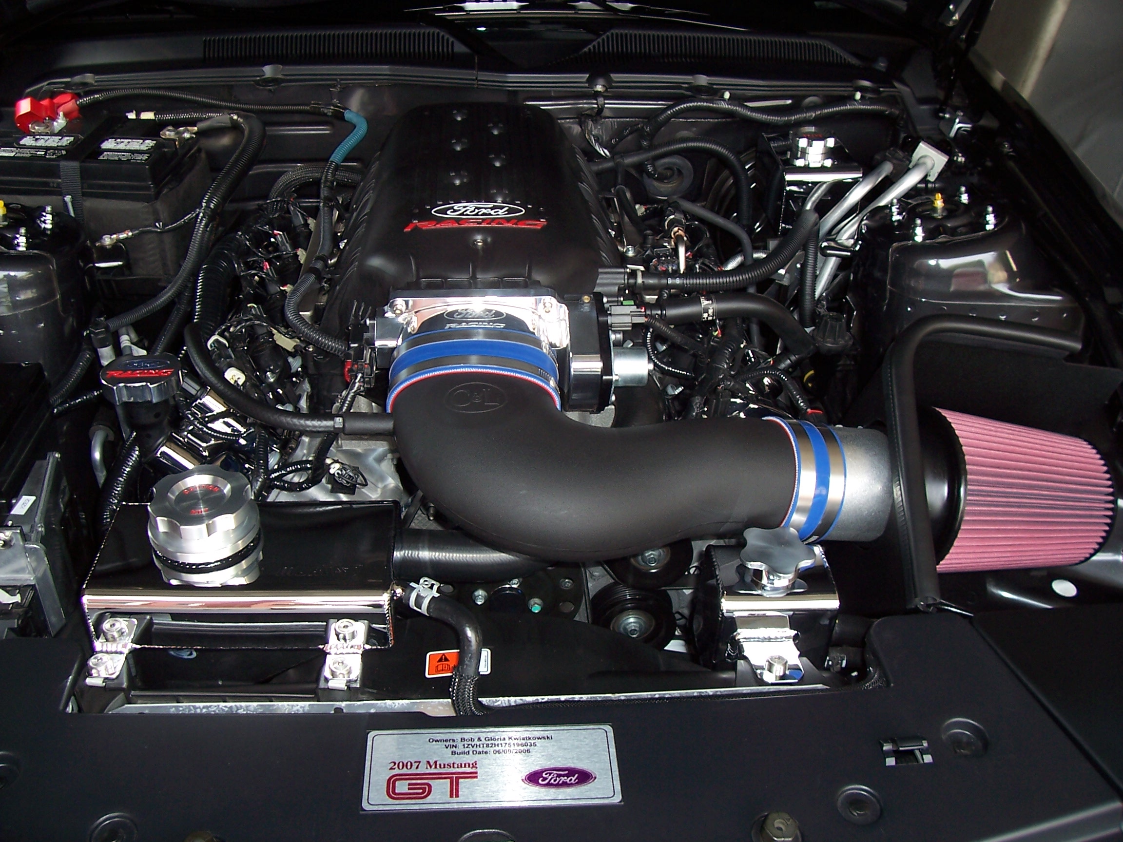

Gained approx. 20-25 H.P. with Steeda UDP's, C&L CAI and a dyno tune.
An additional 50 R.W.H.P. with FRPP Hot Rod cams, FRPP Throttle body, new FRPP 3V intake and Kooks LT's with a catted H Pipe.
I don't think it's easy or inexpensive to make NA power but I am very pleased with the results.
Also went from 3.73's to 4.10's probably the best mod, especially with the cams and intake.
