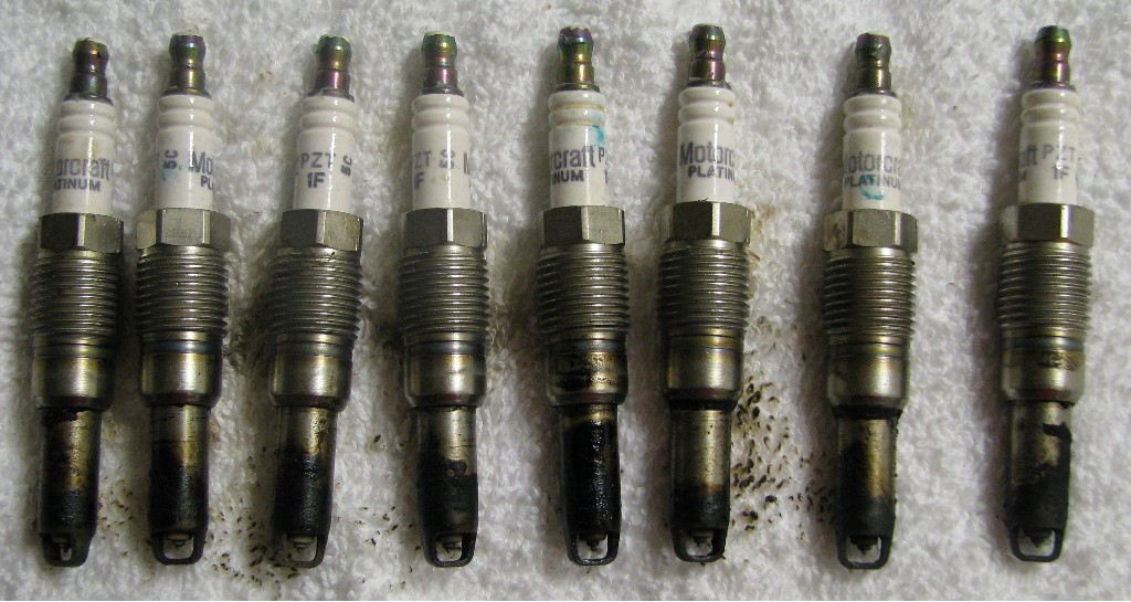

After an hour I just went to check them. 2 came out real easy, the rest were tight and squeaky. the 2 that I did pull out had the worst carbon buildup I have ever seen. It looks like the factory tech used feces as antiseize on it. I'll let the rest sit until the morning !!!

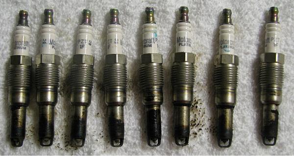

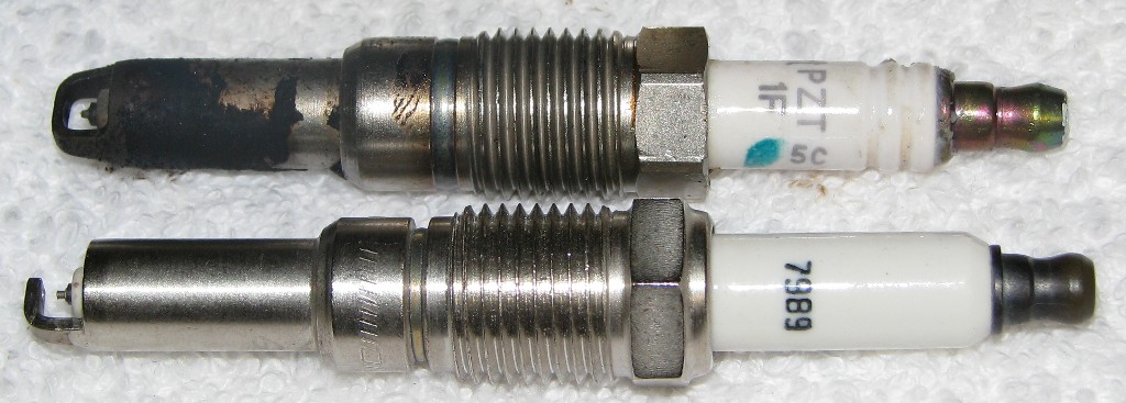

Done! They all came out after like 3 hours of soaking and working them out. Some went easier than others, just let the tighter ones soak longer They don't look that bad. I really could clean them, re-gap and put them back in. Other than the tons of carbon buildup they look fine.Not bad after 61k miles
I put the Champions in and put everything back together. In the morning I'll take a spin.
Oh yeah don't bother buying the special 3V socket tool if you already have a 9/16 spark plug socket. The Champion socket has a 5/8" hex, a different size. If you're permanently switching to the Champions you'll never use that tool again. Buy the one sized 5/8". I just used my Craftsman 5/8" spark plug socket and extension.
