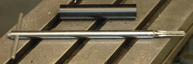

All systems go. I have the plugs, carb cleaner, vaccum caps, anti seize, spark plug tool and I even made myself by own broken plug removal tool. I just TIG welded a M9X1 tap into the end of a long .5" steel rod and put a tee bar on the top of it. Then I made a .950" diameter sleeve that's 5" long out of delrin (machinable plastic). I bored it .501" all the way through and bored out the bottom side .8" diameter X 2" deep. It should work fine. The sleeve goes inside the spark plug well and centers the tap
I got the plugs in from D'Agostino Racing, Derek is awesome
I'll start take offers on the extractor tool. I'll have no need for it after this.

about my tool, I don't think it is as good as the rotunda tool, but I think the cap can be tapped and wiggled out with my t-handle
